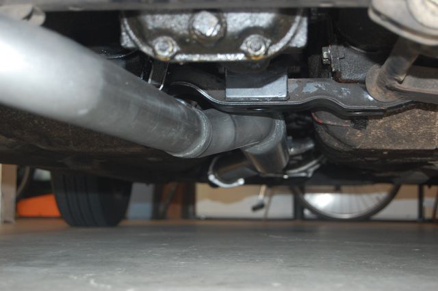

The car is at a local muffler shop as I type this, having an aluminized glass pack added. Due to the tight clearance, the center pipe is going to be re-routed down the center of the tunnel to ensure no rattles or interference. I'll report back after I pick it up later today.
Edited by Arne
Just picked the car up from the shop. The additional muffler in the middle was definitely the right thing to do. It might be a good idea with the Dynomax muffler supplied, but is pretty much essential with the small dual outlet Magnaflow.
The additional glass pack is 22" long. Quieted the car to a reasonable level for a sports car, nice sound but not too quiet or too loud. Took the harsh edge off the sound as the engine passes through 3000 RPM. The exhaust still has a much deeper tone than it did with the old 1 3/4" exhaust.
Anyway, I'm done. I would not do it this way again, but it's all good now. After all, it's only money. :cry:
