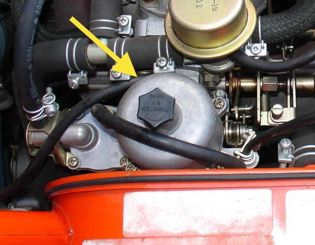

  Healey Z said:
Where does the disti draw it's vacuum from?
There should be a small barbed brass nipple on the front carb body. Looking down on the carb, it should be at about 10 or 11 o'clock. See below.
Arne, WOW, that engine compartment is incredible! I will look for that port for the vac advance. Thanks.
