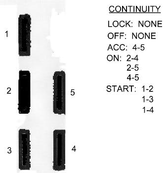

May 20, 201113 yr comment_356335 Here's a continuity test chart for the back of the switch that I made up a few years ago: Link to comment https://www.classiczcars.com/forums/topic/39627-ignition-switch-and-electrical-flow-question/#findComment-356335 Share on other sites More sharing options...
May 23, 201113 yr Author comment_356571 1974 260z late model November production. Well I bought the new lock and switch and just received it. My lock was shot as the key could be removed in any position so I felt either way it would be a good idea to replace it. It has however not solved the problem as no power. I hooked a wire to the battery positive and connected it to the coil positive. The car has power this way and starts. It does run like crap but it starts. Since the switch is good wher do I go from here...my understanding is that the power goes from the ignition to the ignition transistor then to the coil and the dist. Is this correct.Thanks Link to comment https://www.classiczcars.com/forums/topic/39627-ignition-switch-and-electrical-flow-question/#findComment-356571 Share on other sites More sharing options...
