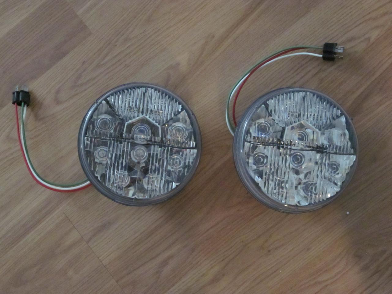

Look what I got in the mail! post-21670-14150814938826_thumb.jpg I am going to take some before and after pictures. Mind you I have Cibie headlamps from 1979 with an original purchase price of $54! a lot of money in 1979. Frankly the Cibies are pretty good but wanted to try these out.
These headlamps are made by a company called "Truck-Lite". http://www.truck-lite.com/webapp/wcs/stores/servlet/GenericView?pageName=/new/PressReleases_en_US/12vLEDHeadlamp.html&storeId=10001&langId=-1 They are a Tier 1 OEM supplier of lighting and harnessing to the trucking industry. These headlamps are currently in use by the military in Iraq and Afghanistan, in Humvees. I have actually seen these lamps in my travels in Louisiana on a national guard Hummer. These things are serious! I am guessing each lamps weighs about 2 lbs or more. They have a huge heat sink on the back, and are fully ecapsulated in epoxy for protection against water and moisture.
They only draw 2.5 Amps on low beam and 4.5 on high beam.
http://www.truck-lite.com/webapp/wcs/stores/servlet/ProductDisplay?catalogId=10001&storeId=10001&productId=64057&langId=-1&catentryId=64058
I am going to try to get these installed with before and afters today.
