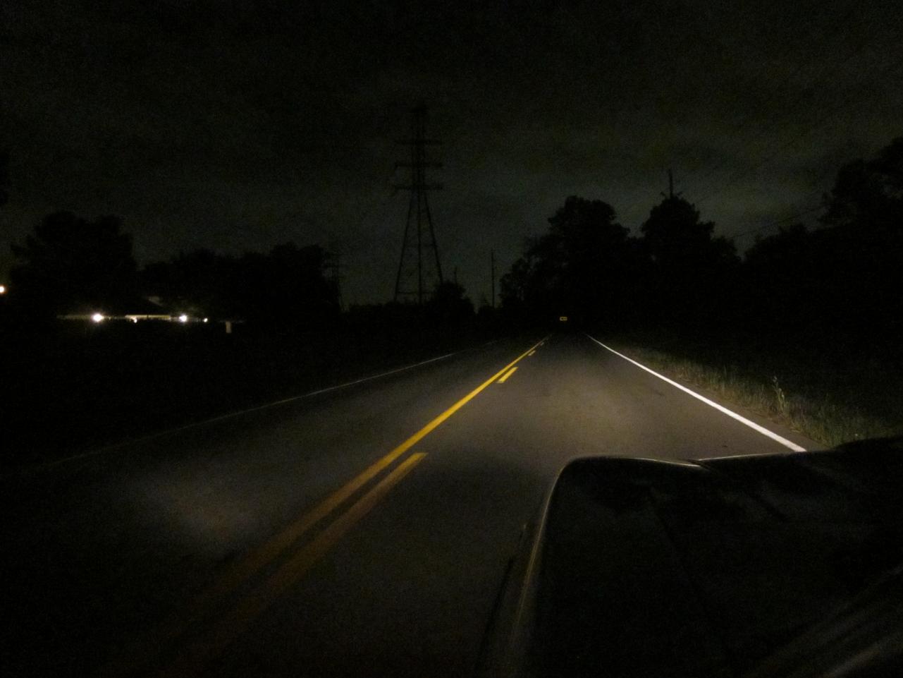

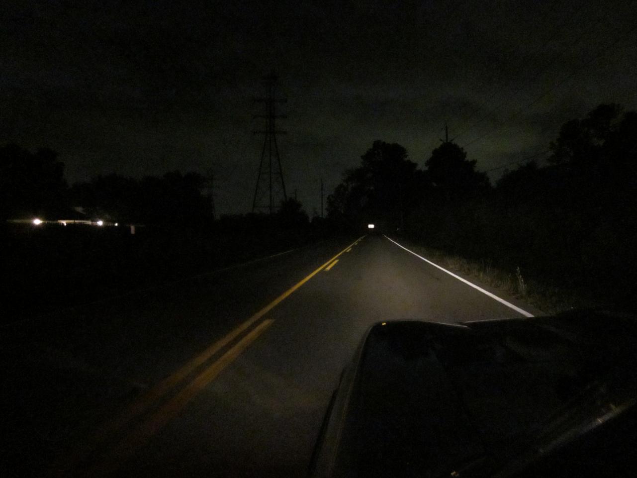

well the hmvv only sits as high as a ranger maby lower but light is no problem. its not to tight of a beam and not to wide i use them all the time. they are however really noticeable and brighter than h4. but i would like to see some pictures befor i grab a pair for my z. just to see what they look like if it is to much ill just leav mine alone.

It would be great to see an aerial view of the coverage pattern to compare it to other offerings especially in an S30 and an S130.
FWIW: I've attached an older beam pattern chart that is informative IMO.
(Low/Left Hand Drive and High beam shown are for an H4 E marked application)

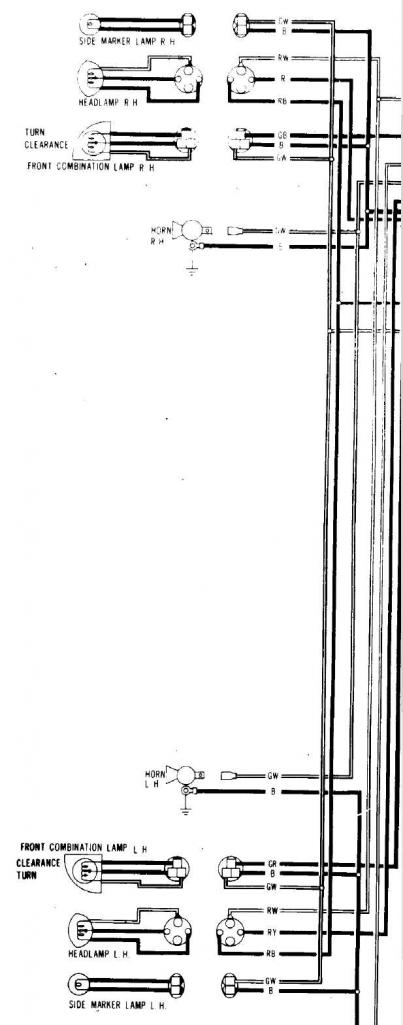

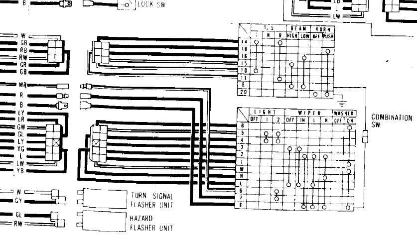

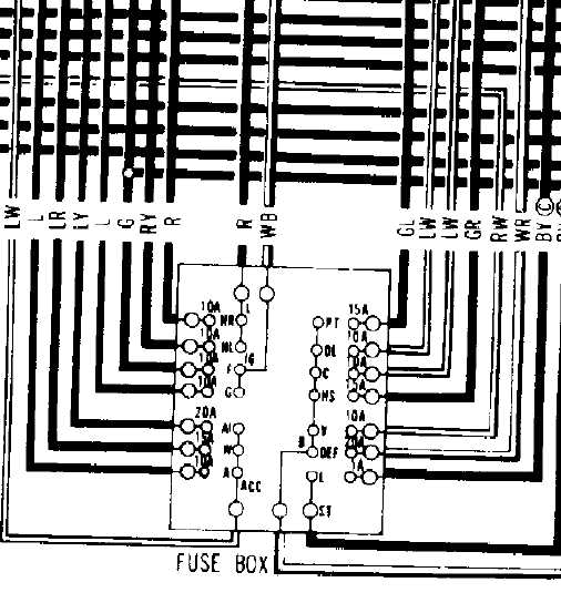

I have studied the wiring diagrams from many of the FSMs' date=' especially after others pointed out to me that the 70 & 71 240Zs have their headlight circuits wired differently than other S30s. I have converted both of my cars to relays for headlight controls. I do know what I'm talking about, and yes, I am an electrical engineer.
I'll step you through the circuit, using a positive to negative convention.
1. 12VDC+ comes into the combo switch on the right using a White/Red wire.
2. When the headlight switch is in position 2, it completes the contact and goes out the Red wire. (See the first attachment.)
3. The red wire goes into the fusebox and goes through two fuses. The fuse for the right headlight has a Red wire. The fuse for the left headlight has a Red/Yellow wire. (See the second attachment.)
4. The Red and Red/Yellow wires travel to their respective headlights and land on the common pin for the headlights. Two wires come out of each headlight. One wire is Red/Black. The other wire is Red/White. The two Red/Black wires join as do the two Red/White wires. (See the third attachment.) The wires then go back to the combo switch on the turn stalk.
5. If the switch is in the low beam setting, the Red/Black wire will be connected to ground via the Black wire. If the switch is in the high beam setting, the Red/White wire will be connected to ground via the Black wire. (See the first attachment.)
At no time does the polarity change. The path to ground changes.
