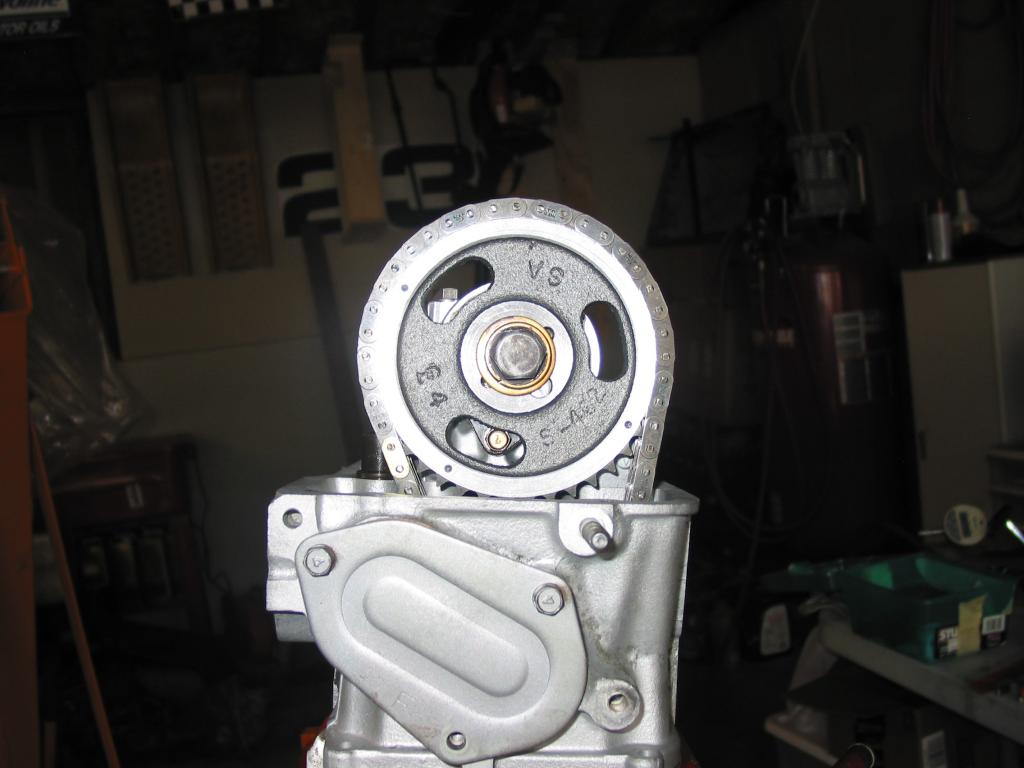

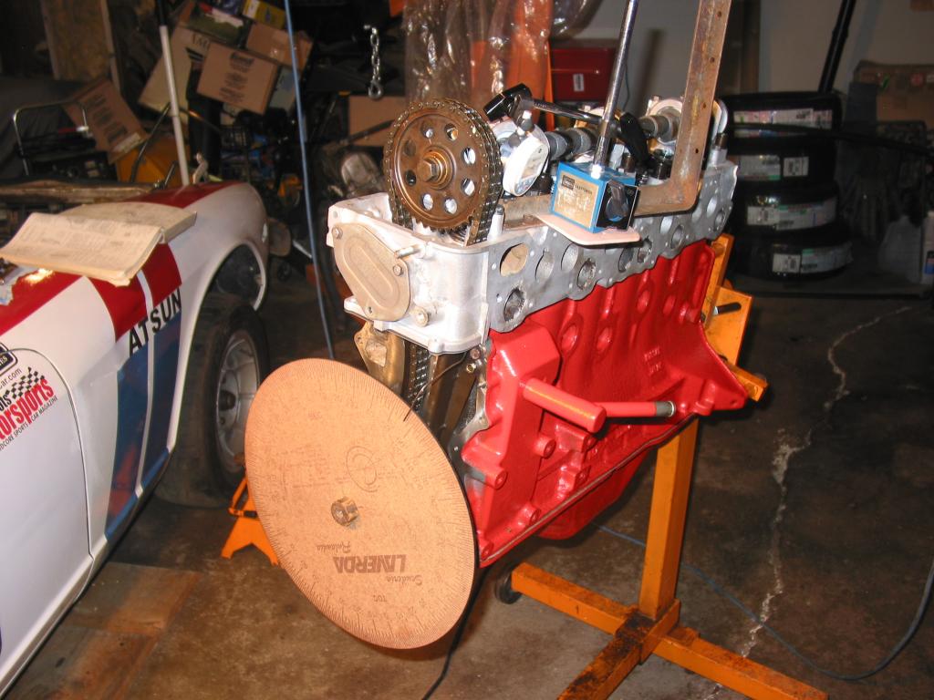

July 2, 201311 yr comment_426784 I've been busy building my engine. The race is in a little over a week. Here are a few pics of the timing with the decked head and no tower shims. It's a little too pretty for a ChumpCar engine, but it should run pretty well. Link to comment https://www.classiczcars.com/forums/topic/39741-new-engine/?&page=13#findComment-426784 Share on other sites More sharing options...

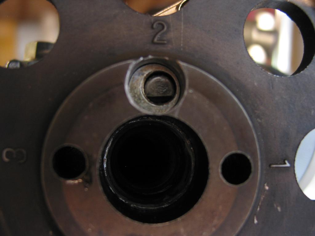

July 2, 201311 yr Author comment_426789 How did you know where and how much to mount the offset timing bushing? Link to comment https://www.classiczcars.com/forums/topic/39741-new-engine/?&page=13#findComment-426789 Share on other sites More sharing options...

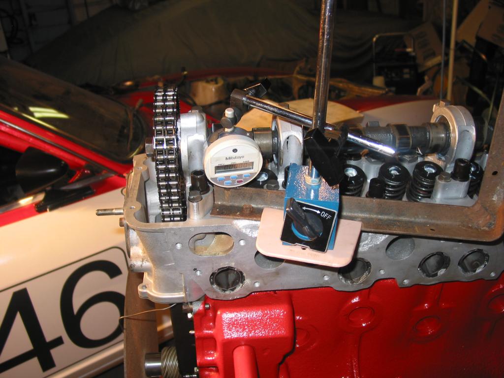

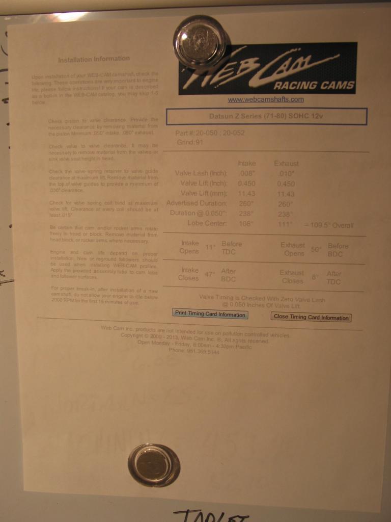

July 2, 201311 yr comment_426791 I used a degree wheel and the cam card. It's a fairly slow process, but it gets it exactly right. Find #1 TDC and set degree wheel to TDC using a piston stop. Measure 0.050" #1 exhaust valve open and compare to cam card Measure 0.050" #1 exhaust valve close and compare to cam card Install offset bushing that moves cam the right direction to match cam card Repeat until valve timing matches cam card Link to comment https://www.classiczcars.com/forums/topic/39741-new-engine/?&page=13#findComment-426791 Share on other sites More sharing options...
July 3, 201311 yr Author comment_426800 Gotcha.....Need a good dial indicator.....I'm looking forward to hearing how she runs with your new set-up. Link to comment https://www.classiczcars.com/forums/topic/39741-new-engine/?&page=13#findComment-426800 Share on other sites More sharing options...

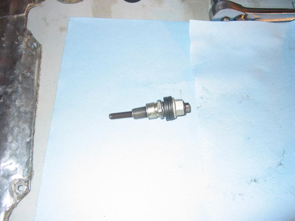

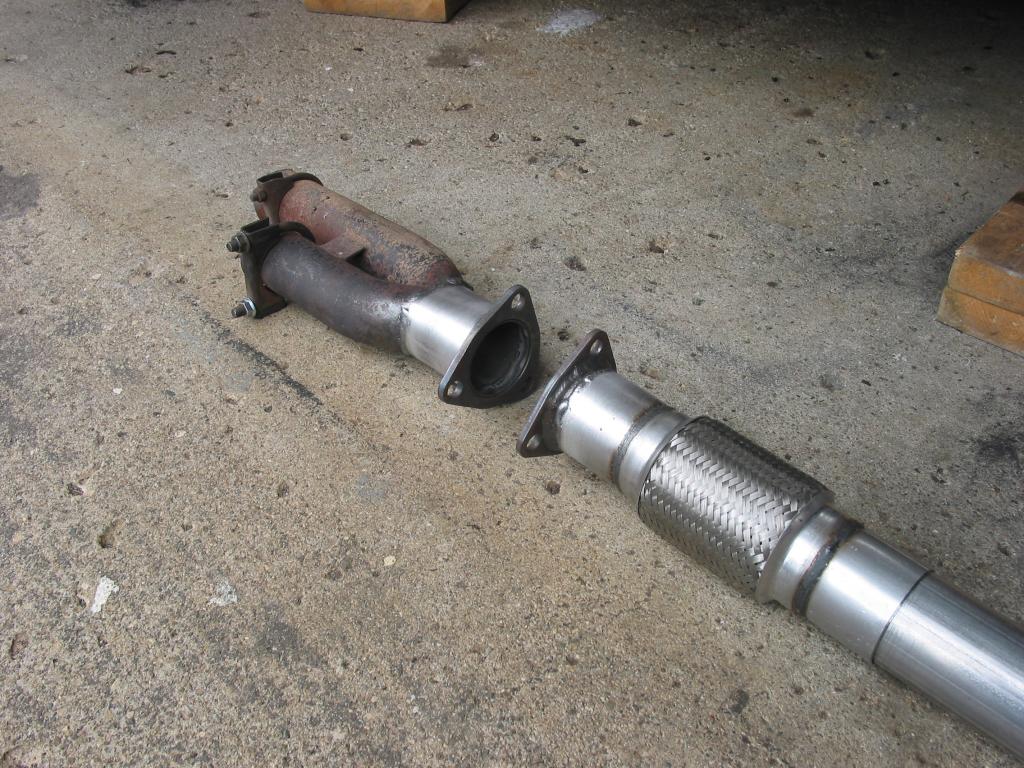

July 3, 201311 yr comment_426802 I really like my Mitutoyo digital dial indicator, but it wasn't cheap. Spend the money to get a good magnetic holder as well. My Craftsman one is serviceable, but I wish I would have bought a better one. You will also need to make a piston stop. The easiest way is to break the ceramic out of a spark plug and insert a long bolt with the end rounded. Mine was made about 20 years ago in 15 minutes, so it's really crappy, but it does work fine. Someday, I will redo it by welding the bolt to the spark plug rather than rely on all of the washers and the nut. The degree wheel is actually made of wood by downloading a jpg of a degree wheel and cutting/etching it on a CNC laser. My racing teammate made it at the Tech Shop which is a local shop that is run like a health club with monthly membership dues. Do an internet search on how to use a degree wheel to get the full instructions. I will give a complete review after my race on the 13th. I am also adding a flex pipe to the exhaust right behind the header collector to take the strain off the manifold studs. Once the engine and exhaust are installed, I'll take more pics. I'm using the slip together MSA 2-1/2" exhaust system. Link to comment https://www.classiczcars.com/forums/topic/39741-new-engine/?&page=13#findComment-426802 Share on other sites More sharing options...
