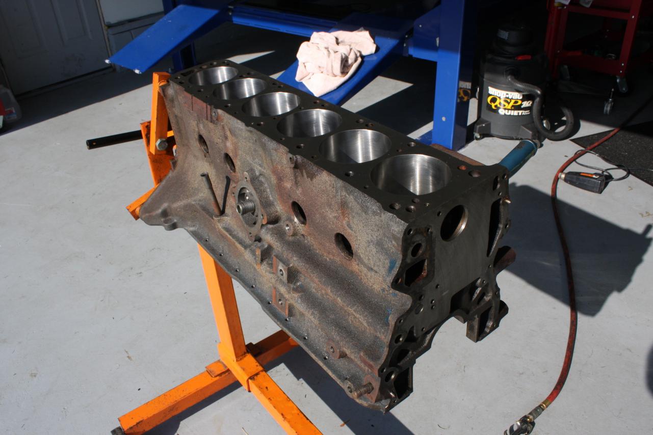

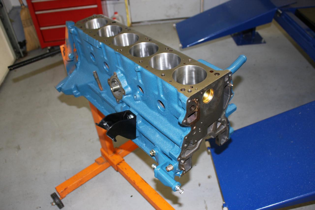

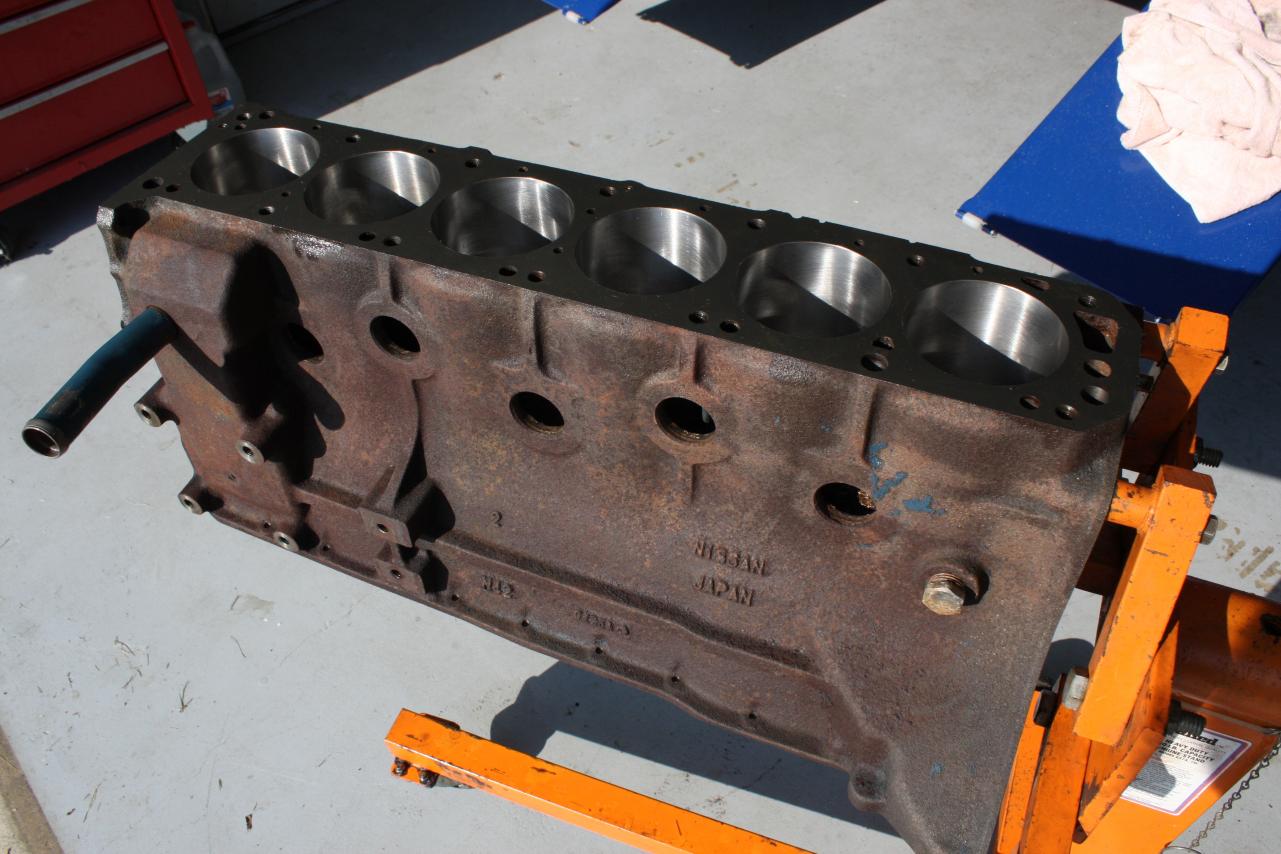

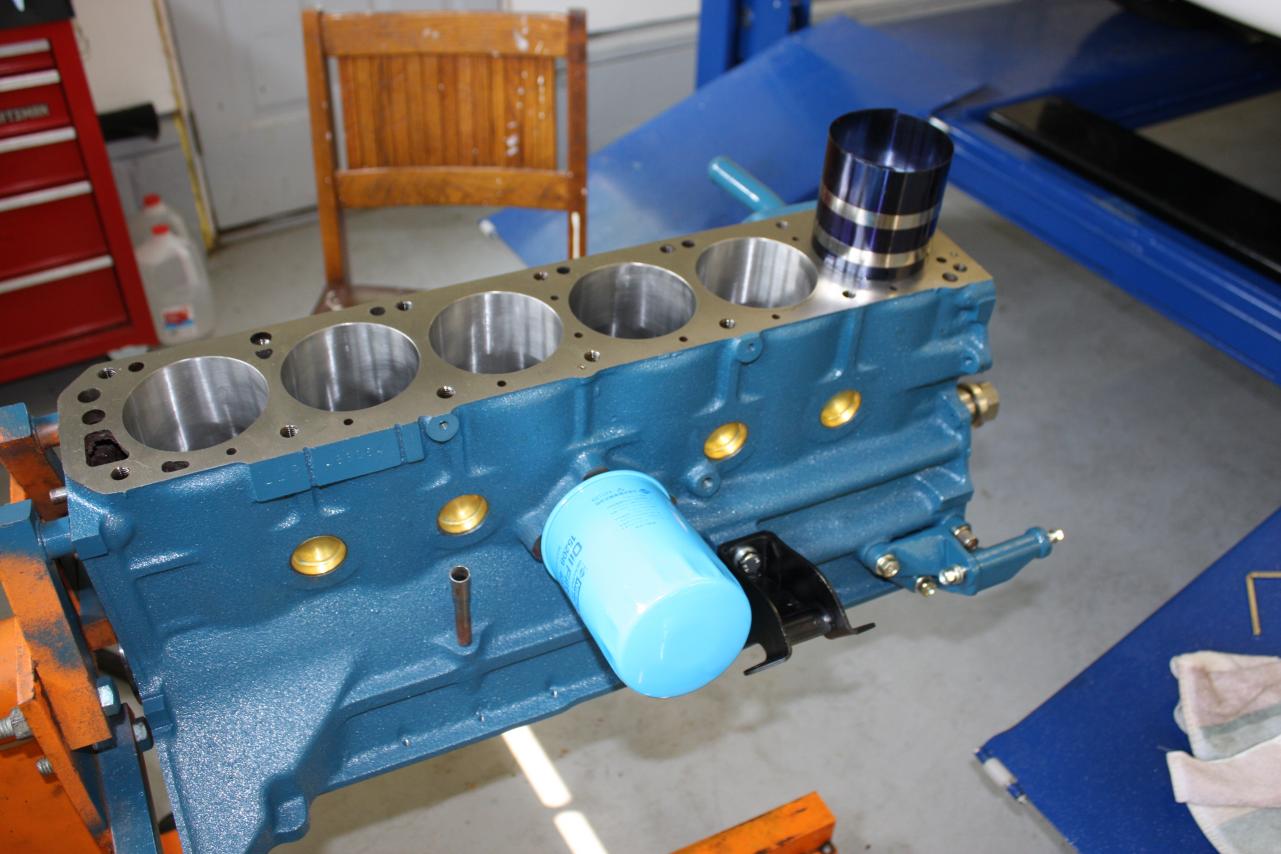

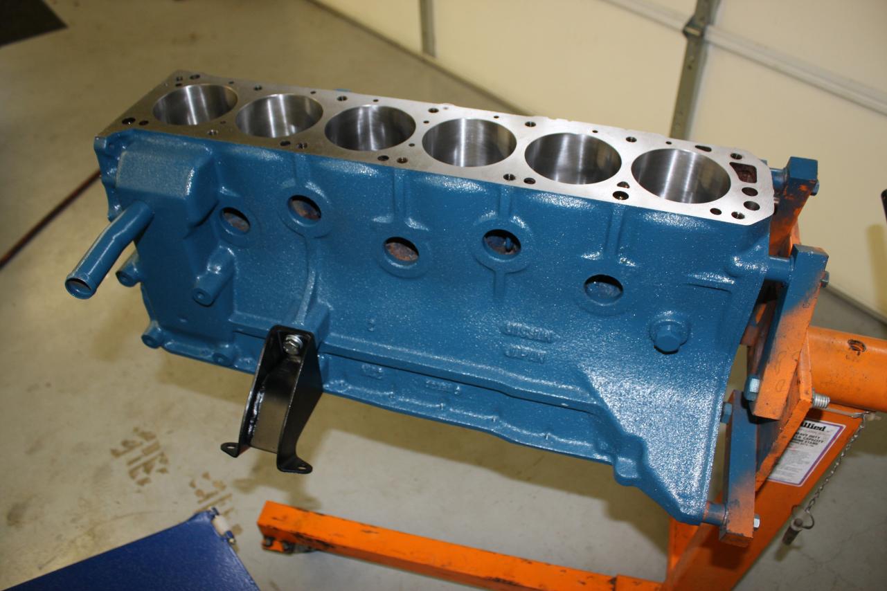

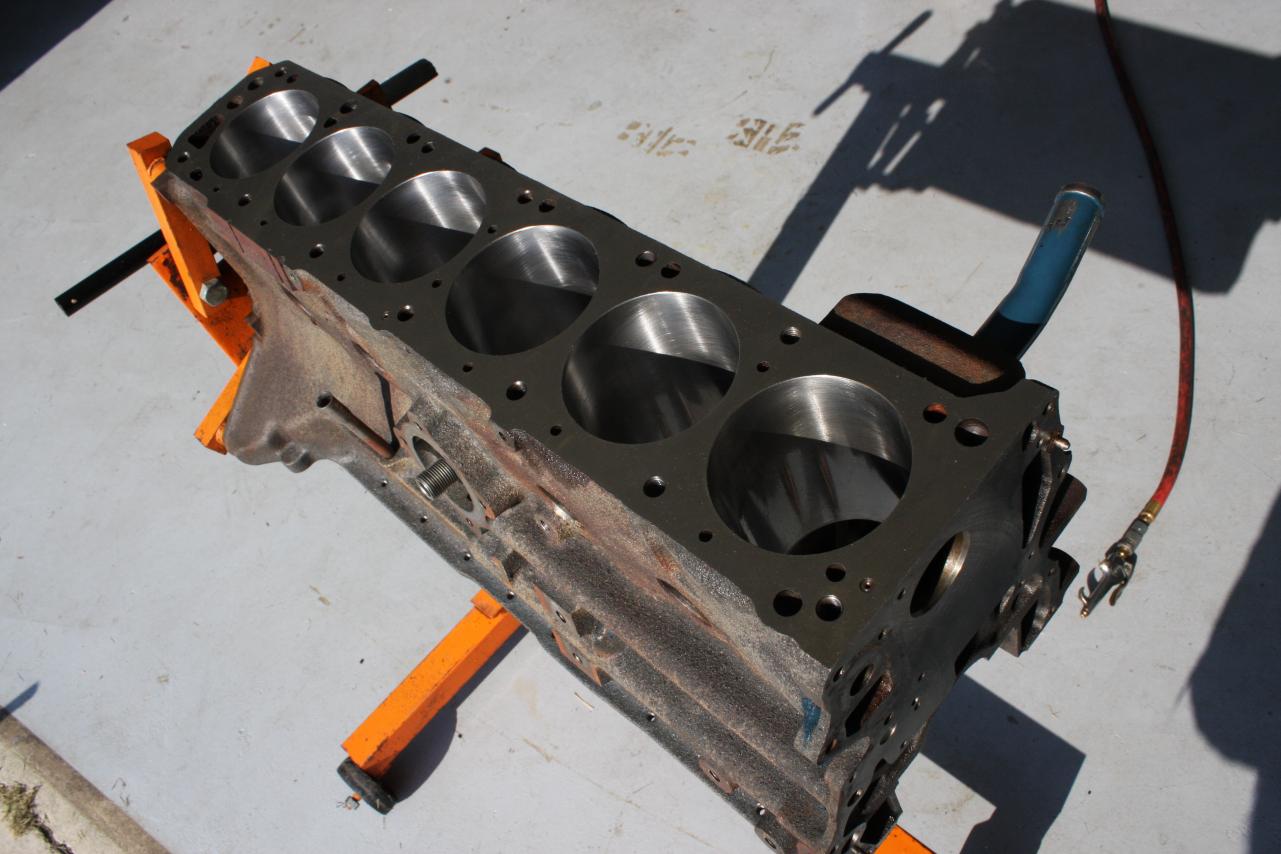

June 5, 201113 yr Author comment_357840 The engine was hot tanked and bored .040 over.......It's ready for paint and brass plugs. Link to comment https://www.classiczcars.com/forums/topic/39741-new-engine/?&page=3#findComment-357840 Share on other sites More sharing options...

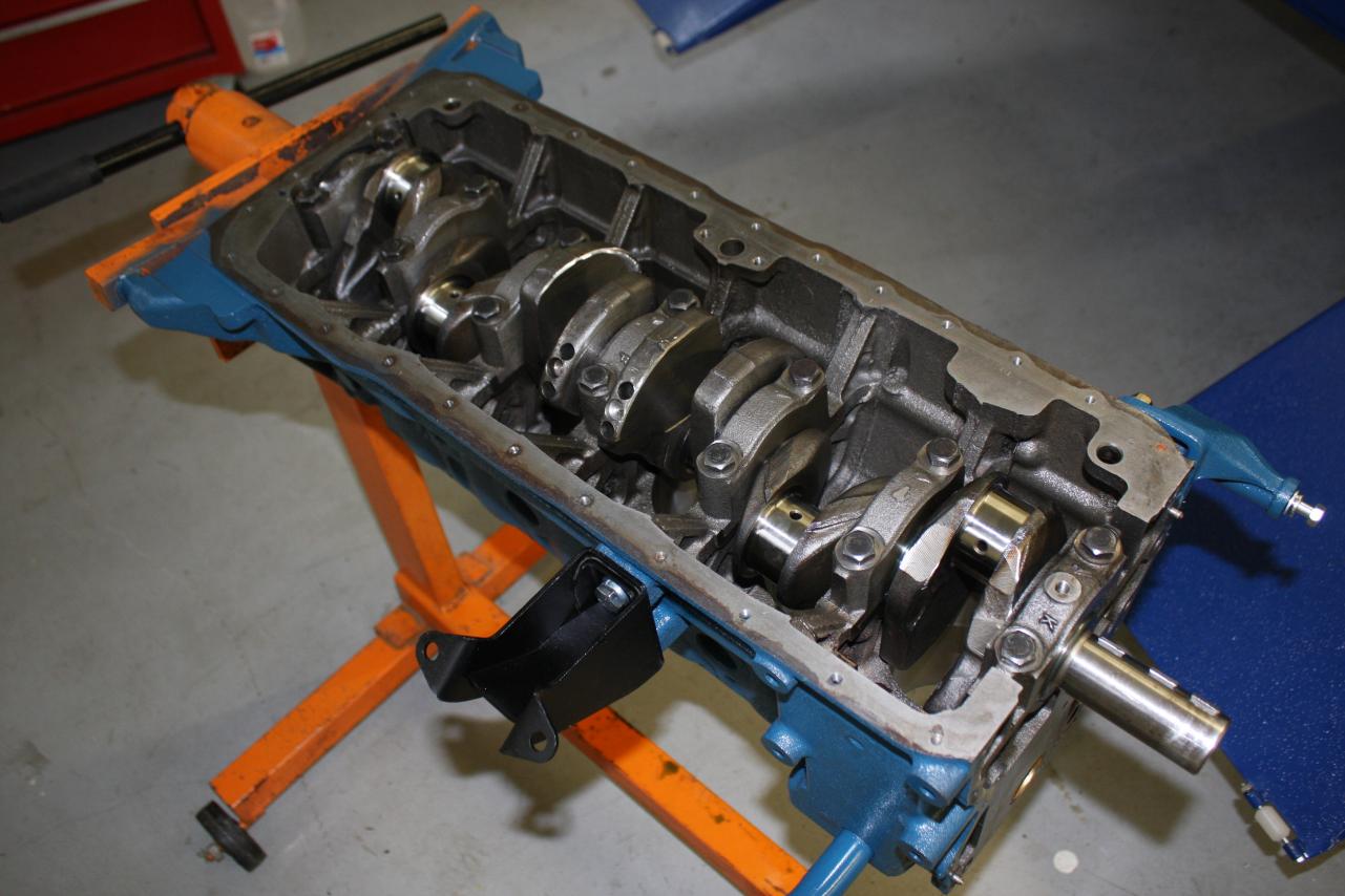

June 5, 201113 yr Author comment_357843 ........paint and an L24 crank in an L28 block.....spins smoothly! Link to comment https://www.classiczcars.com/forums/topic/39741-new-engine/?&page=3#findComment-357843 Share on other sites More sharing options...

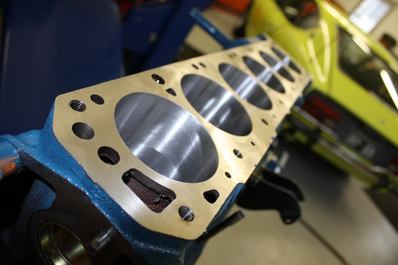

June 8, 201113 yr comment_358137 Yeah, our combo's are similar. In Australia, we never got either the P90 or P79 L28 heads. We only ever saw the N42 head and as such the gasket is for an N42 head. What I used was a genuine Nissan gasket made by Nissan. There were some Nissan HG's sold here that were made by local manufactures but sold by Nissan as genuine. Funnily, they still have the stamps of the other manufacturer on them. :stupid: PS More pictures of your engine please Guy! Link to comment https://www.classiczcars.com/forums/topic/39741-new-engine/?&page=3#findComment-358137 Share on other sites More sharing options...
June 8, 201113 yr comment_358141 The entire rotating assembly of a newly rebuilt engine reminds me of the insides of a fine watch , only a little bit larger parts. Great work. Bonzi Lon Link to comment https://www.classiczcars.com/forums/topic/39741-new-engine/?&page=3#findComment-358141 Share on other sites More sharing options...

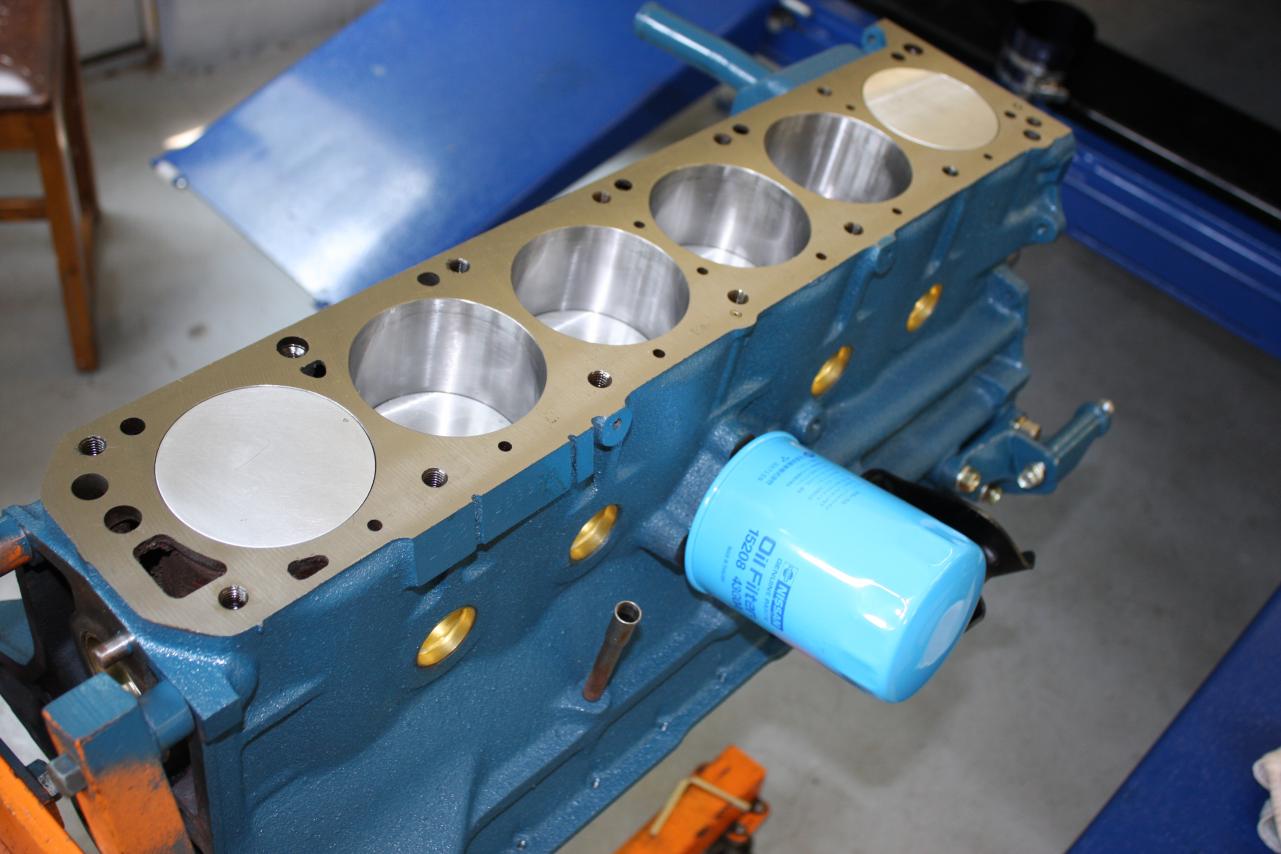

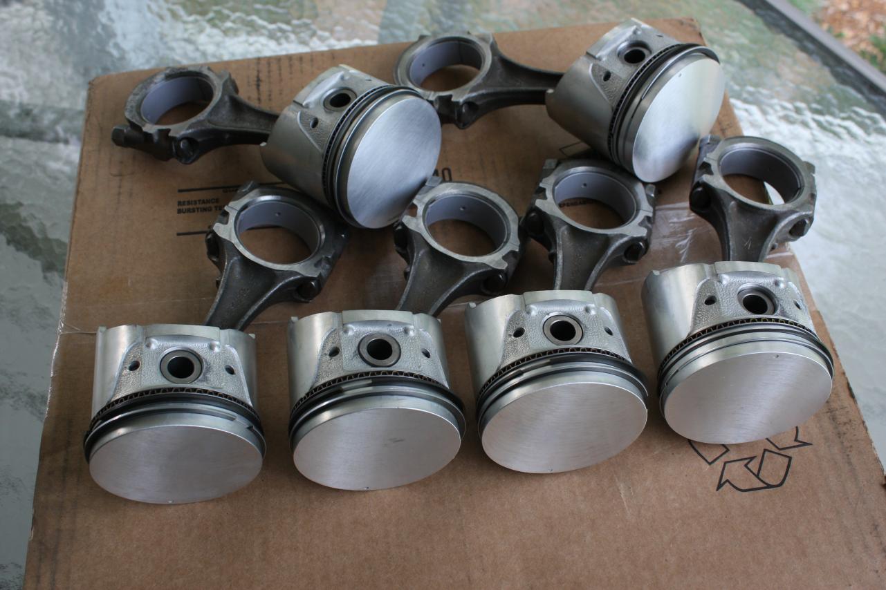

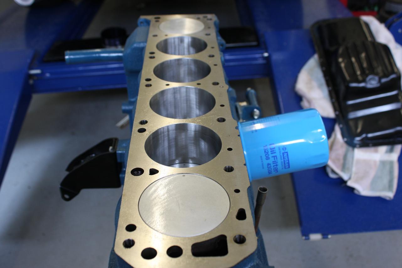

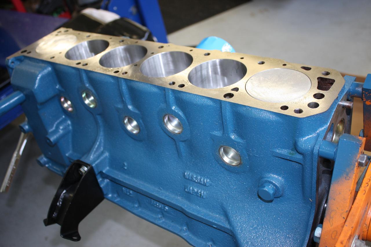

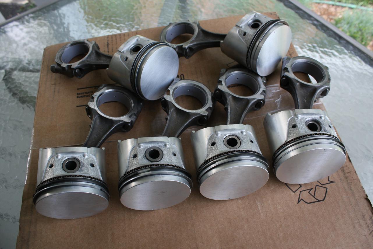

June 11, 201113 yr Author comment_358398 Added the L24 rods topped with .040 over L28 flat-top pistons this morning. Edited June 11, 201113 yr by Diseazd Link to comment https://www.classiczcars.com/forums/topic/39741-new-engine/?&page=3#findComment-358398 Share on other sites More sharing options...

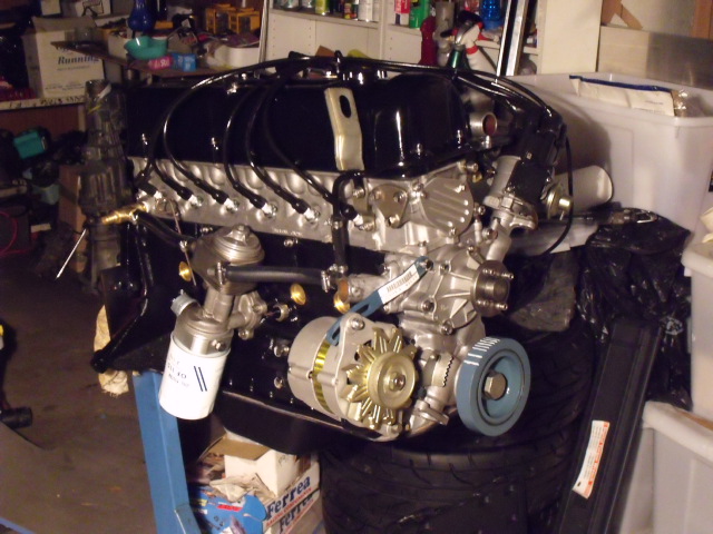

June 12, 201113 yr comment_358438 That looks fantastic Guy! Brass and steel core plugs? Reminds me of my engine, complete now, just waiting on the correct balancer to arrive and in she goes.... Link to comment https://www.classiczcars.com/forums/topic/39741-new-engine/?&page=3#findComment-358438 Share on other sites More sharing options...
June 12, 201113 yr Author comment_358442 Nice engine OZ......well done. Is that the N42? I'm just waiting on the Z Doc to finish working his magic on my P79 head. Then I'll have to geometry the rockers and she'll be ready for final assembly. Good eye on the freeze plugs.......you win a new set of " Roo Bars"!! Guy Link to comment https://www.classiczcars.com/forums/topic/39741-new-engine/?&page=3#findComment-358442 Share on other sites More sharing options...
June 12, 201113 yr comment_358444 Hey, the front bars on my Cedric ARE Roo Bars (they're big enough), a second set would be nice. Thanks! Yeah, it's an N42 block like yours. Have fun with the construction phase mate. Cheers. Link to comment https://www.classiczcars.com/forums/topic/39741-new-engine/?&page=3#findComment-358444 Share on other sites More sharing options...
December 31, 201113 yr comment_375860 Hello Guy..........what's the latest on your engine buddy........updates please? I've got my engine in, run it in and have taken it out to the track for some action already! Oh, you'll love your engine if mine is anything to go by. http://youtu.be/nMcCqok4Co4 Link to comment https://www.classiczcars.com/forums/topic/39741-new-engine/?&page=3#findComment-375860 Share on other sites More sharing options...
