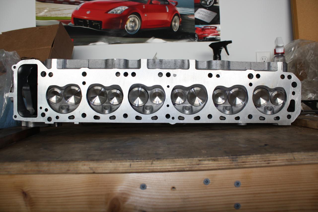

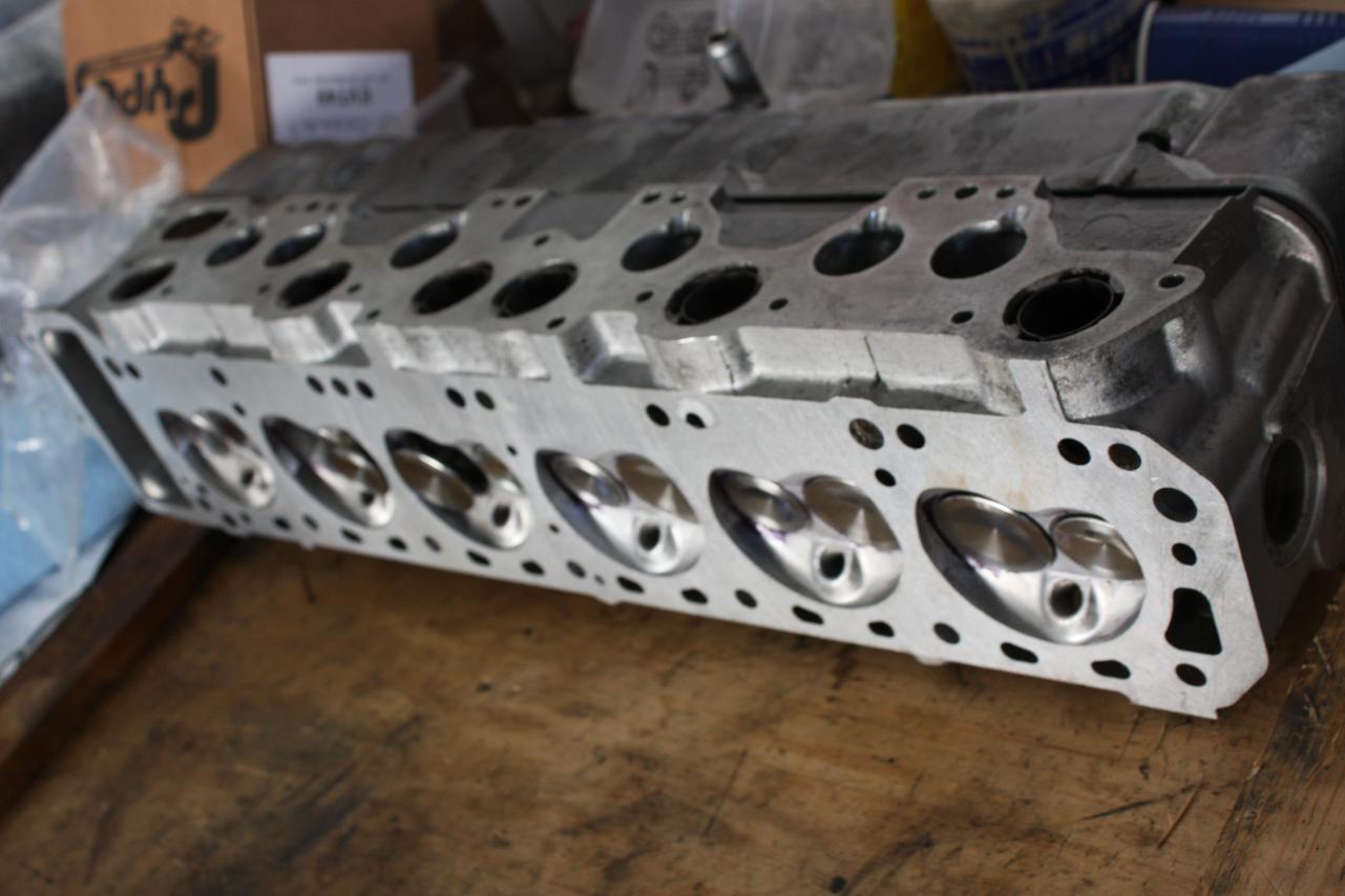

January 1, 201213 yr comment_375916 ...and a Happy New Year to you and yours Guy!! Cheers mate :classic: The head combo sounds very solid indeed. I've read about that head mod and it seems to be a great idea, a more modern chamber WITH a higher compression ratio. Awesome. Were the SS valves oversized? Trust me, you'll be itching to put that 'mystery motor' in ASAP. I couldn't tell you I'd been to the track without showing you. It's moves along nicely with 8.3 compression and a stock "A" grind cam though. Can anyone say 'turbo' Edited January 1, 201213 yr by ozconnection Link to comment https://www.classiczcars.com/forums/topic/39741-new-engine/?&page=4#findComment-375916 Share on other sites More sharing options...

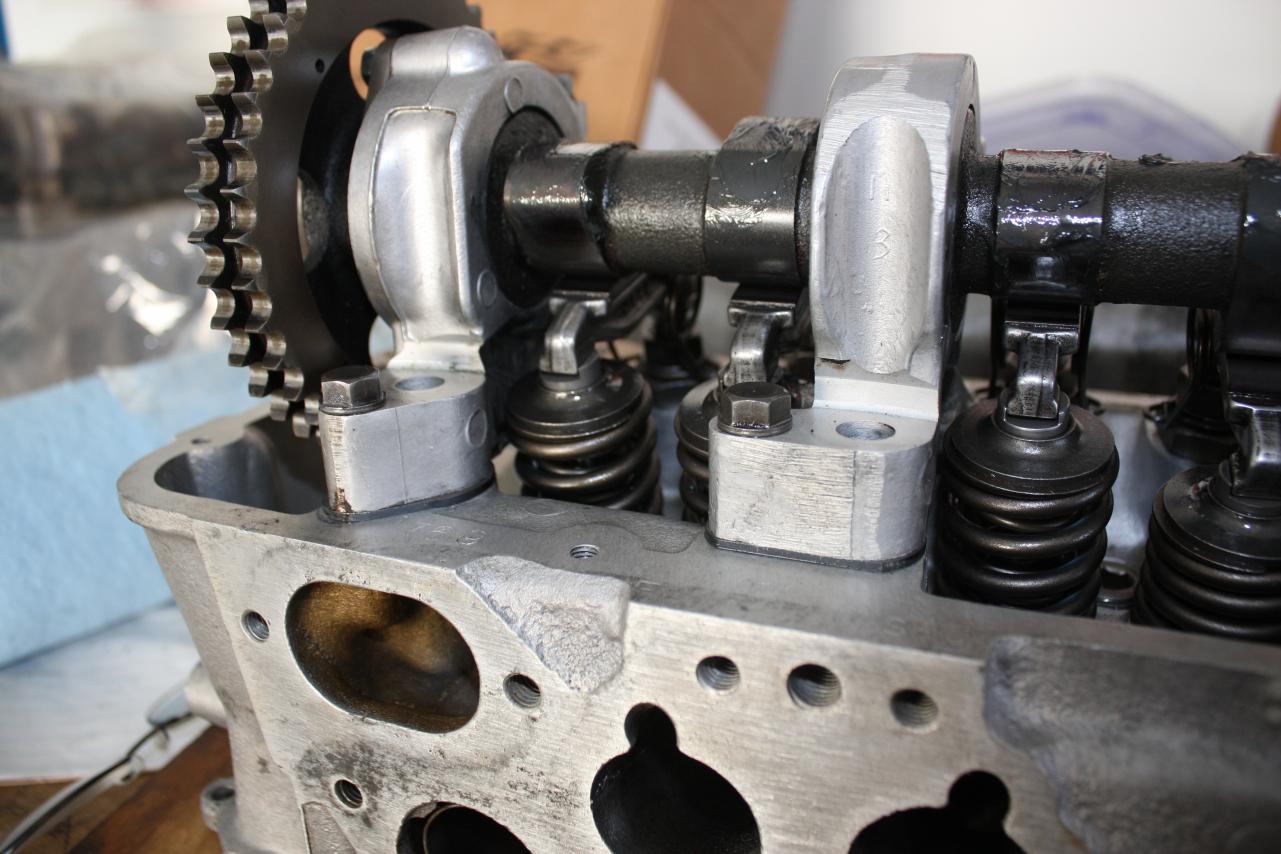

January 2, 201213 yr Author comment_376055 The P79 head shaved, shimmed, rocker geometry centered and ready for installation. Note shims under cam towers. Link to comment https://www.classiczcars.com/forums/topic/39741-new-engine/?&page=4#findComment-376055 Share on other sites More sharing options...

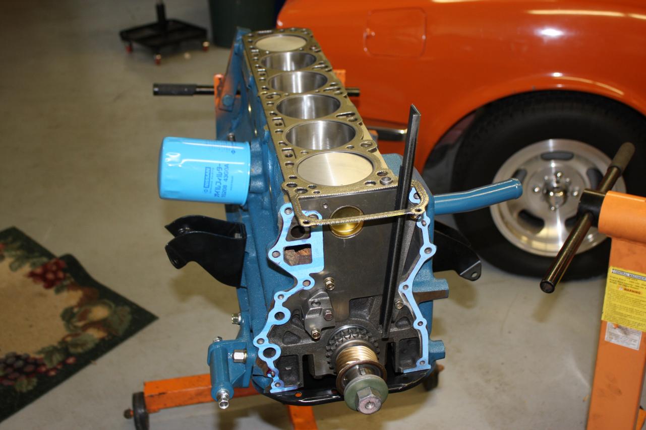

July 21, 201212 yr Author comment_396421 Progress......Now that I've got a car for the motor, I'm moving forward. This motor will go in the 918 orange 72. Link to comment https://www.classiczcars.com/forums/topic/39741-new-engine/?&page=4#findComment-396421 Share on other sites More sharing options...
July 21, 201212 yr comment_396424 Its gonna be sweet. Now we can go for cruise in old looking cars versus all the brand new Z's....at least until this one gets a little makeup. Link to comment https://www.classiczcars.com/forums/topic/39741-new-engine/?&page=4#findComment-396424 Share on other sites More sharing options...
July 22, 201212 yr comment_396431 Looking good! I almost forgot you had this project going on. Link to comment https://www.classiczcars.com/forums/topic/39741-new-engine/?&page=4#findComment-396431 Share on other sites More sharing options...
July 22, 201212 yr comment_396434 Looking great Guy. Keep the pics coming. Link to comment https://www.classiczcars.com/forums/topic/39741-new-engine/?&page=4#findComment-396434 Share on other sites More sharing options...

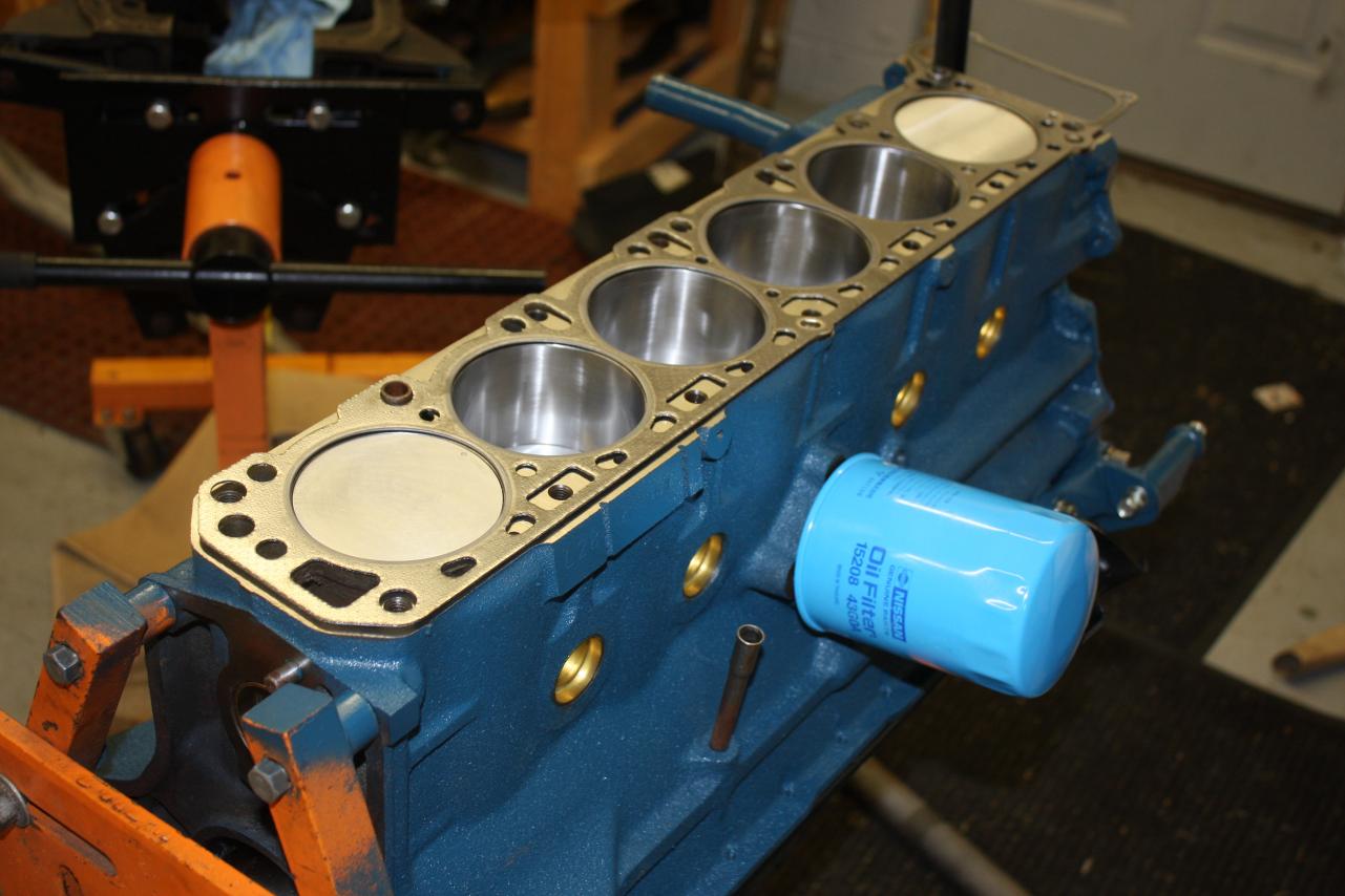

July 22, 201212 yr comment_396437 Without having to look it up, where does that put the pistons are far as deck height?What HG are you using? Link to comment https://www.classiczcars.com/forums/topic/39741-new-engine/?&page=4#findComment-396437 Share on other sites More sharing options...

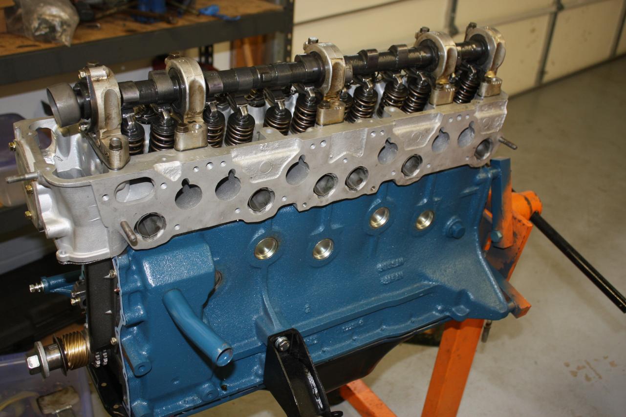

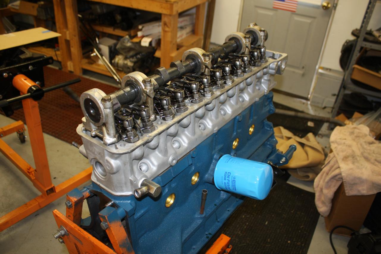

July 22, 201212 yr comment_396451 Getting closer now.... Link to comment https://www.classiczcars.com/forums/topic/39741-new-engine/?&page=4#findComment-396451 Share on other sites More sharing options...
