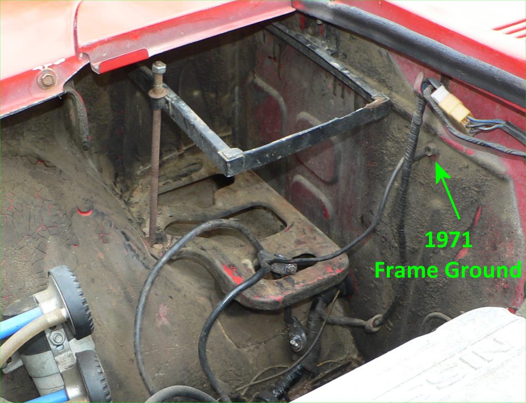

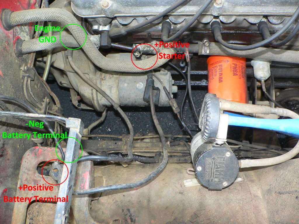

Here are some photos showing the connections to refresh.
A new pos and neg battery cable from autozone would be a good replacement upgrade.
Note: The -neg terminal is on the battery tray and the +pos has fallen through it (see 2nd photo for this detail)
Edited by Blue
