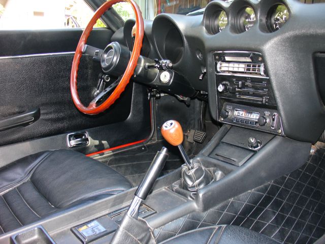

Posted June 13, 201113 yr comment_358508 Hello Guys,I need some help. I got all the electrical components working except for this center console or dash unit. Photo is attached. This has the three control indicator for the fog, hazard and seat belt. As shown in the picture, I am or my mechanic cannot find where to plug it. I cannot see the harness or wire that it need to be attached. Please send me photos where it is in your cars and where or what I need to do to get it connected. I would at least need photos or instructions what wrires I need to connect it to to get this unit working. I aslo need a wiper motor because I now discovered that mine does not work. I am now on a tight budget and exhausted but I can see the checkered flag ahead. Ohh by the way At this time it is 8:55PM Florida time and the Miami Heat are making matter worst. I turned off the tv. <a href="http://s347.photobucket.com/albums/p450/chachacourt1/?action=view¤t=IMG_20110611_150420.jpg" target="_blank"><img src="http://i347.photobucket.com/albums/p450/chachacourt1/IMG_20110611_150420.jpg" border="0" alt="Photobucket"></a> Edited June 13, 201113 yr by chachacourt photo Link to comment https://www.classiczcars.com/forums/topic/39874-please-help/ Share on other sites More sharing options...

June 13, 201113 yr comment_358533 If your vehicle is a 70, per your signature, that piece is NOT what you need. You would need the ashtray/cigar lighter opening combination cover.That's why you can't find the harness/connector, that connector piece is for a later model at least late 72 if not 73 with the Seat Belt Warning interlock system and the Choke Warning light. Neither one of those systems were on the 70 model.Only if you change the complete dash wiring harness (and the engine bay and rear harness) with all the required relays, sensors etc would that piece be needed.FWIWE Link to comment https://www.classiczcars.com/forums/topic/39874-please-help/#findComment-358533 Share on other sites More sharing options...
June 13, 201113 yr comment_358535 I hadn't seen the year in the signature. Good catch, E. Here's a picture of what a '70 or '71 should have there... Link to comment https://www.classiczcars.com/forums/topic/39874-please-help/#findComment-358535 Share on other sites More sharing options...

June 13, 201113 yr Author comment_358588 Yes I did. I added the year of the car last night after your reply. I am now at the shop and looking at Arne's picture, I think that I have a different center console. A little bit longer. Thanks for all your help. I will have to look for a 70 center console later on. I thought all 240z center control were the same.The car came with this cneter control and this three indicator unit. Link to comment https://www.classiczcars.com/forums/topic/39874-please-help/#findComment-358588 Share on other sites More sharing options...
June 13, 201113 yr comment_358592 Nope, the '70-71 console was different. Nice originals are hard to find. I believe MSA was offering a fiberglass repro of the console itself at one time. The ashtray/fuse-cover can be hard to find as they are terribly brittle and easily broken. Link to comment https://www.classiczcars.com/forums/topic/39874-please-help/#findComment-358592 Share on other sites More sharing options...
