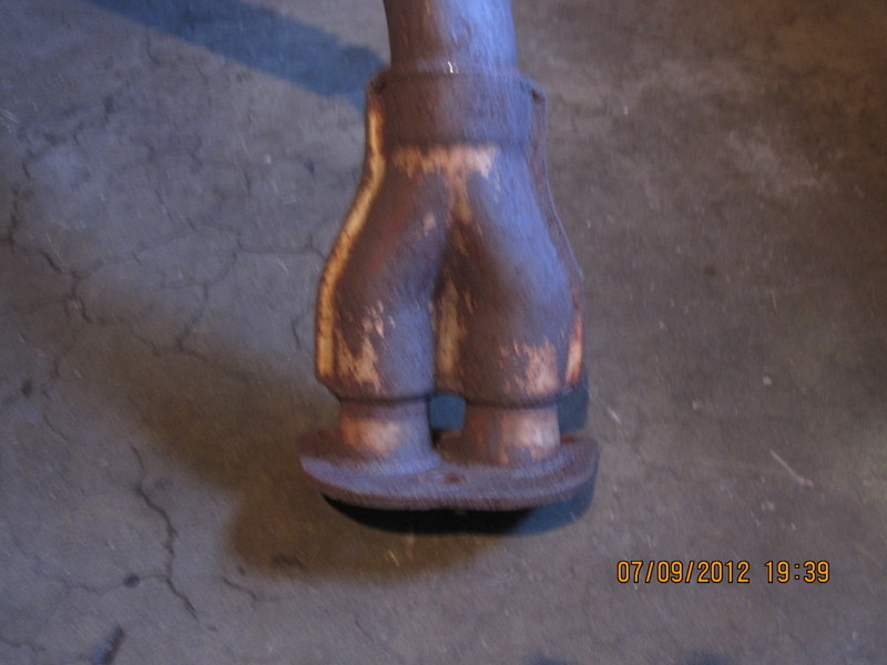

July 10, 201212 yr comment_395301 A 25% or even 10% improvement in horsepower or performance is probably a bit optimistic... But I don't doubt that replacing the stock exhaust has to help the engine quite a bit, look at how restrictive the stock y-pipe was on my 280: Edited July 10, 201212 yr by 8DC Link to comment https://www.classiczcars.com/forums/topic/39888-l28-stock-exhaust-replacement-what-is-the-power-gain/?&page=2#findComment-395301 Share on other sites More sharing options...
July 10, 201212 yr comment_395305 Saw your post about your collector pipe on another forum and though for sure that someone would respond that it was not stock. I have three 280Z collector pipes and they all look like the attached picture. I have a portion of a ZX pipe also and it looks similar. Link to comment https://www.classiczcars.com/forums/topic/39888-l28-stock-exhaust-replacement-what-is-the-power-gain/?&page=2#findComment-395305 Share on other sites More sharing options...
