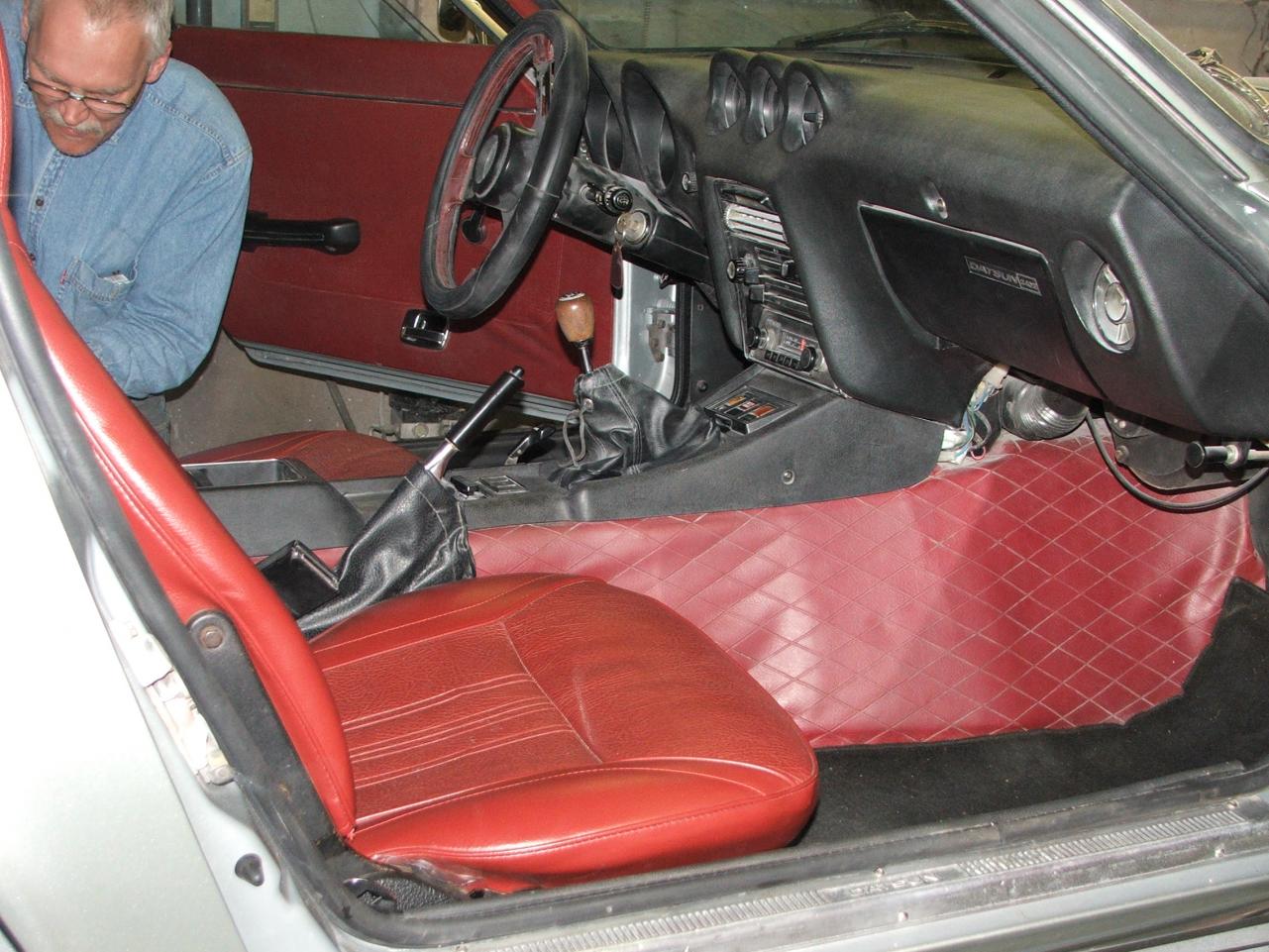

How close are you getting, Tom? I keep waiting for you to drive it up here to Eugene so I can see it!
