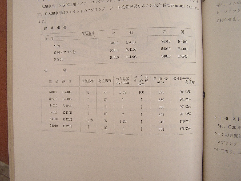

Hello,
I have a question, I looked up earliest parts catalogs both LHD and RHD, springs are exactly same for both.(except Z432,of course this car is RHD only)
I thought the reason of front springs are different right side and left side because of the driver and related systems weight( steering/pedals/guages e.t.c), but seems not.
Because of what? I think LHD should have inverted springs right side and left side.
All S30 have longer spring on the right side than left side, they become same length when installed.Please see attached picture.

I've corner weighed a stock LHD 1971 240Z and the right front is heavier then the left front with a driver and passenger in place (actually 125 lb. sand bags). Removing the battery balanced the front weights.
I've always heard it was the battery, alternator and starter all on the right side that required the longer RF spring, not the weight of the driver. The passengers sit far enough towards the rear wheels that I suspect their weight has more effect on the rear corners than the front.

I think it means neither. Key point is compressed length with car level and stationary. Aim was to level up the car. Spring rate ( 'hard' / 'soft' ) is a different issue.
This is interesting to know. I was thinking of cutting and welding on threaded collars to my stock JDM 240Z-L strut housing for coilovers. Now that I know they are different, I best source a set of USDM strut housing.
Other dimensions held constant, a longer spring will have a softer rate.
I'm trying to point out that the car needs to sit properly ( level side-to- side, and not too much rake end-to-end ) quite apart from the actual spring rates, but still taking them into account. Does that make sense? Probably not.....
