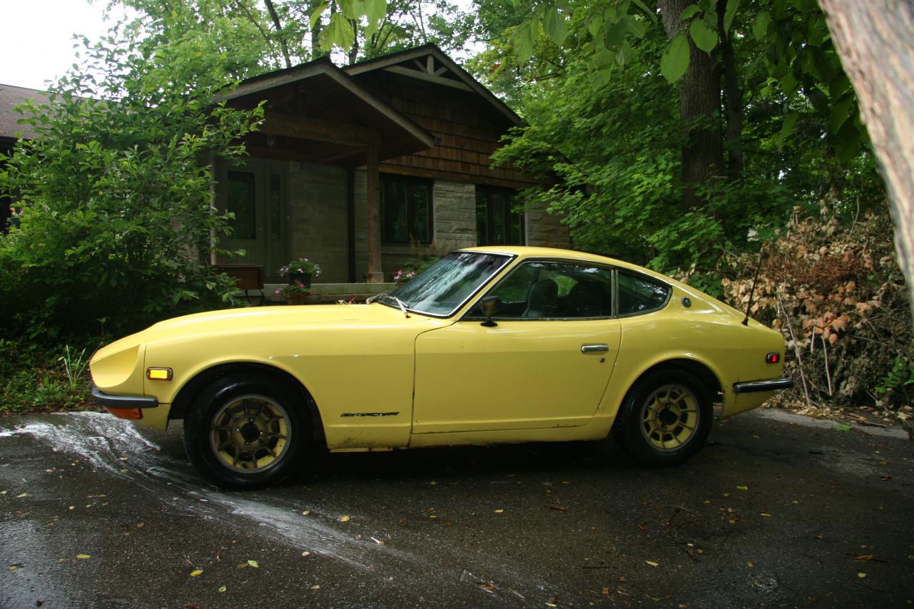

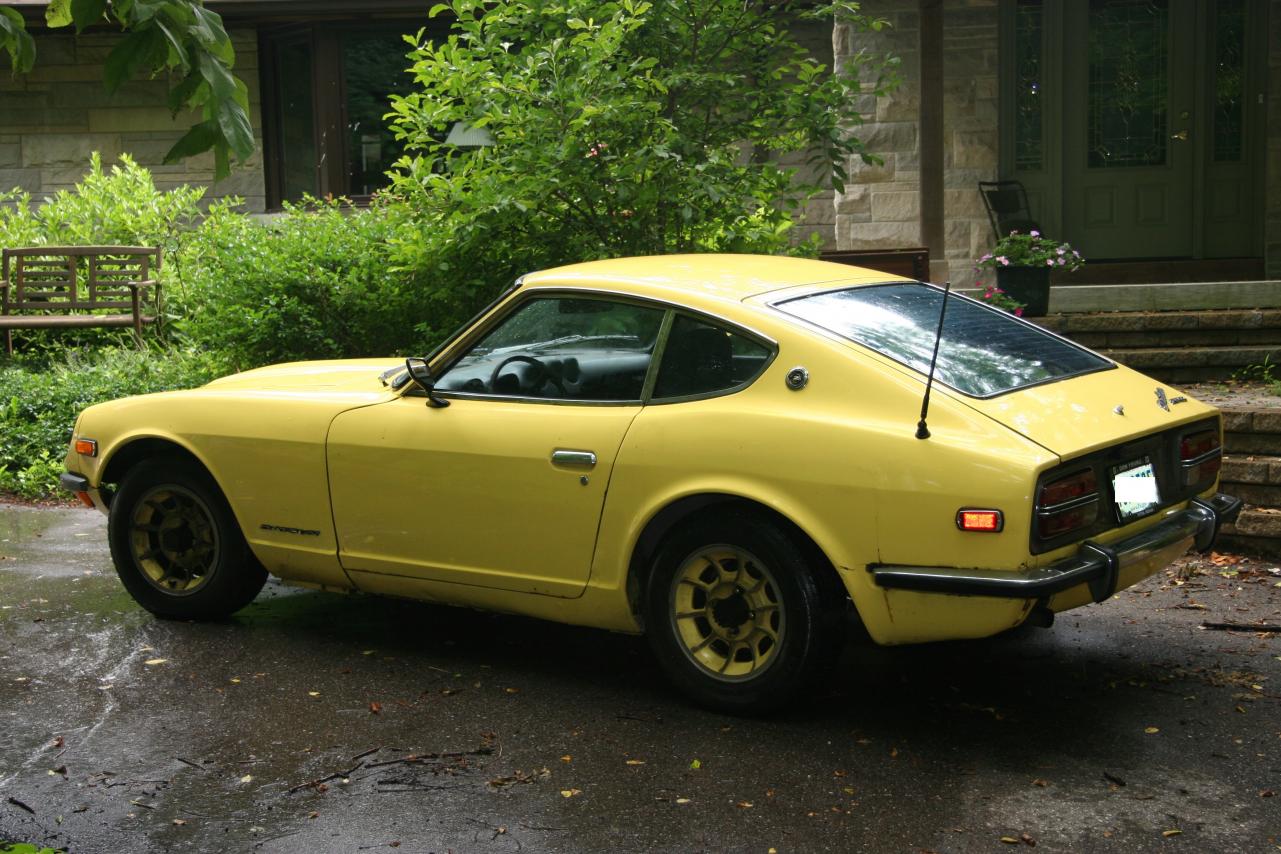

Hi all,
I bought my first 240Z in college and now, more than a decade later, I will once again be a Z car owner. In six days, I will fly to Indianapolis, where my parents live, to pick up a '72 240Z that has been sitting in a garage for the past 5 years. The owner of said car, me, stupidly (and stubbornly) held on to it instead of selling it, when he (I) moved to NYC.
I don't know what condition it will be in when I see it. It ran well when I drove it into the garage, but I expect it will need a good deal of work before I can drive it out again. The plan is to do enough work to it to drive it back to NYC and use it as a weekend getaway/beach car for the summer. Keeping my fingers crossed until then.
Below are two pictures taken of it a few days before going into "storage."
