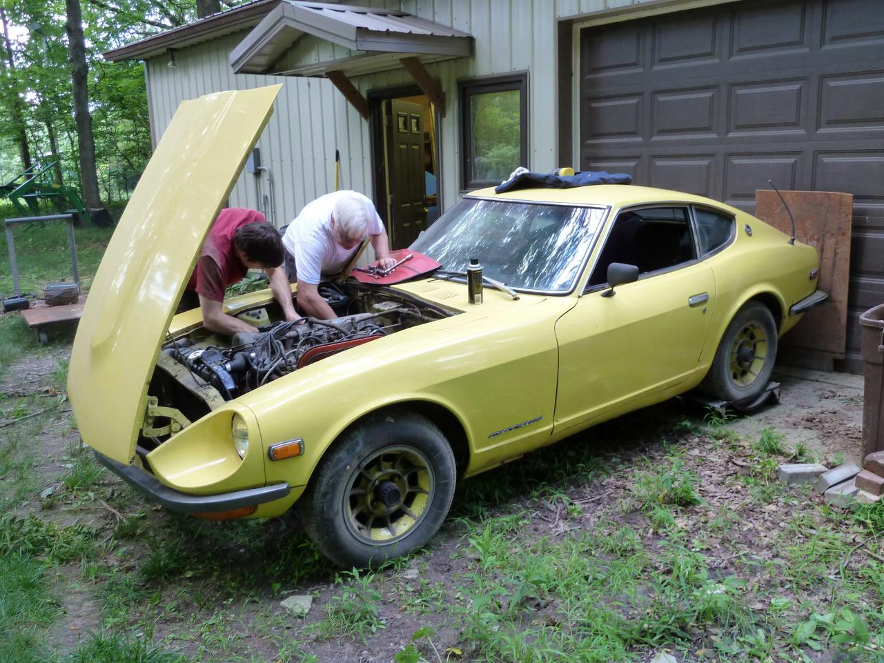

Okay, so I made it there, and was able to assess the condition of the car, after sitting for such a long time. It's funny how memory makes the past seem better than it actually may have been.

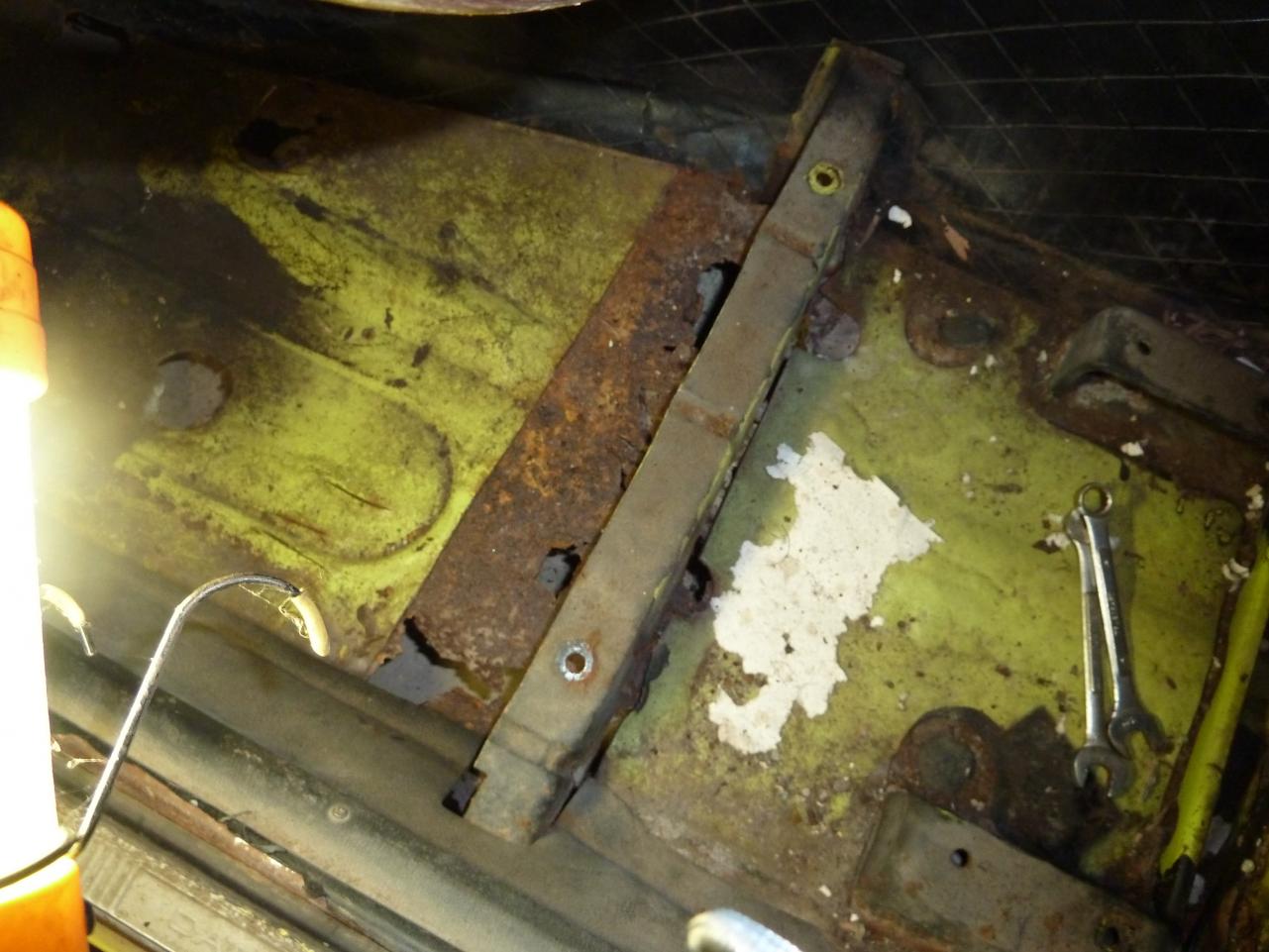

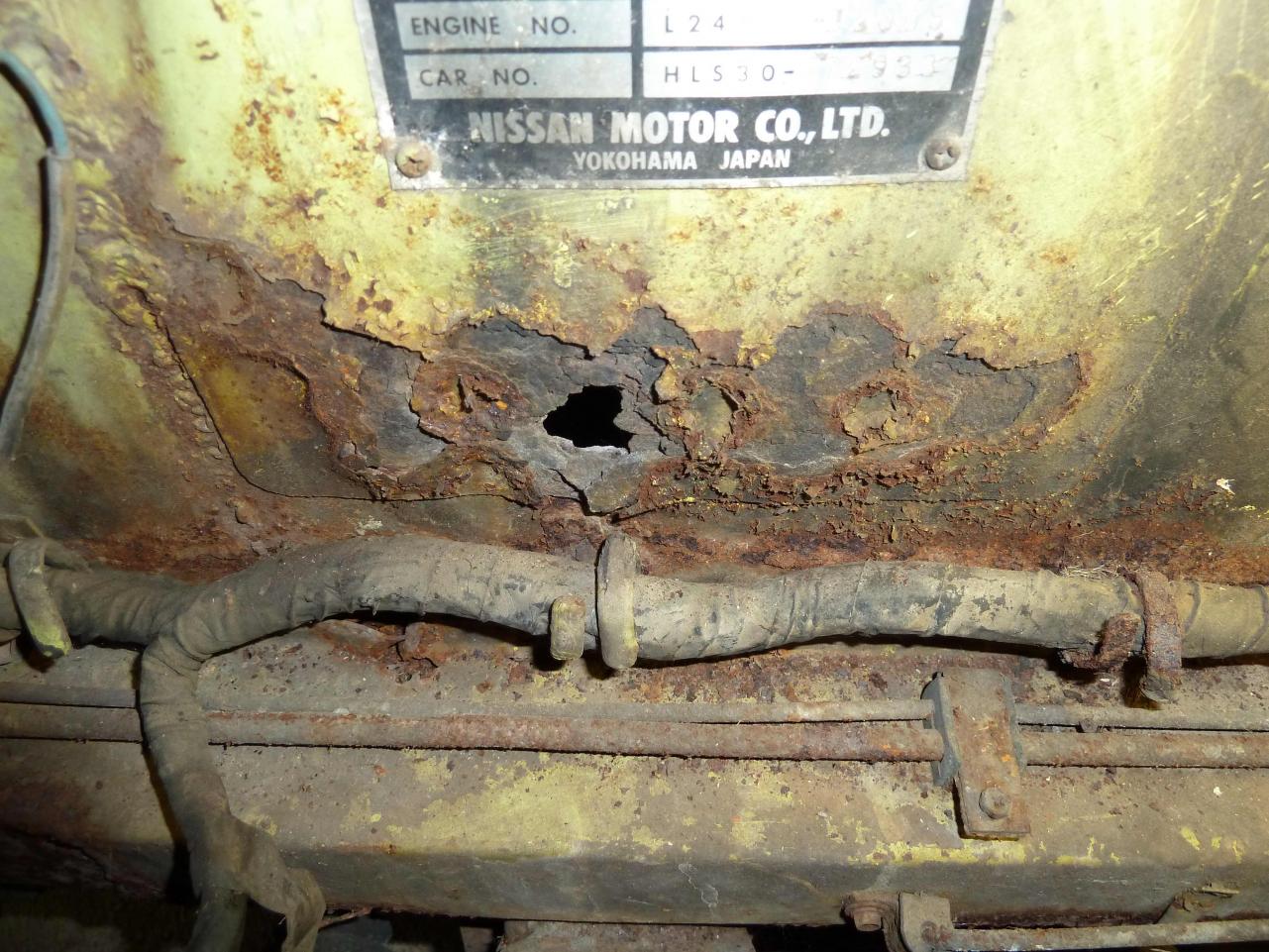

I was disheartened when I realized this car is very, very rusty. The driver's side floor pan is virtually nonexistent. post-24497-14150815692443_thumb.jpgmost of the undercarriage is rusted and the rear quarter panels are turning to dust, I mean rust.

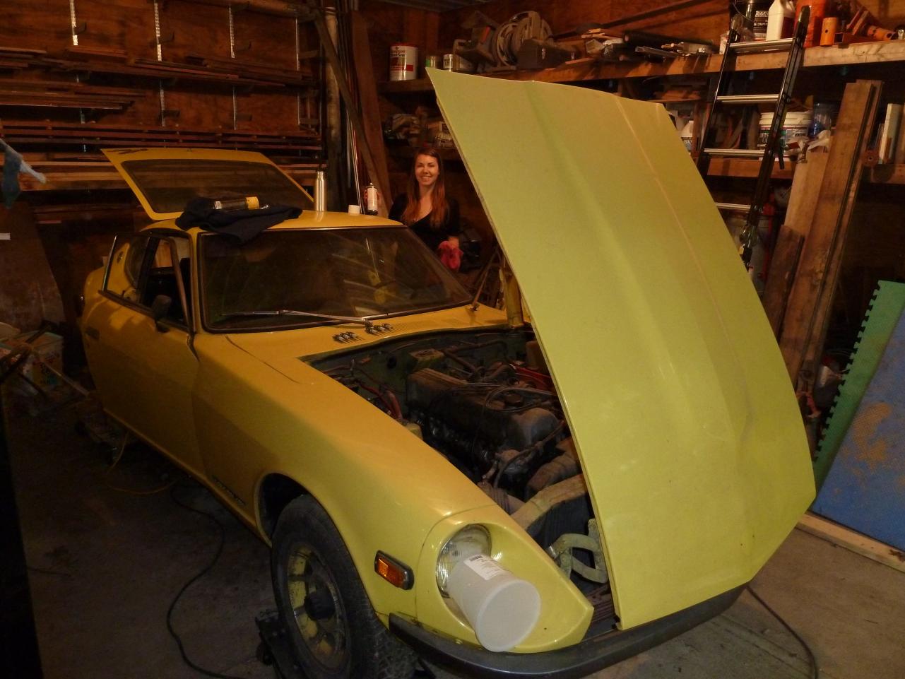

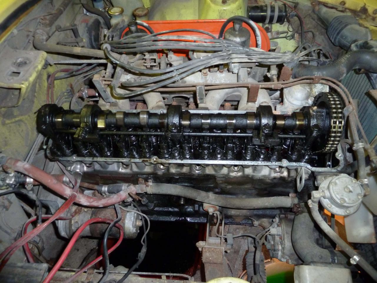

But, I had already ordered parts and decided to see what I could do with her. I followed the advice of everyone here and starting at the fuel system checked, and/or replaced everything, drained fuel, blew back fuel lines, replaced the fuel filter, checked over carbs, pulled the spark plugs, poured in ATF, luckily the engine wasn't seized and turned easily, checked valves, removed valve cover, post-24497-14150815688837_thumb.jpgdrained oil, replaced oil filter, new plugs installed.

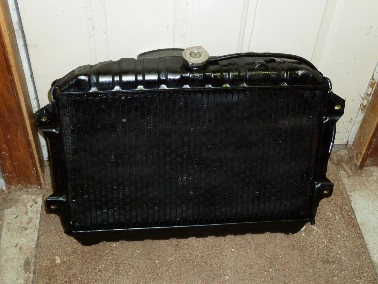

Everything seemed good. The radiator leaked a bit so I took it to a local guy who boiled it and repainted for $50.post-24497-14150815690538_thumb.jpgThe clutch slave cylinder was leaking so I replaced it, and will need to replace the master in the future. When I finally tried to turn the engine over, I got nothing, even with a good battery, so I tried to clean the contacts at the battery and the starter. Now I think my starter is shot.

Back in Indy for round two. I just installed a new starter and the car turned over for the first time. Beauty! I had to clean up the points on the distributor, charge the battery a bit more and voilá. Up and running. I let her run for a while, listening and checking temperature, oil pressure and everything seems good. The best part is that I got to do it when my father, and brother were both around so everyone was excited. I feel good now!
