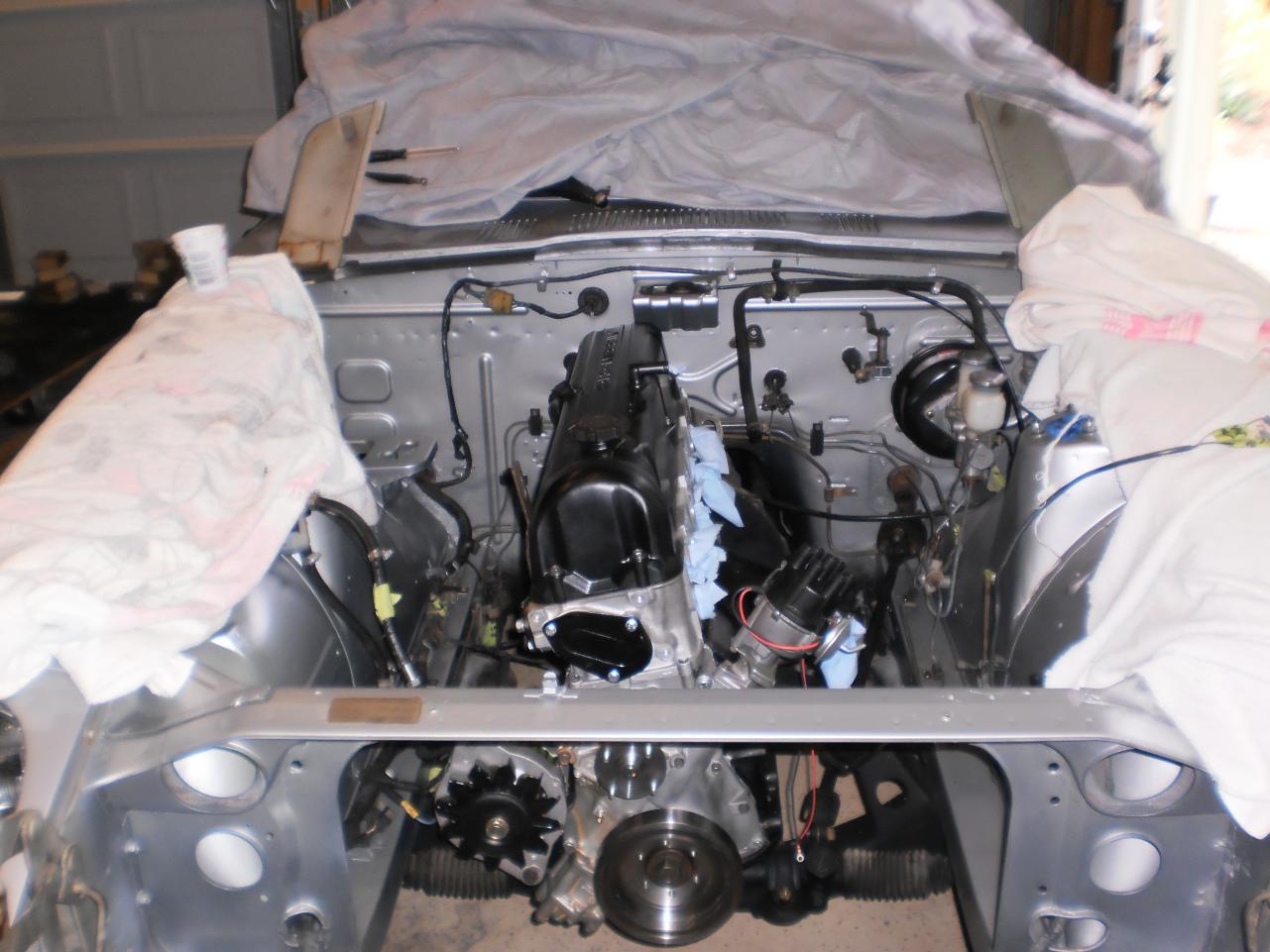

Posted June 17, 201113 yr comment_359005 Bear with me guys. First Z-car, first engine swap, finished at midnight last night. Is the engine supposed to lean that far to the passenger side, or did I mix up the engine mounts? Link to comment https://www.classiczcars.com/forums/topic/39925-is-this-engine-in-right/ Share on other sites More sharing options...
June 17, 201113 yr comment_359007 looks right, when you install your intake manifold you will see it's right. Link to comment https://www.classiczcars.com/forums/topic/39925-is-this-engine-in-right/#findComment-359007 Share on other sites More sharing options...
June 17, 201113 yr comment_359009 Yes, the lean to the passenger side is correct. I made that mistake once, swapping the mounts to make the engine straight up and down. What clued me in was the smog pump could not be installed because it was too close to the drivers side sheet metal. Link to comment https://www.classiczcars.com/forums/topic/39925-is-this-engine-in-right/#findComment-359009 Share on other sites More sharing options...
