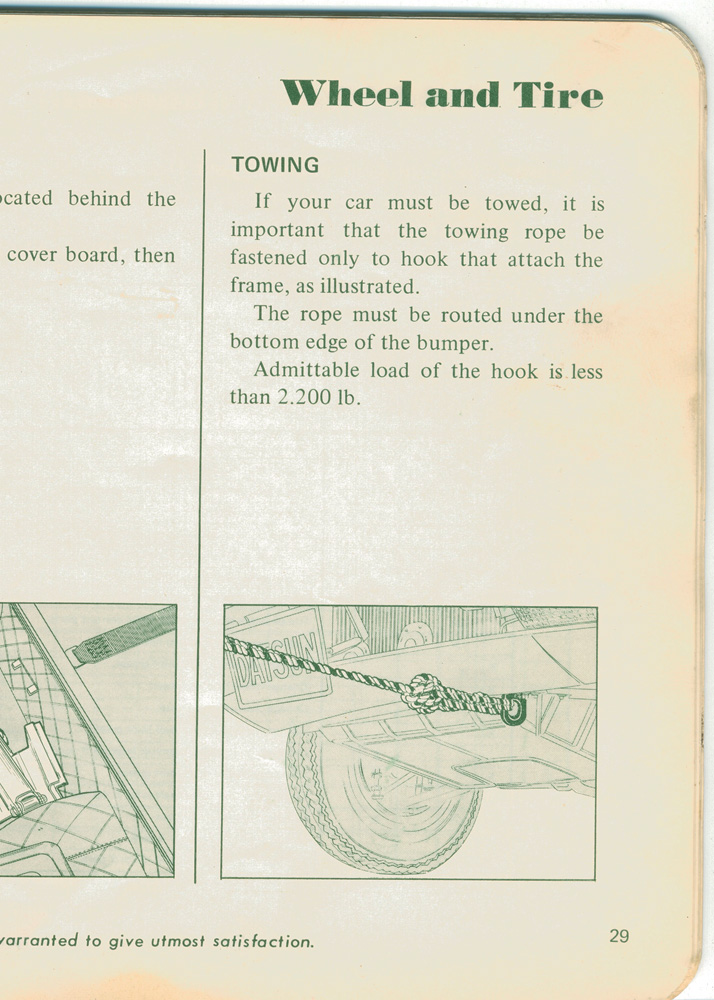

Looking over the comments to this and the other threads, I was surprised not to find this description and photograph from the factory service manual and owner's manual.
