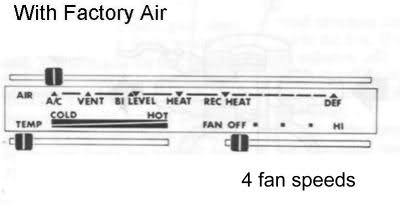

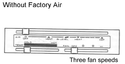

June 21, 201113 yr comment_359363 I guess that depends on who did the installation. My 78 had the so called 'dealer installed' air but they drilled round holes and even put rubber grommets in them for the drain and refrigerant lines. 280Z could be purchased with either dealer installed or factory air. One of the indicators is that the factory air has a four speed fan instead of the standard three speed and an 'A/C' position on the control panel. Edited June 21, 201113 yr by sblake01 to add attachments..... Link to comment https://www.classiczcars.com/forums/topic/39970-mystery-holes/#findComment-359363 Share on other sites More sharing options...
