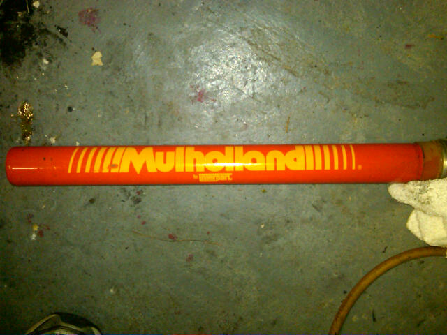

Well I got the gland nut off. I think I mentioned in one of my very first posts that from the original receipts I found from the original owner these were purchased on 2/21/79 for $144 for all 4. I think this is kind of cool! post-21670-1415081538819_thumb.jpg
