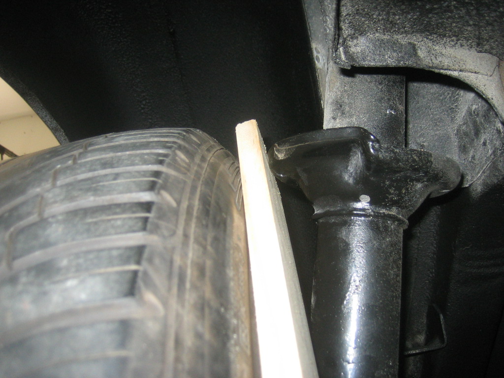

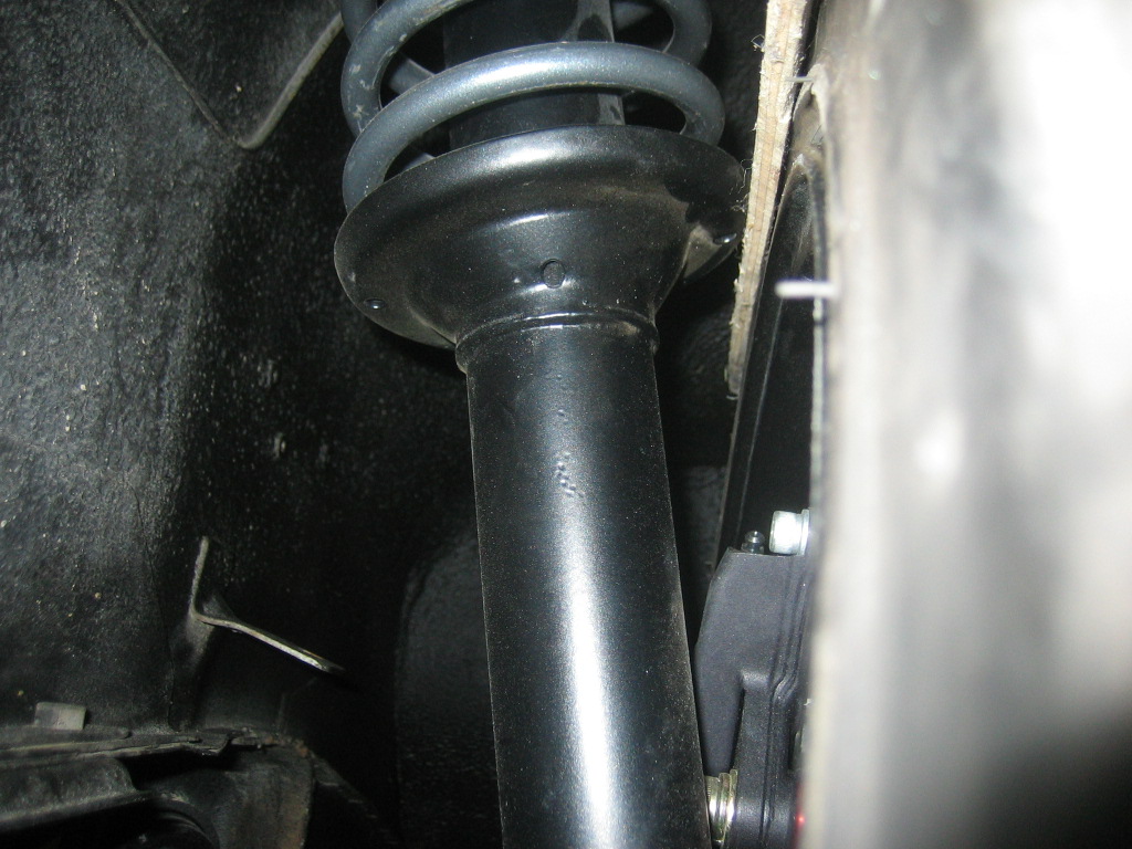

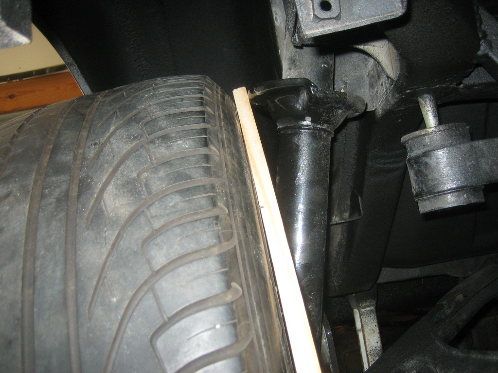

July 1, 201113 yr comment_360370 I believe I have several threads on this since I am running about that same set-up. I have 245/45/17's all the was around on 1" lowering springs-stock struts. s-30 9/71 I think on the rear you will work out perfect. I rub on the inner portion of the wheel well with my +4 offset wheels-8.5inch wheel. The +10 offset should help you clear that obstacle and there should be ample room on the perch--BUT this is on my 17" wheel set-up,sssoooooo it could be different. The fronts are going to be an issue. The +10 will put you right aginst the perch. I had to flatten the perch on one side for the tire to clear. It gave me 1/4" of clearance. You can gain a 1/4 to a half inch by flattening the perch because the springs have that much slop in the perch. You might need a spacer to get you off the perch. This a VERY tight fit with 245's, but looks bad as hell. Again, my car has 17" wheels, so it could be different for you. Also, I am in the process of slotting my rear towers to bring my camber in to clear the wheel well and it is working out well so far. I slotted the strut holes by 1/4" and it helped tremendously and my camber is still only 3/4 degree negative. Hope that helps. I believe I have a whole thread with pictures on Hybridz Link to comment https://www.classiczcars.com/forums/topic/40071-looking-for-issues-with-fitment/#findComment-360370 Share on other sites More sharing options...

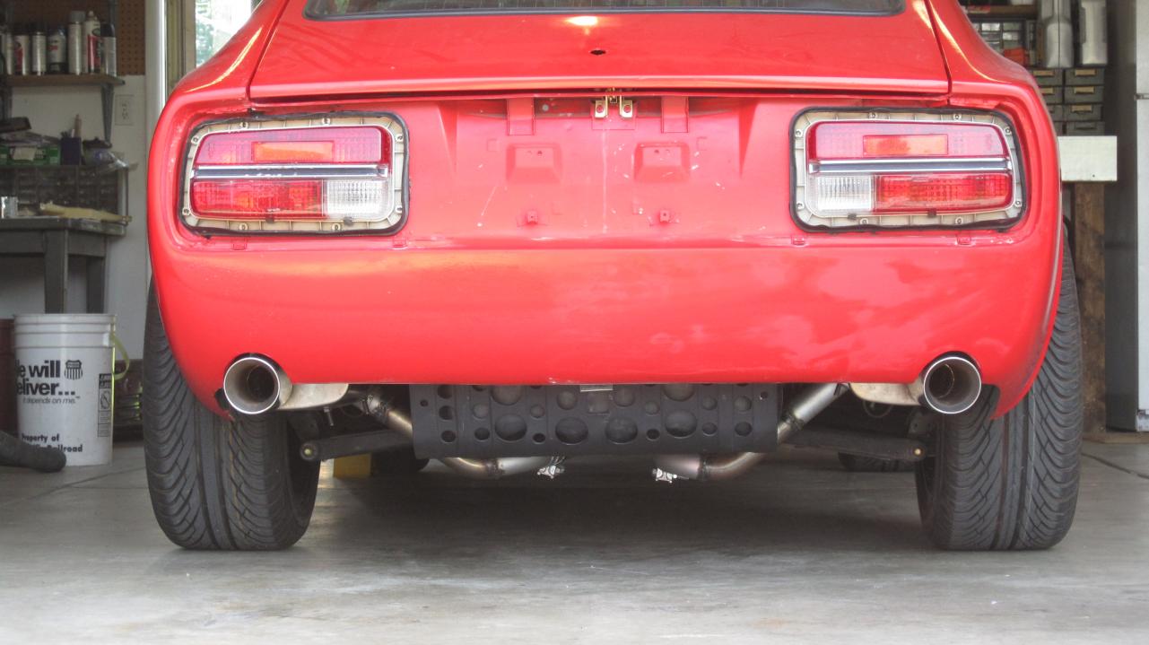

July 1, 201113 yr comment_360372 Another pic from the rear Link to comment https://www.classiczcars.com/forums/topic/40071-looking-for-issues-with-fitment/#findComment-360372 Share on other sites More sharing options...
