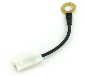

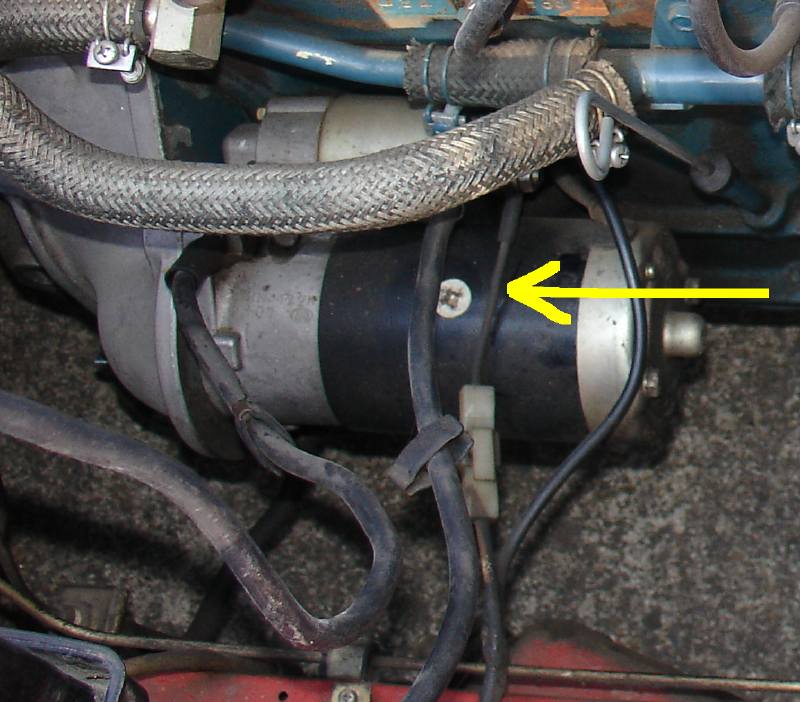

July 4, 201113 yr comment_360655 The fusible link for a 72 Z is between the Starter's POSITIVE Batterty connection and the wiring harness. You should be able to see it below the battery going to the wiring harness on the side of the engine bay. As far as I know, there is only ONE fusible link in the 72's. If your car has the Intermittent Wiper (4 stops on the Comb Sw. ON-INT-LO-HI) then your car has 73 wiring and not 72. Check the connections at the battery, make sure you've cleaned the clamps and posts, also the grounds. You've added grounds and changed components, that's all good, just make sure everything is proper. Is the V/R mounted on the firewall or is it floating loose? How about the Amp Gauge? Good connections there? Also, I remember reading about another Z's Alternator NOT putting out proper voltage unless a certain RPM was maintained, are you idling or are you checking at higher RPM's? Are you making all these checks with all electrical systems off? How about your battery, is it fully charged? A "new" battery oftentimes needs a good external charger to bring it up to voltage, your Alternator will normally re-charge what you take out, but it takes forever to bring a Battery up to full voltage. FWIW E Link to comment https://www.classiczcars.com/forums/topic/40086-no-charging-from-alt-1972-z/?&page=2#findComment-360655 Share on other sites More sharing options...
