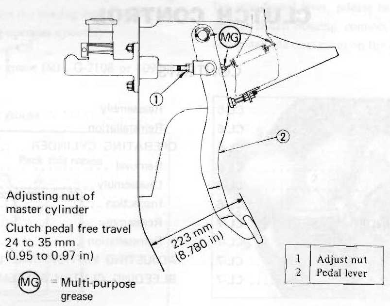

I just replazced the clutch preasureplate and bearing on my 1974 260z. It now grabs very close to the top on the clutch pedal travel. How can I adjust the pedal so the clutch grabs a little closer to the floor

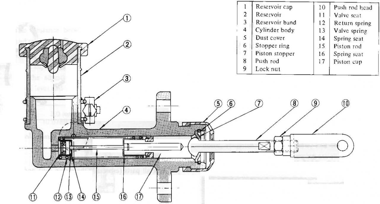

Step 4 - (I prefer using a pick with a hook end for this.) Remove the cotter key from the clevis pin that holds the clutch pedal to the push rod head on the clutch MC.
Step 5 - Remove the clevis pin. (Note: Make sure you leave these parts some place where you can find them later.)
Step 6 - Loosen or remove (I can't remember if you can get away with just loosening the bolts.) the bolts that hold the clutch MC to the firewall.
Step 7 - Move the lock nut on the clutch MC push rod toward the reservoir. You shouldn't have to move it too far.
Step 8 - Move the push rod head to butt up against the lock nut.
Step 9 - Align the push rod head and the clutch pedal so you can put in the clevis pin.
Step 10 - Get some of that cold beverage because you've probably worked up a sweat.
Step 11 - Tighten the clutch MC to the firewall.
Step 12 - Test travel of clutch pedal. DO NOT TAKE THE CAR FOR A DRIVE, YET.
Step 13 - Readjust the pedal if necessary.
Step 14 - After getting pedal to your liking, put the cotter key back in the clevis pin.
