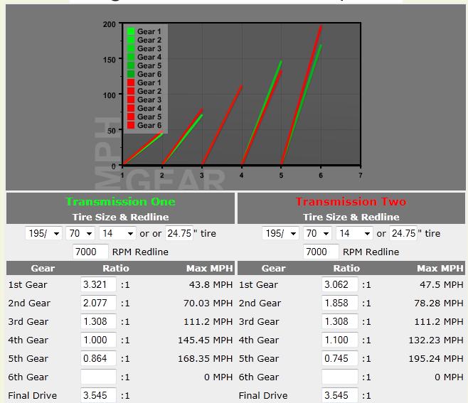

[ATTACH=CONFIG]46701[/ATTACH]
found a neat tool for this kind of thing, this new trans looks like the way to go.
Now for that 4.11 lsd...
I've seen a similar tool but it doesn't plot the numbers. Is that one available on the web?
There is something odd about your attached picture though. Maybe you didn't redraw after putting in new numbers. 3rd gear plots the same line but 4th gear doesn't even though the values are the same for 3rd and 4th, between the two transmissions.
Anyway, I wouldn't mind a link to the site if you have it.
