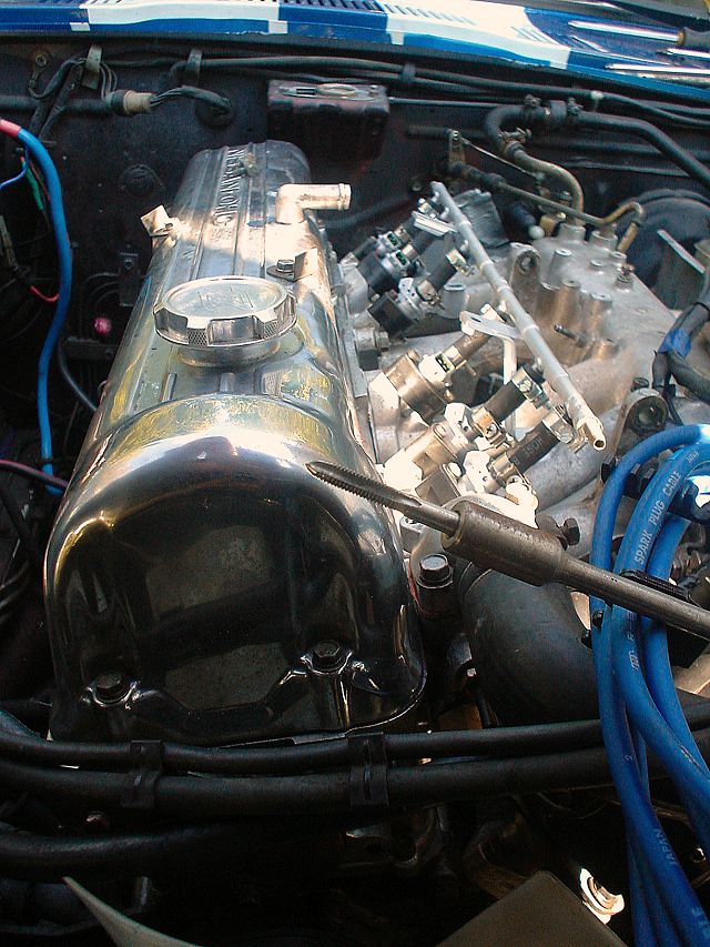

July 16, 201113 yr comment_361651 I also cut and reworked my "bugle" shaped rail into a straight line. I am not sure if it will help but it holds less fuel and has less surface area than the original thus it may clear faster and absorb less heat. Edited July 16, 201113 yr by Blue Link to comment https://www.classiczcars.com/forums/topic/40207-not-your-typical-hot-start-issue-suggestions-needed/?&page=2#findComment-361651 Share on other sites More sharing options...
