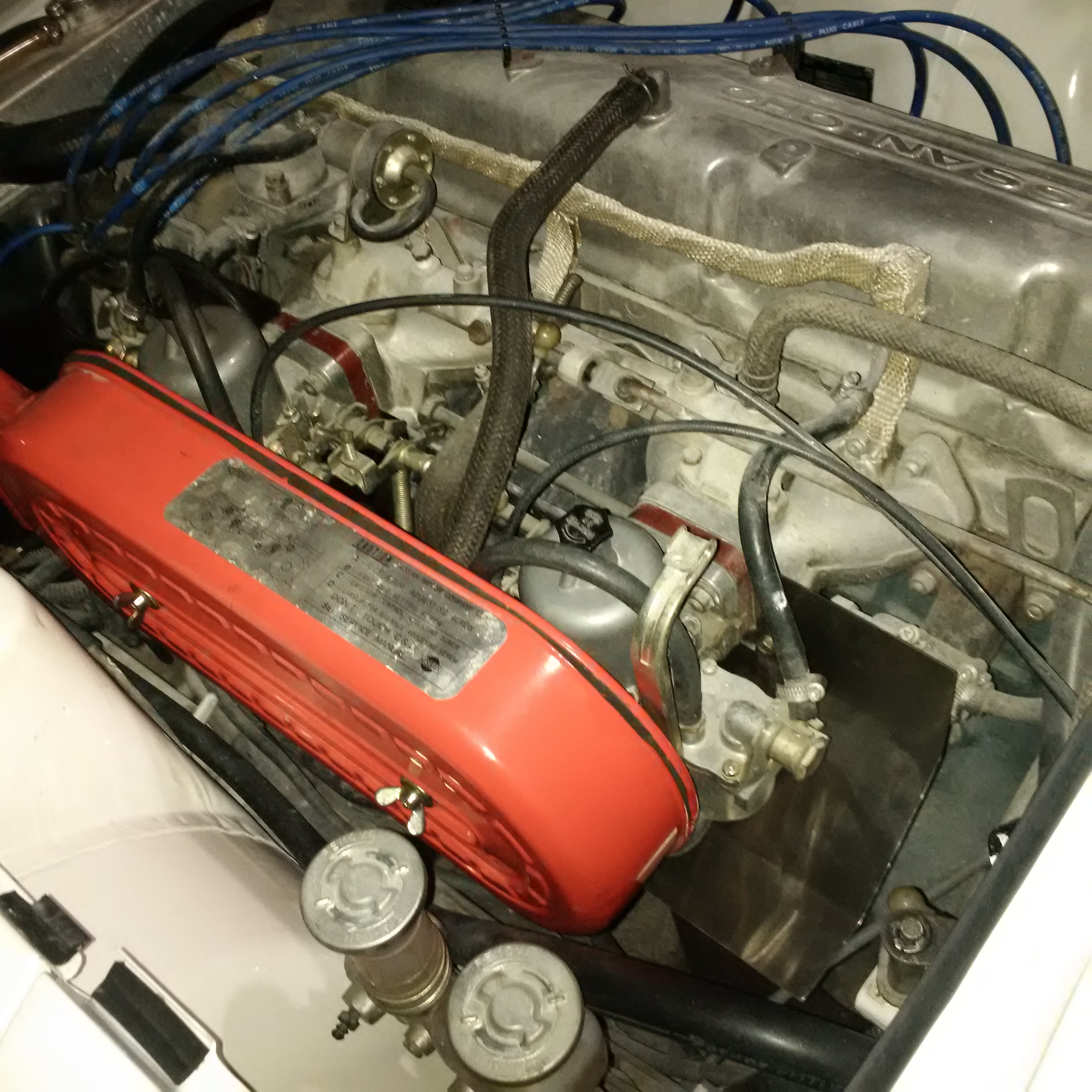

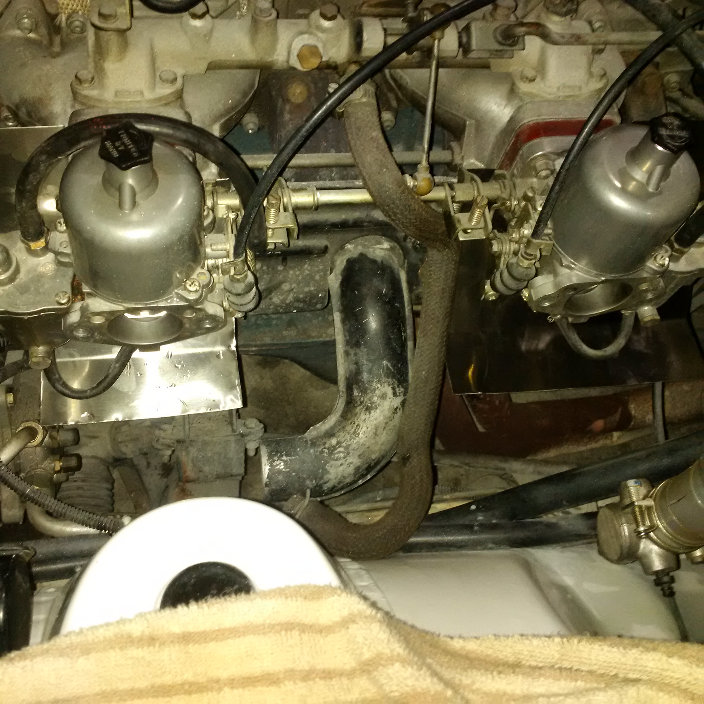

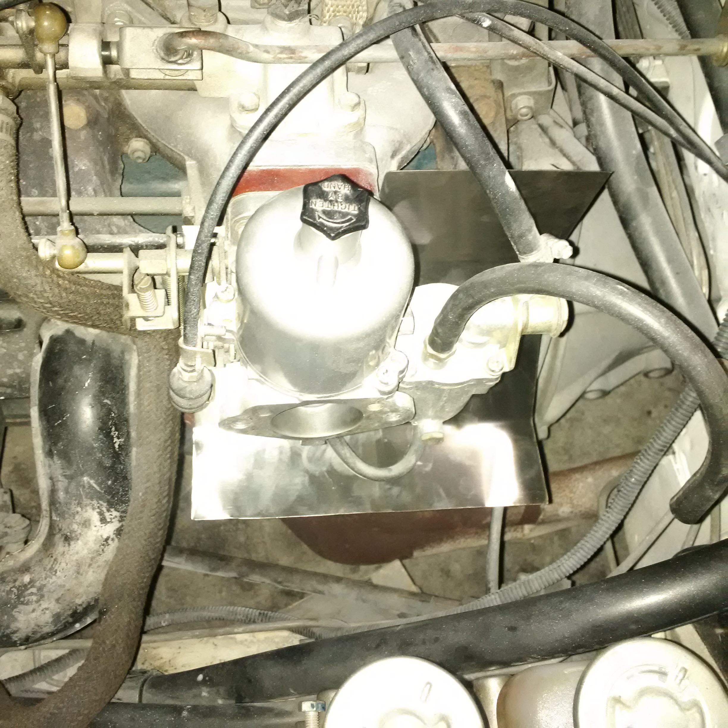

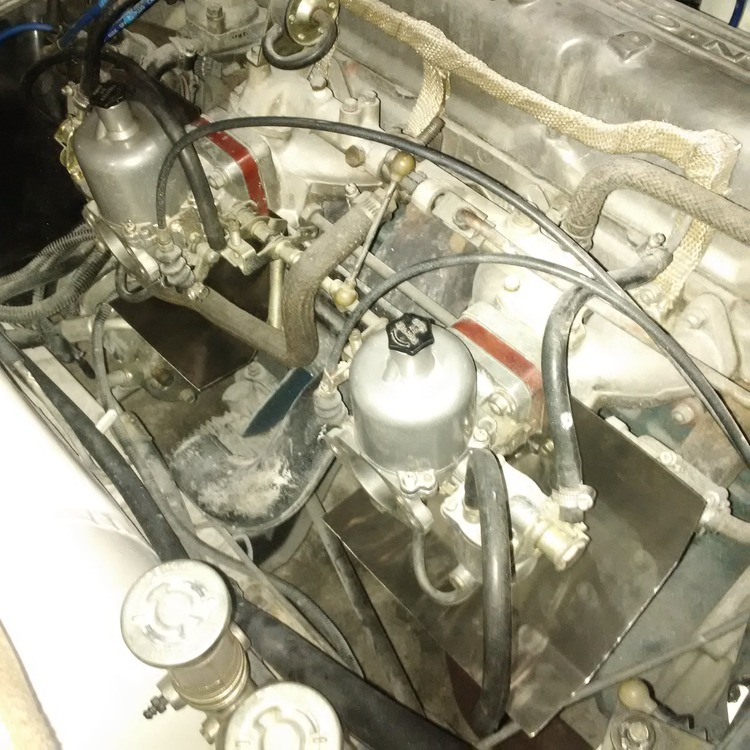

September 6, 20168 yr comment_502615 Well last night i intalled a couple of heat shield extensions which isolate the float bowls of each of my Round top SU Carbs. It seems to have lowered the temperature! Any other recommendations?? swapping the fan clutch with 2 electric fans? removing the fuel rail and replacing it with a modern type with other type of gasoline hoses (AN1) as the picture attached??? My fuel pressure is at 4.3 to 4.5 psi. Link to comment https://www.classiczcars.com/forums/topic/40289-vapor-lock-questions-for-the-hotter-climate-guys/?&page=10#findComment-502615 Share on other sites More sharing options...
September 6, 20168 yr comment_502620 After struggling with heat related issues while racing for several years, I finally ditched the steel OE fuel rail and the problem was solved. Â I had tried every type of heat shielding with no luck. Â In the end, I believe that the heat was coming through the steel rail mounts and into the rail. Â The insulation on the rail did a great job of holding the heat in. Â Once I went to an all-rubber supply, I have no issues. Link to comment https://www.classiczcars.com/forums/topic/40289-vapor-lock-questions-for-the-hotter-climate-guys/?&page=10#findComment-502620 Share on other sites More sharing options...
