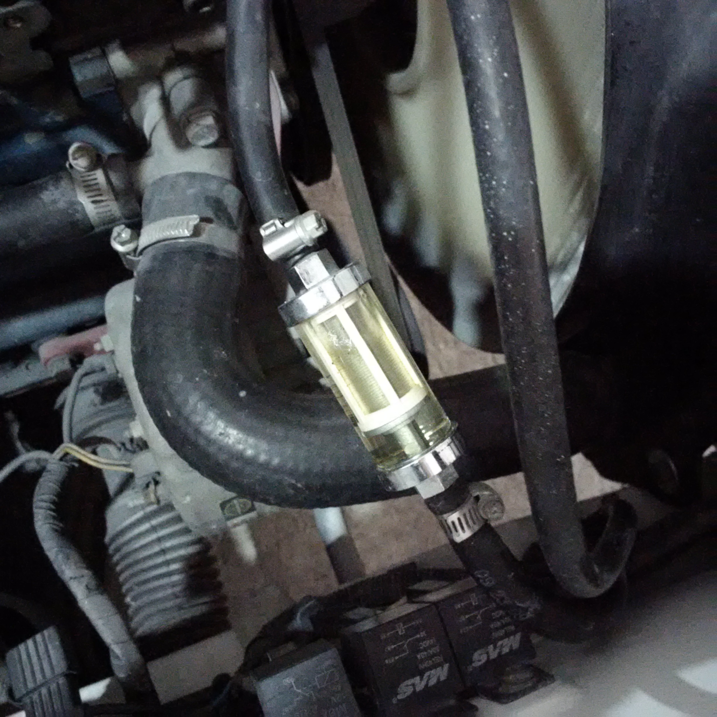

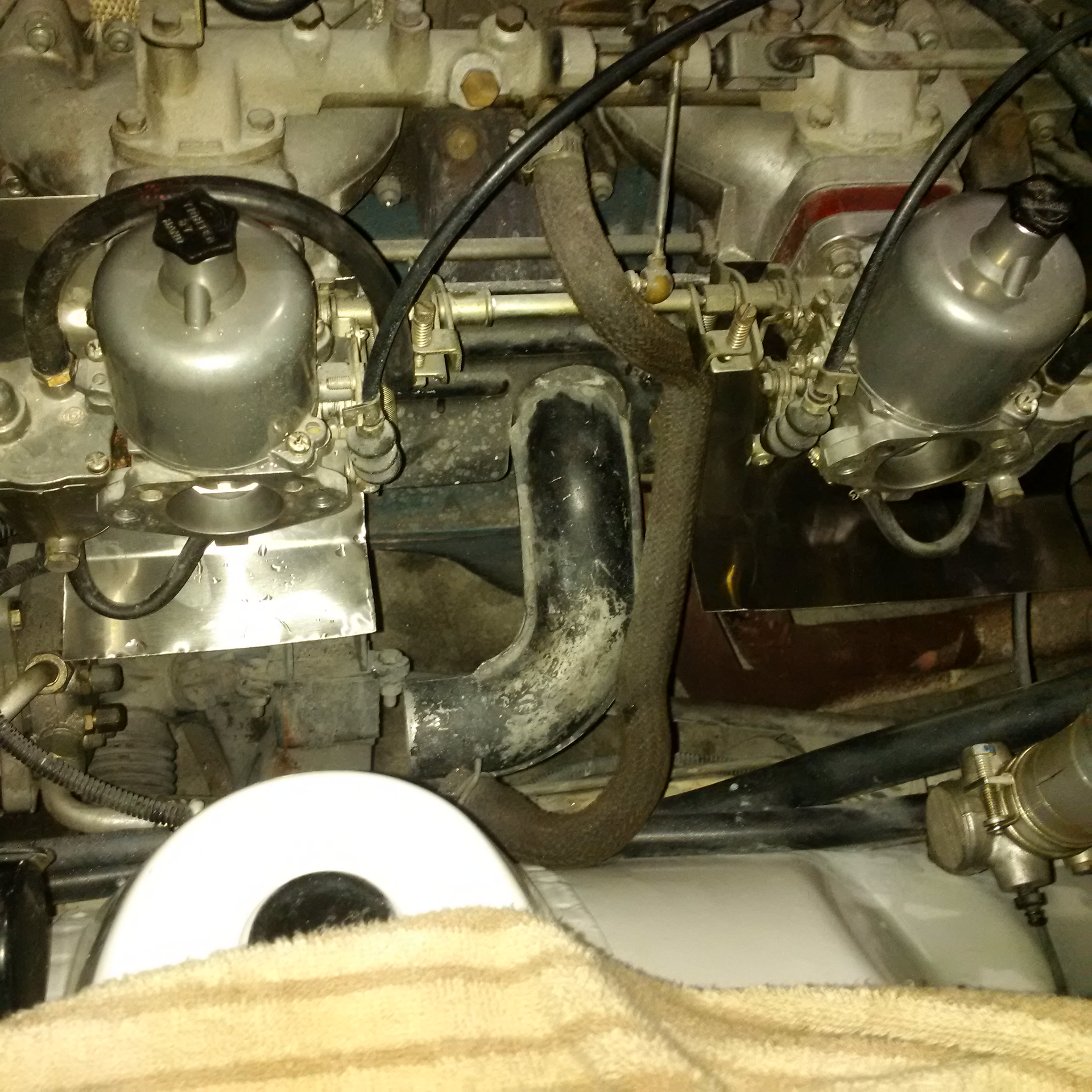

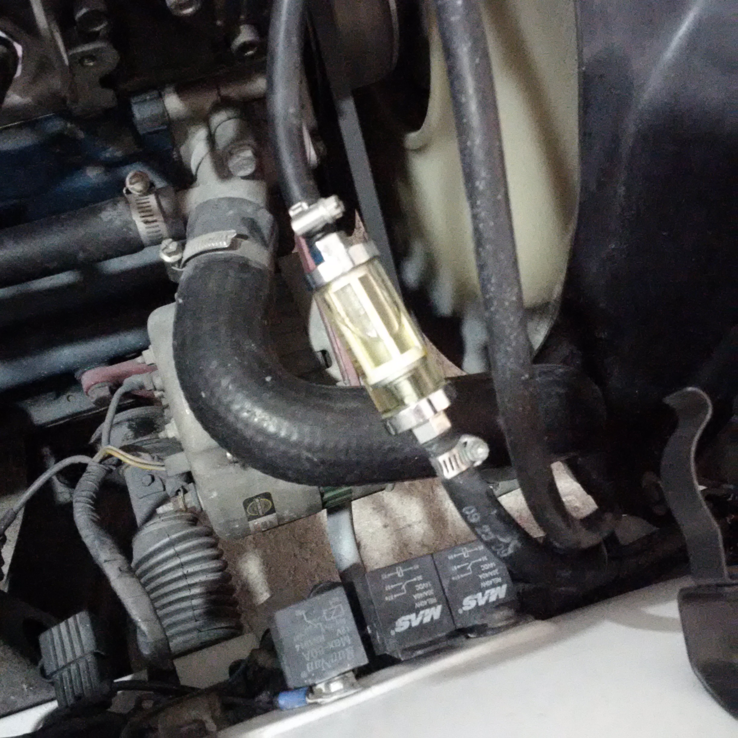

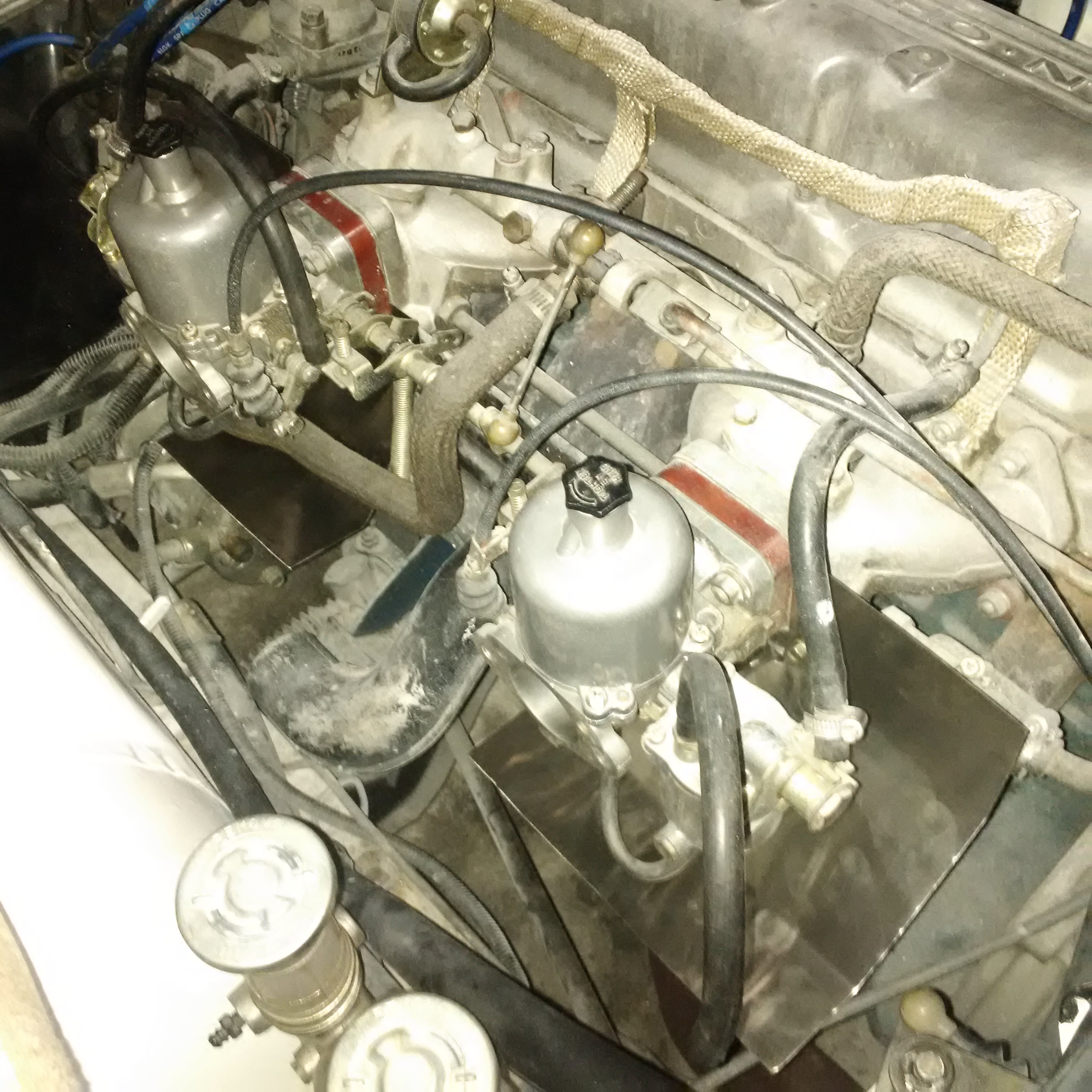

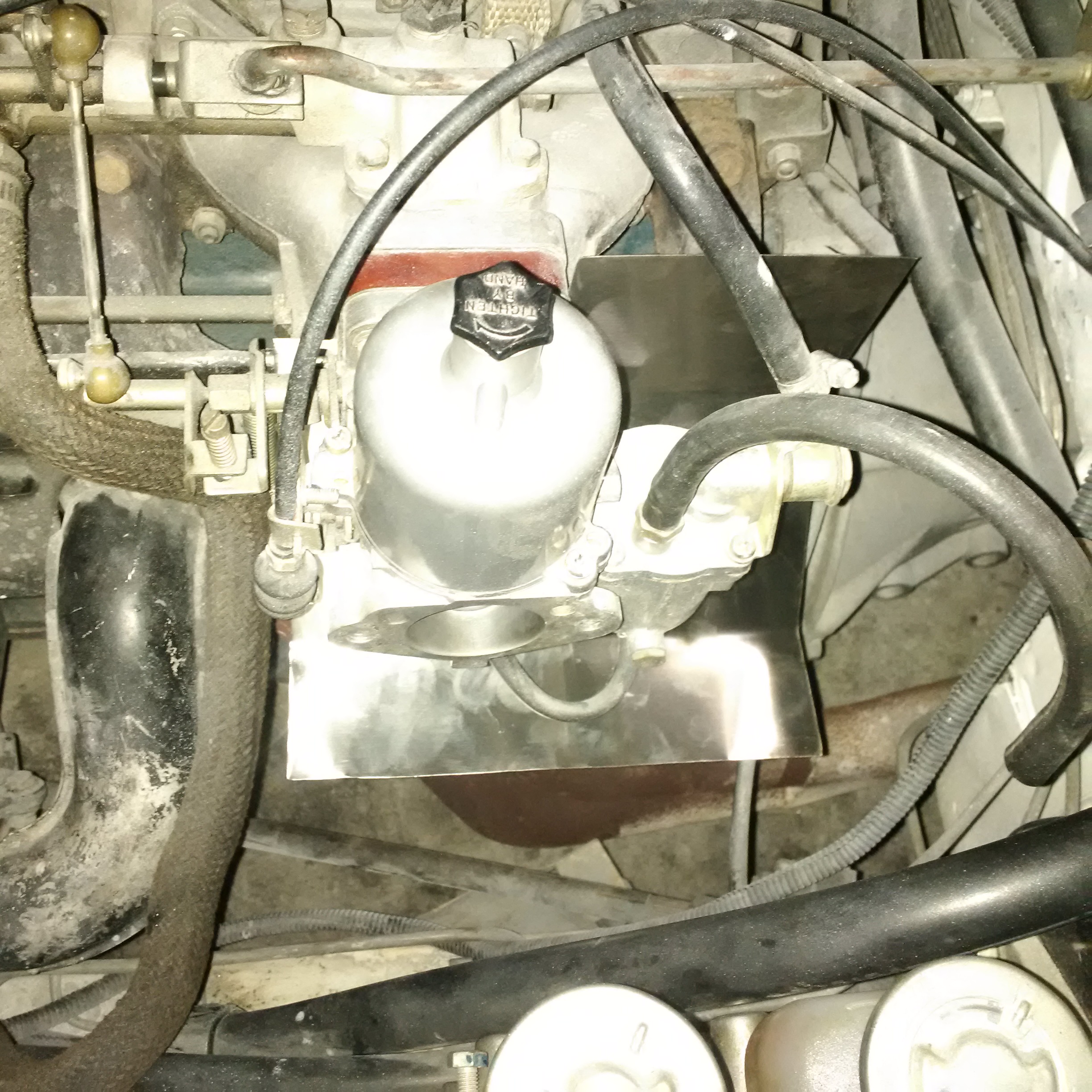

After getting caught on traffic, couple of traffic lights and other stops, the car idle started to drop randomly from 900  to 200 rpm, however it never stalled. This means the heat shields i installed are helping get the heat out as its avoiding the fuel to evaporate at the fuel bowls. I parked the car and opened the engine door so heat started to get out. i took one picture of the fuel filter once i opened the engine bay and took another one after a couple of minutes running the car parked in idle. the rpm started to become stable at 800 to 900 rpm and did not dropped. So i think i still need to move forward and swap the metal fuel line with a modern approach rubber hose. I would like your opinión on this. I want to feel secure if i get stuck in traffic and tackle this issue which is surely VAPOR LOCK and nothing else! I even took out all the spark plugs and they were all fouled. I will not drive the car with the front Hood open, there must be a solution to get the heat out at traffic jams.

Sounds more like percolation, I think.  Basically, fuel getting too hot in the carbs and forcing/finding its way out unmetered, adding extra fuel, I believe.  Still heat-related, so the rubber lines Jeff G described should help.  Progress!
