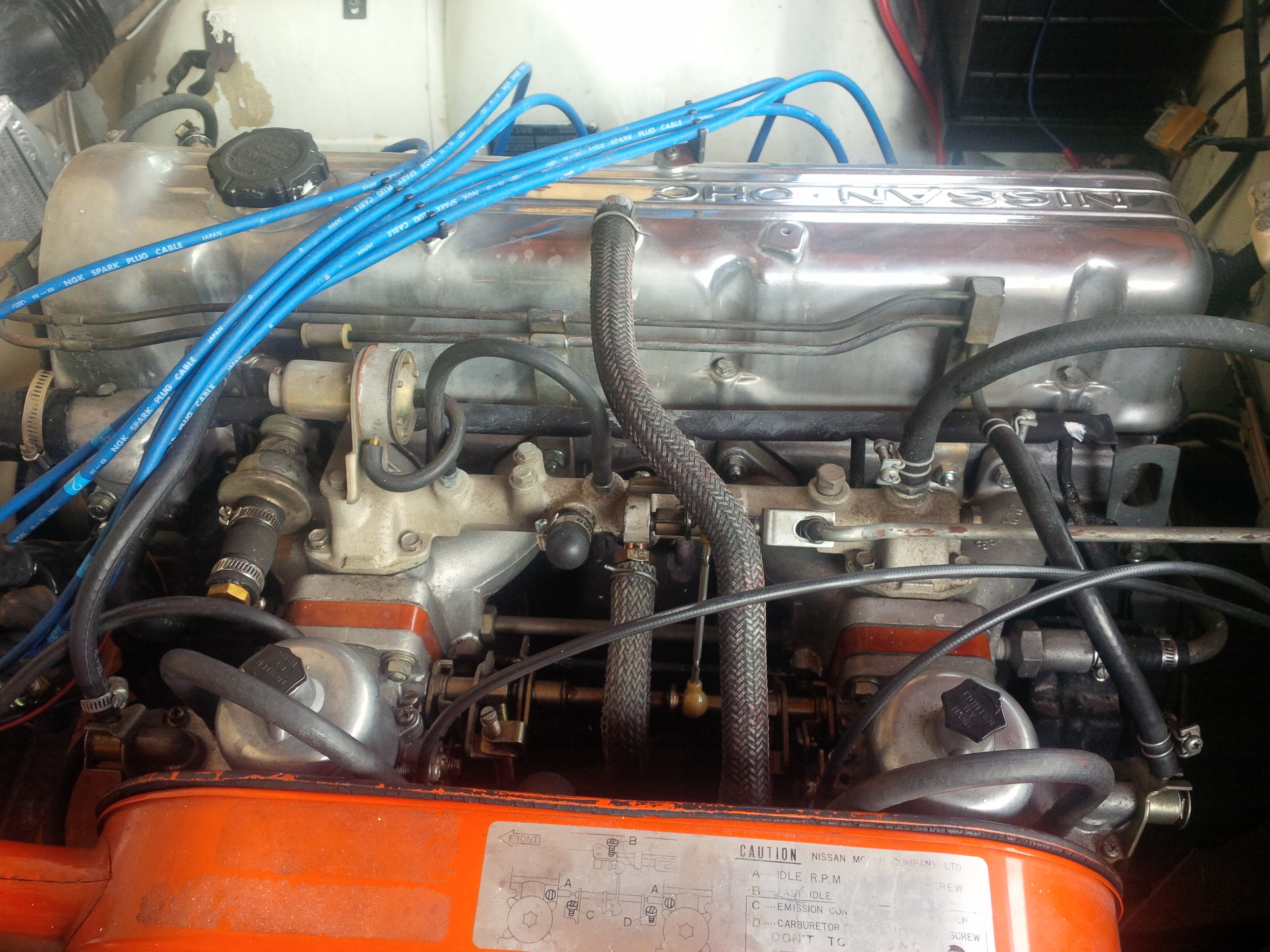

well down here in Panama we are still trying to figure out this percolation or vapor lock issue. Stuck in traffic, car starts to stumble lowering rpms from 900 to 700 back and forth and when engine heat rises falls to 200 rpm. Park the car, open the Hood, pull the plugs and all came out black sooty. Its weird that even after installing heat shield extensions covering the fuel bowls of both SU Carbs i am still having this issue. Its really uncomfortable to drive this way on traffic. No mechanic has been able to find a  solution!!!!!

Everyone told you to do this.  Did you do it yet?!  Nothing will change until you change something!
So, excessive heat in the engine bay causes rich condition fouling the plugs ? Can anyone explain that ? Because I don't get it at all, and I'm trying to learn something here.
Vapor lock plus fouled plugs would make a crappy driving experience, but it's possible to have two or more unrelated problems at the same time.
I remember posting a suggestion to get a synchrometer or unisync and set the mix with it, following the procedure in the FSM exactly. If you did that, at least carb settings can't have anything to do with the problem.
I won't argue with the book.
And regarding the AN fittings, I was sort of trying to discourage you from doing that in my previous post. Sorry, but it's more a nice, but time-consuming "finishing touch" kind of project for a Z car, than a solution for the vapor lock problem. A skilled technician with the right tools and experience building AN hose systems wouldn't have a problem (except maybe finding the right banjo bolts to fit the SU's), but it would be quite a project for anyone else. Why not just use good fuel hoses and clamps ? Way easier in my opinion, and just as good for keeping fuel lines away from heat sources. You could actually get the hoses, clamps, tee fitting, etc. installed yourself and be back on the road in a day or two.
If you're too in love with the AN idea (I agree it would look cool) find the banjo bolts first. That will probably take a month. Also look up or measure all the fittings, getting correct hose sizes, lengths, and thread types for your project(another month). Then go to a place that makes hoses (for trucking, industrial, HVAC, race cars, etc.) and have them cut the hoses and install the fittings and adapters (20 minutes). Then install it yourself and you're done.
