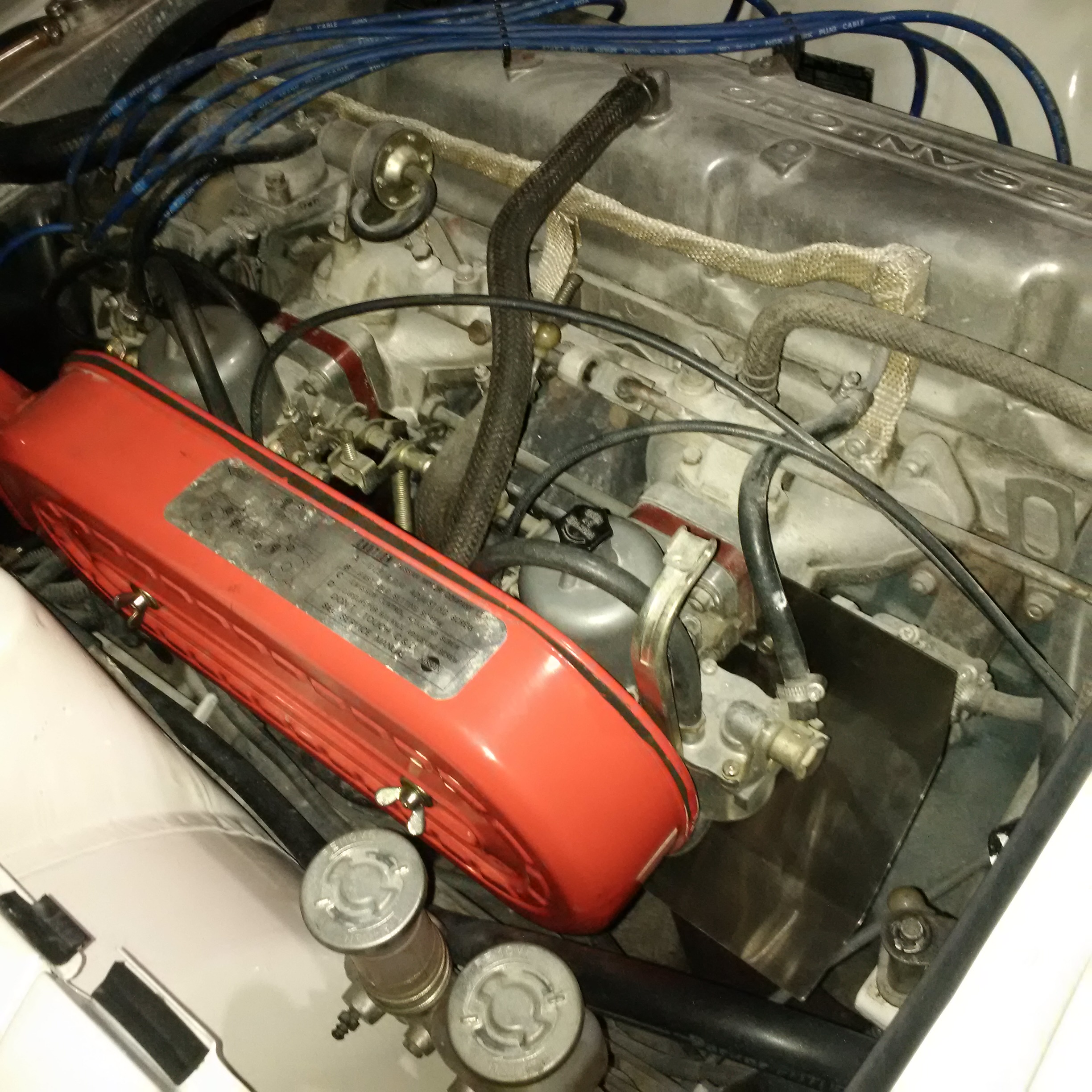

October 24, 20168 yr comment_505468 I guess i will just then first try with good fuel hoses and clamps! Also i forget to mention i did lower the fuel mixture to 3 turns each carb approximately. Ill try the vehicle tonight and if the problema still continues then remove the fuel rail and try with a good fuel hose. its weird since i wrapped the fuel rail with isolation cloth! Edited October 24, 20168 yr by jalexquijano Link to comment https://www.classiczcars.com/forums/topic/40289-vapor-lock-questions-for-the-hotter-climate-guys/?&page=15#findComment-505468 Share on other sites More sharing options...
October 24, 20168 yr comment_505481 that cloth is a double edged sword. it can also keep the fuel hot Link to comment https://www.classiczcars.com/forums/topic/40289-vapor-lock-questions-for-the-hotter-climate-guys/?&page=15#findComment-505481 Share on other sites More sharing options...

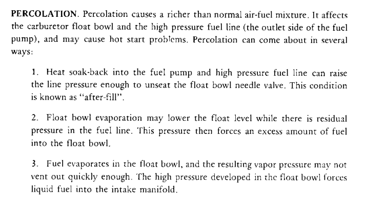

October 24, 20168 yr comment_505485 18 hours ago, Zed Head said: The image attached is how Nissan explained it, in their 73-74 Fuel system Modification Plus manual. Many ways of saying the same thing. Too much fuel in the bowl, getting the static level above the bridge height, causes raw fuel to be siphoned into the carb venturi. How the bowl gets too full can only be from pressure that forces the needle valve open. The argument that evap empties the bowl some, opening the needle valve, which allows fuel in to over fill is silly. The float would rise and stop it from exceeding normal height, unless, again, the inlet pressure was above the needle seat hold pressure. Simple test to put the old external fuel level indicator on the drain plug, get it hot, turn it off, and watch the level in the bowl. Also a pressure gauge on the line after/pump pre-carb would show you if it does get "high" enough to force the needle seat. If none of that is going on, then it's something BLOCKING flow into the bowls preventing the car from starting (ie too lean, way way too lean, like none!). This could only happen if evolved (boiled gaseous gasoline) in the line sits in a high spot blocking liquid fuel flow. Again, float level indicator would show an EMPTY bowl not refilling during cranking during attempted restart. Line pressure gauge would read very low or no pressure. Finding the cause of your problem is a matter of careful and methodical testing. Link to comment https://www.classiczcars.com/forums/topic/40289-vapor-lock-questions-for-the-hotter-climate-guys/?&page=15#findComment-505485 Share on other sites More sharing options...
October 24, 20168 yr comment_505488 My mental summary ends up at "hot carb boils or vaporizes fuel in bowls, boiling fuel leaves via jets, unmetered". The basic principle of the carb's float bowl is a placid calm pool of fuel pushed in a controlled fashion through precisely sized orifices. Bubbling, vaporizing, recondensing fuel screws everything up. But the basic idea of all of these things and Nissan's obvious work, and their modifications, and writing up a whole book about it, and attempts to explain the concepts is "heat is bad for the carbs, avoid heat". That's the message, I'd say. Remove and avoid heat transfer to the carbs. Heat is bad. Heat is the enemy. See a path for heat to get to the carbs - remove it. Is more testing necessary? Heat, heat, heat, heat... Just joking around. Seriously though - the key is to remove the things that transfer heat to the carbs. Link to comment https://www.classiczcars.com/forums/topic/40289-vapor-lock-questions-for-the-hotter-climate-guys/?&page=15#findComment-505488 Share on other sites More sharing options...
