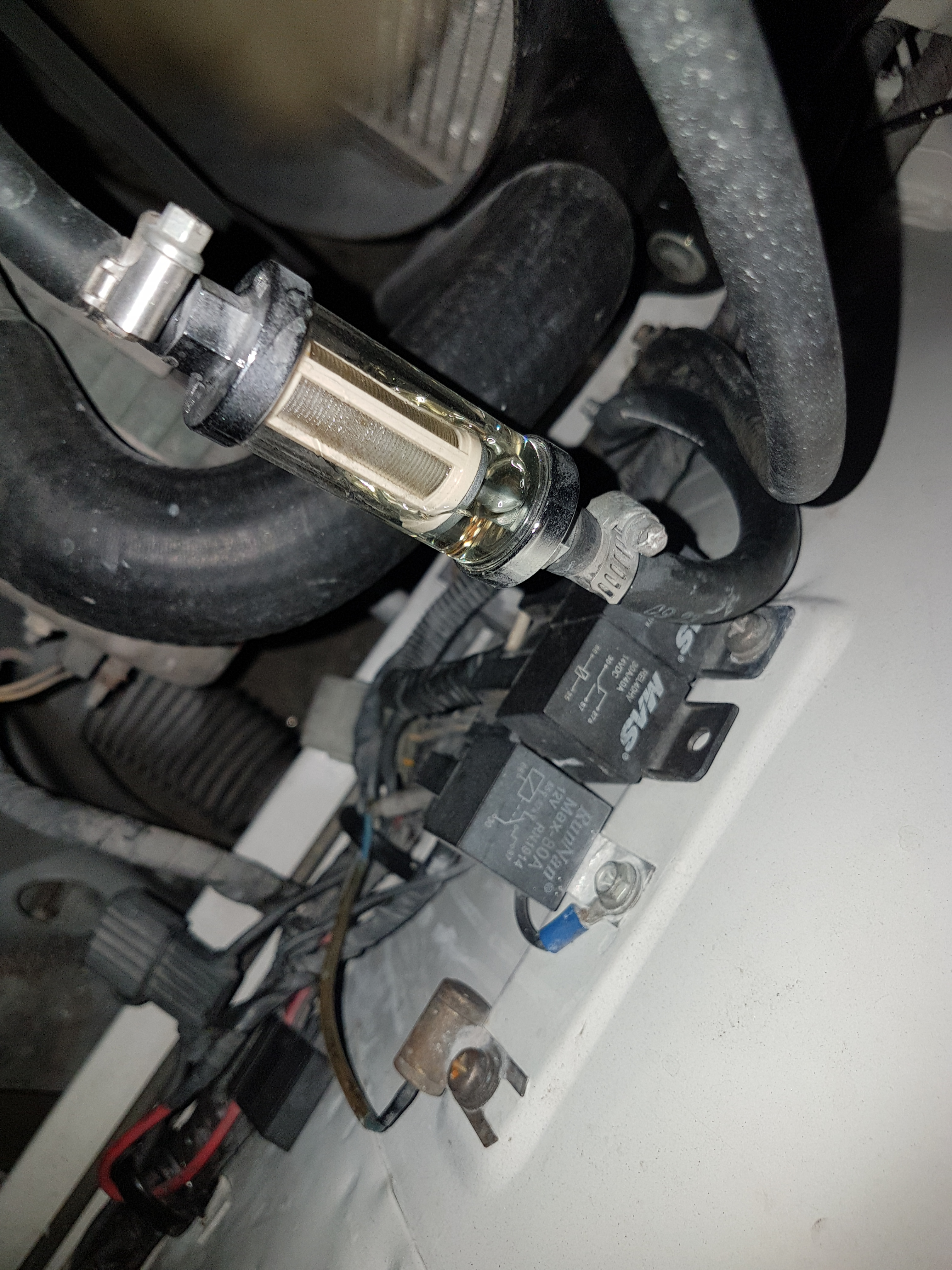

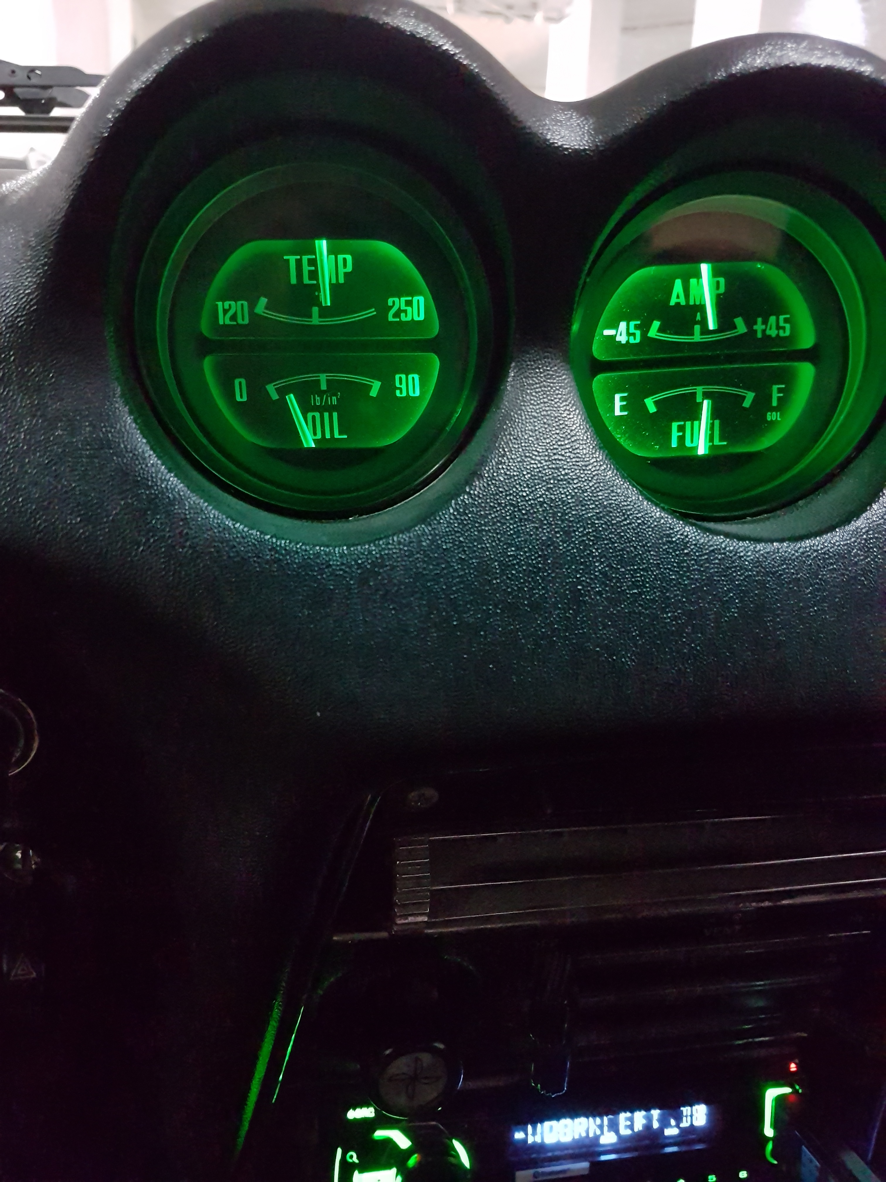

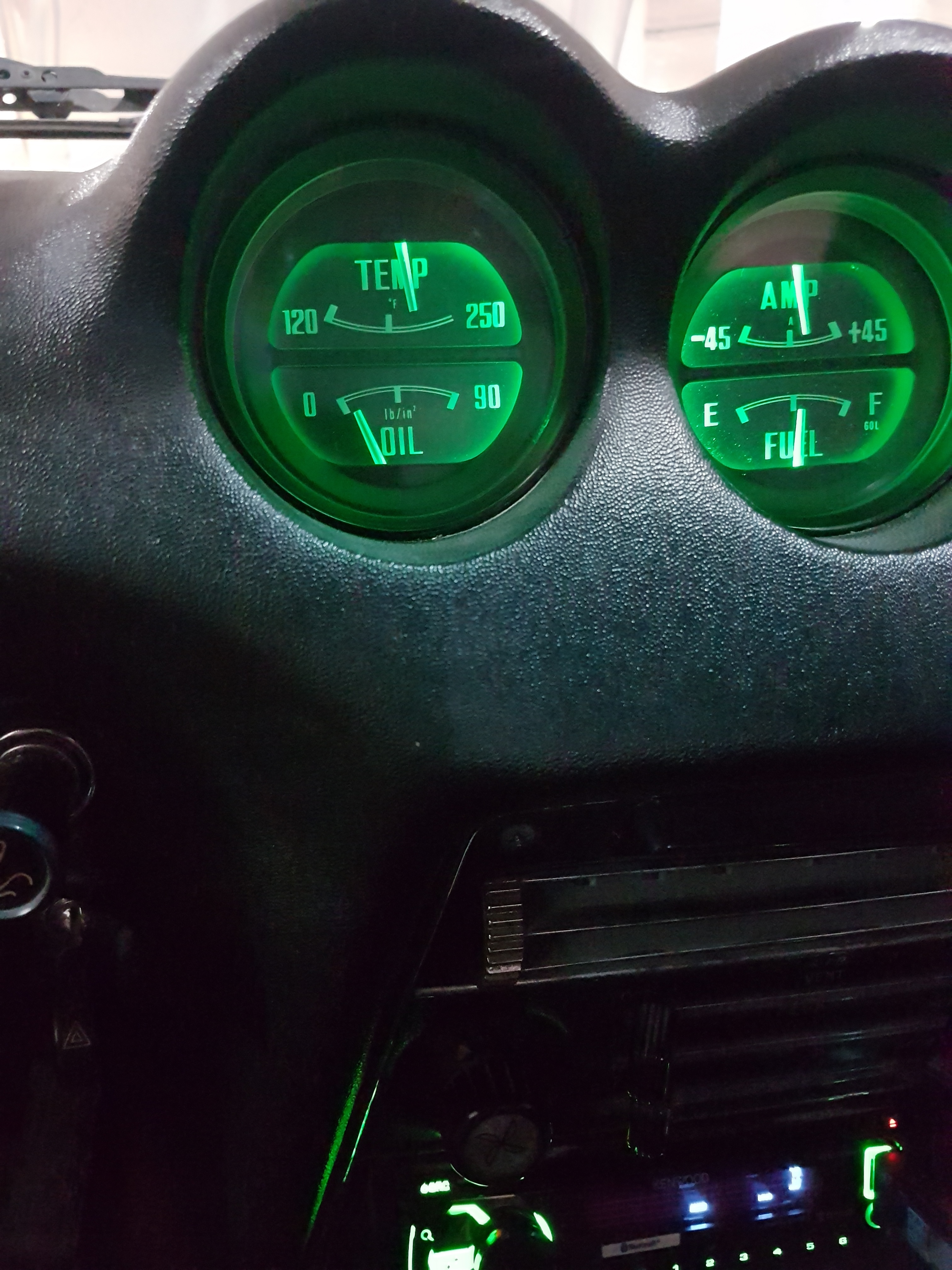

December 19, 20168 yr comment_508402 problem was low coolant. I went and bought a gallon of coolant until i reached to the level of the filler. Temperature mantains at 1/2 while driving but increases until 3/4 at idle with lights on and AC on. I also noticed that after leaving it on idle for more than 15 minutes, rpm dropped randomly from 900 to 600 RPM. However, engine did not stalled. There are some bubbles on the glass fuel filter. Edited December 19, 20168 yr by jalexquijano Link to comment https://www.classiczcars.com/forums/topic/40289-vapor-lock-questions-for-the-hotter-climate-guys/?&page=21#findComment-508402 Share on other sites More sharing options...
December 19, 20168 yr comment_508445 I took some pictures and left the car idling for 15 minutes. Engine still drops rpm to 500 randomly but does not shut off. Once i opened the engine bay. i saw some bubbles on the glass fuel filter. A friend of mine thinks the car needs valve adjustment on cold so the idle gets less lumpy. Link to comment https://www.classiczcars.com/forums/topic/40289-vapor-lock-questions-for-the-hotter-climate-guys/?&page=21#findComment-508445 Share on other sites More sharing options...
December 19, 20168 yr comment_508446 A bunch of coolant came out while the mechanic was messing with the hoses and he didn't bother to refill it ? Wow what a kook ! Notice that the earlier photo posted of the passenger side of the engine shows shows a short piece of hose with plugged end (why is the clamp on the end turned so you can't tighten it ?), but the later photo shows the side hose connected with the heater capped? Not that it makes a difference. Don't use those rubber caps, they deteriorate and fall apart quickly from the heat. Use a tapered rubber plug tapped into the tube instead, and clamp a silicon cap (mcmaster-carr) over it, OK? Cooling system uses all BSPT fittings. Use NPT and you'll bugger the threads. If you're ok with that, fine, if it doesn't leak. Temp gauge looks ok in the last picture of it. Link to comment https://www.classiczcars.com/forums/topic/40289-vapor-lock-questions-for-the-hotter-climate-guys/?&page=21#findComment-508446 Share on other sites More sharing options...

December 19, 20168 yr comment_508470 3 hours ago, Stanley said: And go to local Nissan parts department and get a real Nissan thermostat for it. Which thermostat? I need the one for tropical hot weather! I took some pictures and left the car idling for 15 minutes. Engine still drops rpm to 500 randomly but does not shut off. Once i opened the engine bay. i saw some bubbles on the glass fuel filter. A friend of mine thinks the car needs valve adjustment on cold so the idle gets less lumpy. Link to comment https://www.classiczcars.com/forums/topic/40289-vapor-lock-questions-for-the-hotter-climate-guys/?&page=21#findComment-508470 Share on other sites More sharing options...
