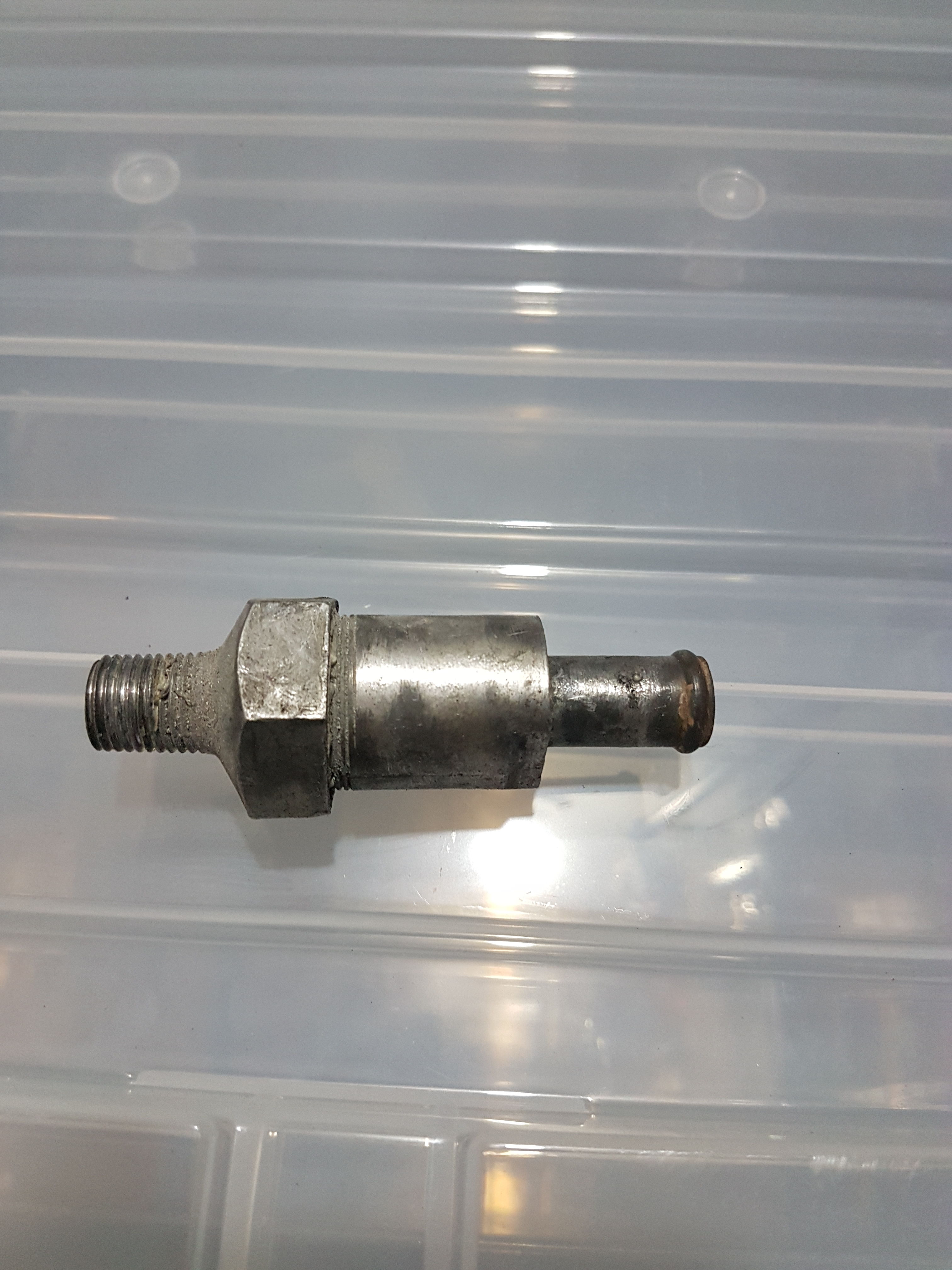

After removing the Heat Control thermostat which i really dont know if it was shut or not  and hard line from the circuit, i am still experiencing sudden rpm drop from 900 to 500. Is there any posible way of keeping the rpm stable at 900? My car has a Schneider 274F camshaft and not the original one. Could this be the reason?? The car is not stalling but this sudden rpm fluctuation feels unconfortable when driving and getting stuck in traffic jams.

 Need a few more puzzle pieces. When the idle drops to 500, and assuming you instinctively hit the throttle to compensate, is there any stumble or hesitation? Also assuming that you revved the engine to compensate and let it fall back to an idle, did the idle return to 900, even temporarily or did the idle go back to 500?
You can test your thermostat by putting it in a pan of water along with a cooking thermometer and heating it to see if it opens at the proper temperature.
