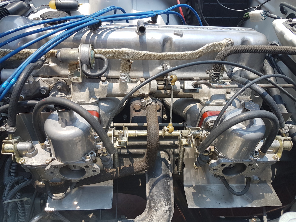

May 3, 20177 yr comment_519833 On 10/05/2016 at 3:33 PM, Zed Head said: Sounds more like percolation, I think. Basically, fuel getting too hot in the carbs and forcing/finding its way out unmetered, adding extra fuel, I believe. Still heat-related, so the rubber lines Jeff G described should help. Progress! It's been discussed before, part of the saga. Might even be in previous pages of this thread. Here's Nissan's take on it. - http://xenonzcar.com/s30/files/1973 240z 1974 260z fuel system modifications.pdf That document is on the CZCC site also - This is correct. What i am getting is fuel percolation at both carbs. I even replaced the fuel rail with rubber hoses this weekend and was still getting rough idle under a heavy traffic at 11:00 a.m. bumper to bumper. Car started to hesitate and stalled a couple of times. However i did found this company called THERMO-TEC which provides solutions to wrap the fuel lines and wrap the heat shield extensions: http://thermotec.shptron.com/c/heat-protection?pp=8&pg=2 Which of all the products they sell can work to wrap the fuel rail and cover the heat shield extensions? Link to comment https://www.classiczcars.com/forums/topic/40289-vapor-lock-questions-for-the-hotter-climate-guys/?&page=26#findComment-519833 Share on other sites More sharing options...

May 5, 20177 yr comment_520005 No language problem! I just want your confirmation that asides from the wrapping of the stainless Steel heat shield extensions, the 280zx air injector manifold cooling blower shown could solve the percolation. As simple as that. And by the way, no nissan club in Panama! Link to comment https://www.classiczcars.com/forums/topic/40289-vapor-lock-questions-for-the-hotter-climate-guys/?&page=26#findComment-520005 Share on other sites More sharing options...
May 6, 20177 yr comment_520030 The blower might help. Odd that the nozzles appear to point directly at each carb. Could be that they designed it for carbs, then switched to EFI, then finally broke it out for the ZX's. Wouldn't be surprised if they had all of the tooling ready to go for carbs but avoided implementing it. Link to comment https://www.classiczcars.com/forums/topic/40289-vapor-lock-questions-for-the-hotter-climate-guys/?&page=26#findComment-520030 Share on other sites More sharing options...
May 6, 20177 yr comment_520032 10 minutes ago, Zed Head said: The blower might help. Odd that the nozzles appear to point directly at each carb. Could be that they designed it for carbs, then switched to EFI, then finally broke it out for the ZX's. Wouldn't be surprised if they had all of the tooling ready to go for carbs but avoided implementing it. I didn't notice that. It does look "made to order" for twin hitachi's. Link to comment https://www.classiczcars.com/forums/topic/40289-vapor-lock-questions-for-the-hotter-climate-guys/?&page=26#findComment-520032 Share on other sites More sharing options...
