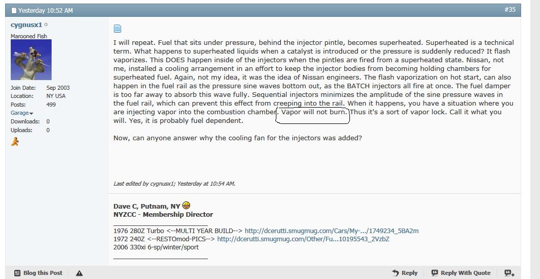

July 29, 201113 yr comment_362714 Of course vapor burns, but fuel pumps are not good at pumping vapor, and injectors flowing vapor bubbles into the intake cannot deliver enough molecules of fuel to ignite the charge properly. Did I say vapor doesn't burn? I said it would require different conditions. What I referring to was concentration. Edited July 29, 201113 yr by cygnusx1 Link to comment https://www.classiczcars.com/forums/topic/40289-vapor-lock-questions-for-the-hotter-climate-guys/?&page=6#findComment-362714 Share on other sites More sharing options...

July 29, 201113 yr comment_362726 Of course vapor burns, but fuel pumps are not good at pumping vapor, and injectors flowing vapor bubbles into the intake cannot deliver enough molecules of fuel to ignite the charge properly. Did I say vapor doesn't burn? I said it would require different conditions. What I referring to was concentration. Yes, you did say vapor doesn't burn and there was no mention of concentration or any other qualifier. Link to comment https://www.classiczcars.com/forums/topic/40289-vapor-lock-questions-for-the-hotter-climate-guys/?&page=6#findComment-362726 Share on other sites More sharing options...
