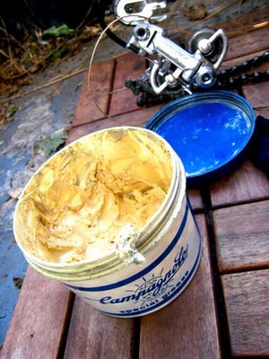

However, the stuff that comes in tubs does not seem to dry out at all. I have a tub from the '80's that I used to pack bottom bracket and wheel bearings on my old Marinoni racing bike and none of the grease on the inside or on the outside has dried.
White lithium grease has been used for many years in bike bearings. Maybe the formula for additives varies or maybe it is not good in heated applications because the additives may boil off. I have even seen it in the boots of wheel cylinders w/o problems so that goes against my guess.
