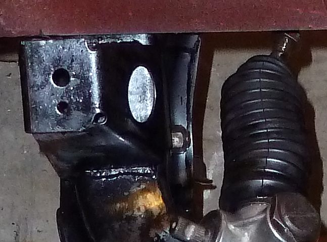

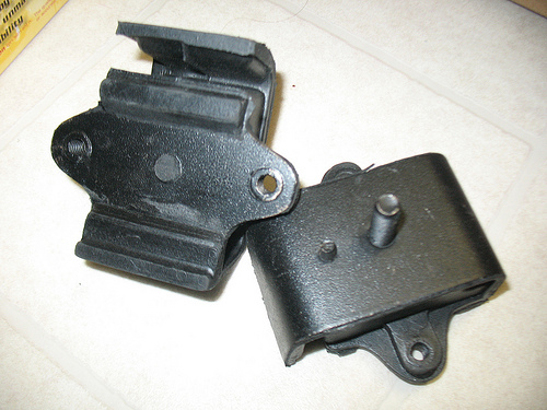

Posted July 25, 201113 yr comment_362417 Hmmmm the alignment pin below the bolt does not align with the holes in the front cross member. The pins are ~3mm too low. The catalog says 62-600 [70-83] and the car is a '71 so I don't understand. Before I slot the existing holes any insight? Edited July 25, 201113 yr by Blue Link to comment https://www.classiczcars.com/forums/topic/40307-black-dragon-engine-mounts-dont-fit/ Share on other sites More sharing options...
July 25, 201113 yr comment_362455 this may be a silly question but are they on the wrong sides by chance? stuff like this has slipped me up before. Link to comment https://www.classiczcars.com/forums/topic/40307-black-dragon-engine-mounts-dont-fit/#findComment-362455 Share on other sites More sharing options...
July 25, 201113 yr Author comment_362456 Thanks. I tried both parts on both sides...same problem. Same part numbers in catalogue and on the box they came in. The Nissan mating plates are left and right for anyone reading this thread in the future. Link to comment https://www.classiczcars.com/forums/topic/40307-black-dragon-engine-mounts-dont-fit/#findComment-362456 Share on other sites More sharing options...
July 25, 201113 yr comment_362467 i cant tell from the picture, but is the pin notched on that one mount? Link to comment https://www.classiczcars.com/forums/topic/40307-black-dragon-engine-mounts-dont-fit/#findComment-362467 Share on other sites More sharing options...
July 26, 201113 yr Author comment_362484 Each shock-mount has a pin and a bolt, each corresponding structure on the cross-member has a hole for the bolt and a hole for the pin. The problem is the pin in the shock-mount does not align with the hole, it is a few mm too far away from the bolt. Link to comment https://www.classiczcars.com/forums/topic/40307-black-dragon-engine-mounts-dont-fit/#findComment-362484 Share on other sites More sharing options...

July 28, 201113 yr Author comment_362622 I ended up filing the pins back ~ 2mm and it worked fine. The parts were from Black Dragon and the origin is India. Link to comment https://www.classiczcars.com/forums/topic/40307-black-dragon-engine-mounts-dont-fit/#findComment-362622 Share on other sites More sharing options...
