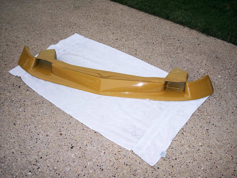

July 27, 201113 yr comment_362612 This is my BRE Mk 1 or Series 1 Spook that was already installed by the dealer when I bought my car 03/31/71. It has been fully re-habbed and will be back on the car soon. . It was the first design from BRE and used in 1970 competition only, to the best of my knowledge. Check the BRE archive pictures (link below) to see the 1970 car and the change on their 1971 cars to the design more commonly associated with the early BRE Spook. I suspect the first design did not provide adequate downforce, hence the redesign for 1971. http://www.bre2.net/mm5/merchant.mvc?Screen=CTGY&Store_Code=B&Category_Code=brearchivephotos240zs Jim Link to comment https://www.classiczcars.com/forums/topic/40326-spoiler-or-air-dam/#findComment-362612 Share on other sites More sharing options...
