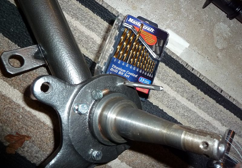

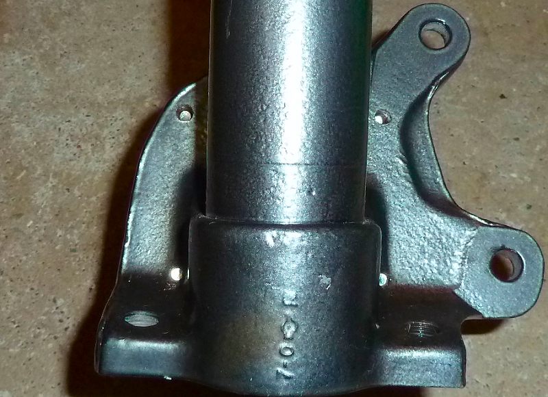

I disassembled my front struts and spindles tonight. In the near future I plan on going with the Toyota 4x4 front calipers. Getting the backing plate phillips screws out was tough on 2 out of the 4 and 1 of those required a bit of heat to work loose. I sort of f'ed up the screws getting them out. Could I just go without the backing plates? Is there a safety issue with this? I don't plan on every driving the car in the rain, unless I get caught out. Thoughts?
I drilled mine out and re-tapped for M6 X 1mm stainless steel bolts.
You can easily drill them out from the back side as the holes guide your bit and also hold the cutting fluid nicely.
