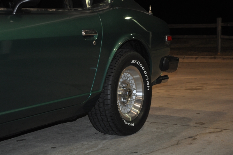

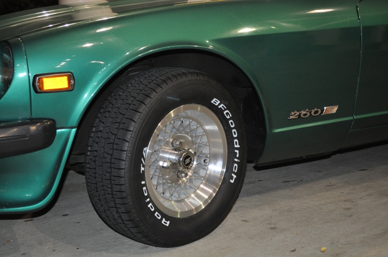

August 12, 201113 yr comment_363837 So I just recently went through a similar exercise as you on tires / wheels / sizes, etc.My old tires were shot and really needed to be replaced. They were mounted on original Appliance 14 inch mesh wheels (that I purchased in 1975 or so) and were 215 -60 R14. I went through a lot of back and forth on whether to upgrade the wheels, which would give me an almost infinite choice on tire sizes / brands / etc, or to stick with the Appliances and try to keep the car as period correct as possible. In the end I decided to stick with the Appliance wheels and live with the very limited choice on tires. Link to comment https://www.classiczcars.com/forums/topic/40447-wheel-identification-tire-size/?&page=2#findComment-363837 Share on other sites More sharing options...
August 12, 201113 yr comment_363839 Not sure what I did in my last post. Posted before I was finished. On tires, I decided that I wanted to go a little larger in size and have as much rubber on the road as possible. I was also very concerned about rubbing, etc with larger tires than what I was going to replace. I ended up going with BF Goodirch Radial TA. 225-60 R14. Actually had a very hard time finding anyone that had them in stock. Ended up finding an online dealer I had never heard of before (tirecrawler.com) who claimed to have them in stock and also had the best prices. Came through on everything and I had them in less than 3 days. Had them mounted on the refurbished Appliances (subject of another thread) and so far they have been great. No clearance issues at all and I really like the ride and feel of the larger tire. I'm also amazed at the improvement in handling and overall drivability of the car. It's been so long since these have been changed, I guess I forgot how mch of a difference new tires can make. Finally, I was also concerned about the width of my old rims (6 inches) and whether they would work with the 225-60 R14's. I went to the BF Goodrich site and looked up the tires that I wanted and they provided all of the specs including minimum / maximum rim size. Here's the link for the tires I selected: http://www.bfgoodrichtires.com/tire-selector/size/PMetric/225/60/14/OE/BNW/radial-t-a/tire-details I've attached a few pictures of my car so you can see clearance, old / new tire differences, etc. Mike. Link to comment https://www.classiczcars.com/forums/topic/40447-wheel-identification-tire-size/?&page=2#findComment-363839 Share on other sites More sharing options...
