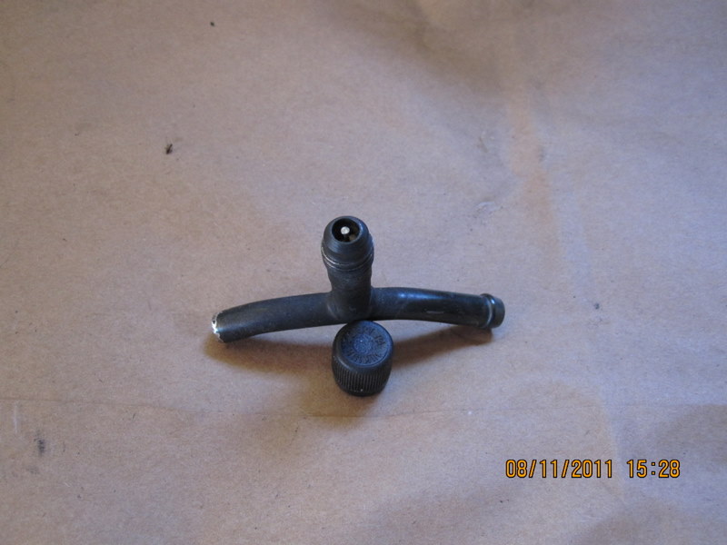

I was in the salvage yard the other day and found an in-line Schrader valve on the fuel lines of an Isuzu Rodeo. I've looked around on the internet for something similar but could never find anything. The Schrader valve is common on today's fuel injected cars, as a port for a fuel pressure gauge connection, but the old Z cars don't come with them. All of the newer cars I looked at have them installed on the fuel rail so not easy to transplant.
I haven't installed it yet but it fits 5/16" hose like the stock 280Z lines so should be easy to splice in. It will be convenient for fuel pressure checks or adjusting, and for relieving pressure if I need to remove any fuel system components.
I've attached a picture of what I ended up with. On the Rodeo there is more hard line after the cut but also several fixtures and bends that I didn't want. If someone knows of a similar in-line valve on a different model car, I'd be interested to know of it.
Putting this out there for those that might want to add something convenient to their car for no significant reason.
