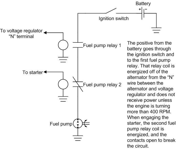

As for operation, the power to the electric fuel pump is interrupted by a relay when starting the car. I have attached a simplified drawing of the circuit. The mechanical pump is operated by the camshaft.
