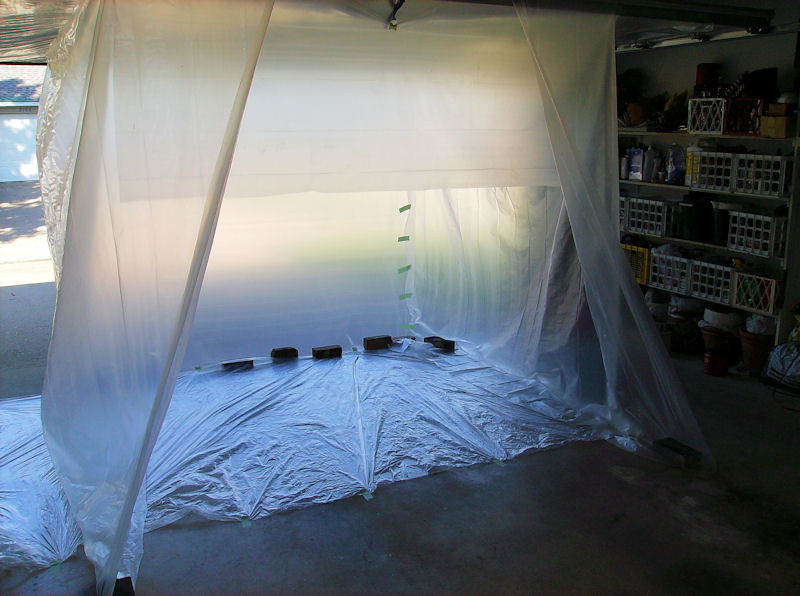

Posted August 14, 201113 yr comment_364056 I am in the process of of hanging plastic before i paint the underside. I dont have a painting booth so im hanging up plastic, it will work for what im doing for now. Link to comment https://www.classiczcars.com/forums/topic/40487-hanging-plastic/ Share on other sites More sharing options...

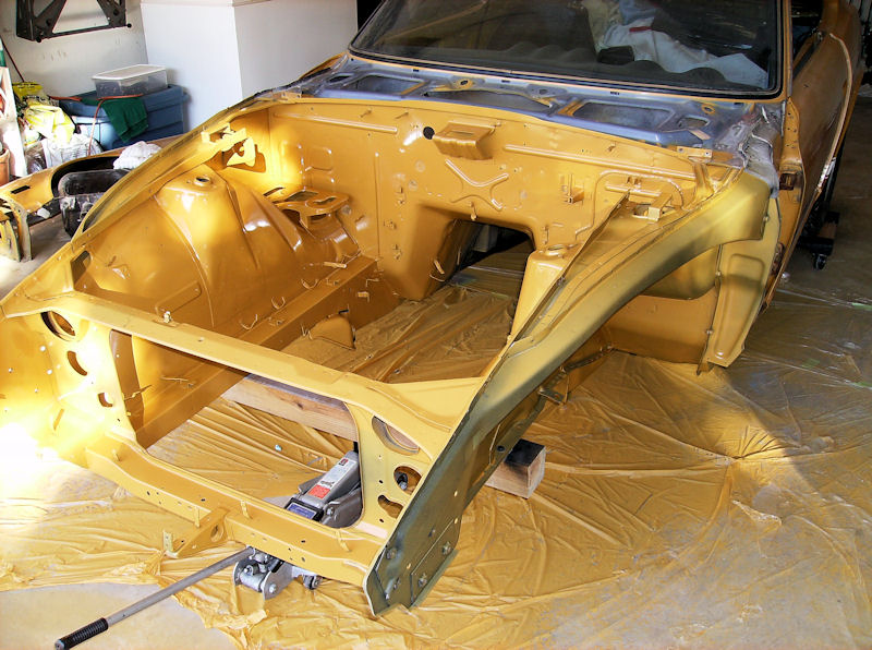

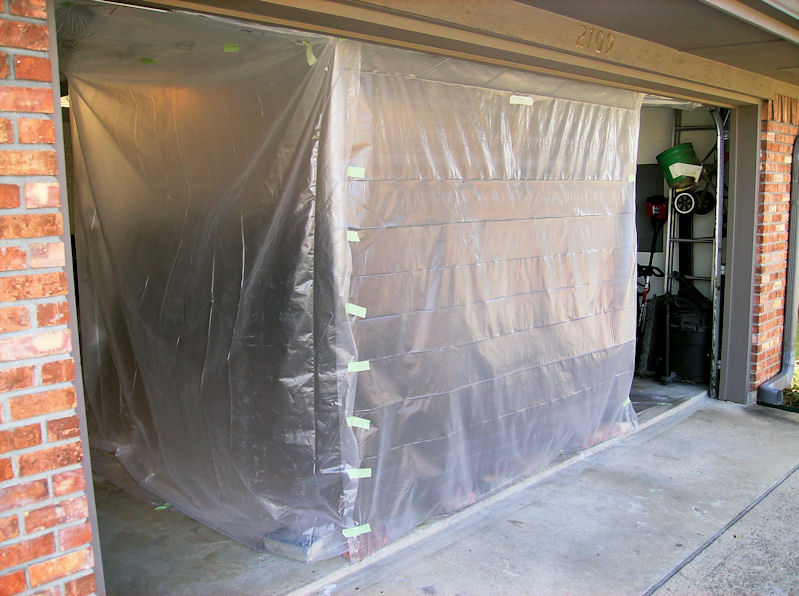

August 15, 201113 yr comment_364064 Been there, done that. +1 on all of Steve's great advice. Don't overlook eye protection - some disposable goggles is a must. Get a paper overall from somewhere such as Harbor Freight - with care you can use it a few times. This is the temporary booth I built to do my engine bay. A bit longer and I could have enclosed the entire car. Jim Link to comment https://www.classiczcars.com/forums/topic/40487-hanging-plastic/#findComment-364064 Share on other sites More sharing options...
