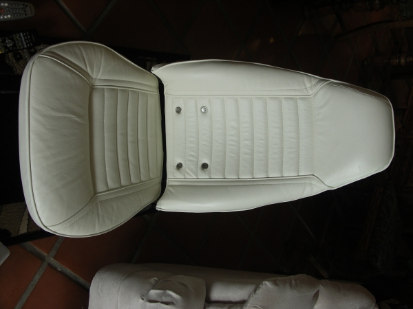

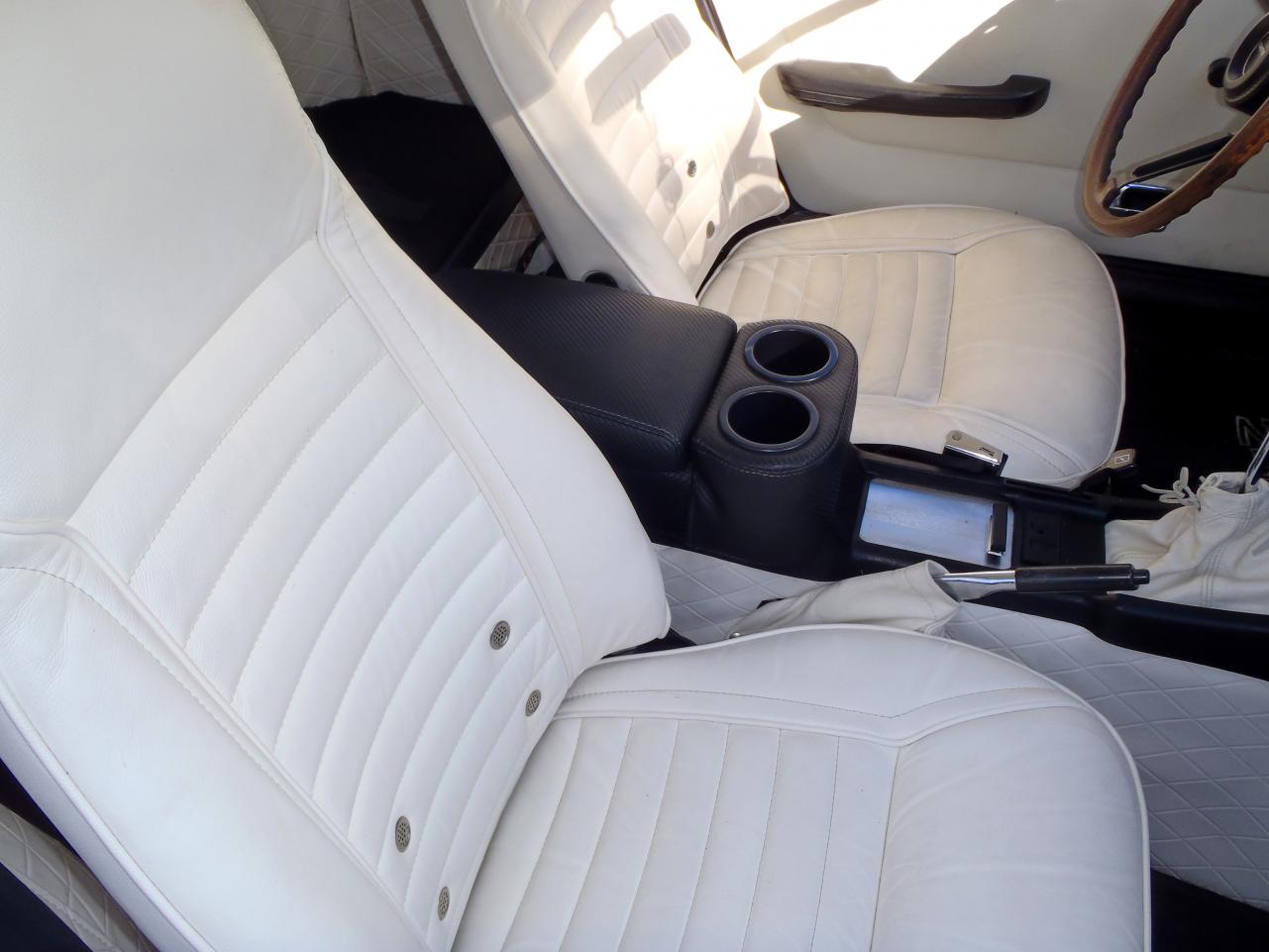

I used the CDM foam and leather covers, in white. They were a very tight fit, I mean tight. Had to shave the foam a bit, even. I decided to do that after I measured and compared the dimensions of the originals with the CDM ones. The CDM was definitive smaller. They are a combination of leather seating surface and vinyl back. Heating vinyl makes it stretch, but heating leather makes it shrink, so you can't use the old warm them up first trick. They also aren't wearing well for me. The outboard edge of the drivers seat back outside bolster is already worn from my sliding in/out of it, so I have to be really gentle when I enter/exit the car. They sure look good, though, when they are clean. White leather is hard to keep clean, did I mention that? post-17507-14150816147351_thumb.jpg
