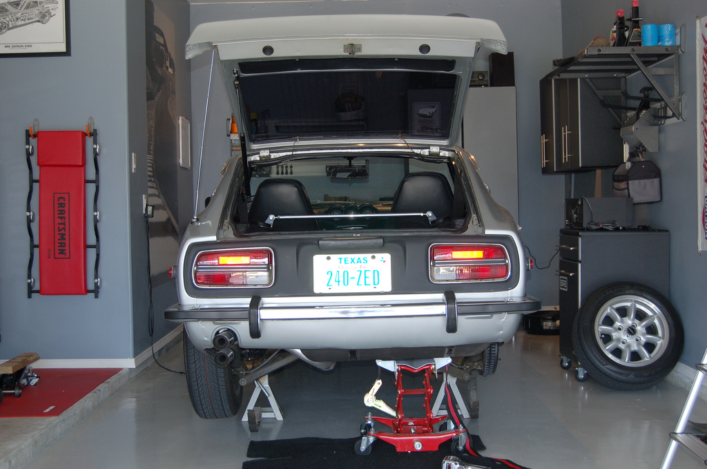

September 12, 201113 yr Author comment_366231 This was the start of the adventure, Car up on jacks, radio going and I was prepared for anything. Well at least I told myself I was anyway. Next step was to get fuel sensor wires unhooked and remove the fuel-out and fuel-in lines that are located right next to the tank sensor. This was a piece of cake. Next I loosened the filler hose after removing the access door. That is when I noticed that my tank under the filler hose is bone dry. And has been for a long time. Also I noticed the filler neck is extremely soft and pliable. I think I may be in good shape there. But I did notice something on my small fuel out line to the fuel pump. More on that later. Next I got out my tranny jack and positioned it under the tank. This allowed me to remove the straps and slowly lower the tank so I could get to the rest of the hoses. That is where I had my first surprise. Three of the lines were blocked off. So that made think I should get to the inside of the car now to see what is or is not there. I removed the inner black plastic to reveal the filler neck. What is missing form this picture! Well this is when I decided to just halt all inside the car work and then take a look at the tank. So I had to drop it now. Well now that it was lowered a bit, the other hoses came off in a pinch, and the tank was quickly all the way down.. I rolled it out and took a look. Notice the plugged lines. Boooooooooo This the culprit of my gas smell I think. The smaller diameter tube coming out of the tank was noticeably moist. When I was removing the hose that was clamped to it, the tube actually rotated on the tank. Not good. I am relatively sure this is cause of my bad smell. But we will have to see. now I have already ordered the lines Arne suggested to order for this job, but I will need to source an evaporator tank first. Question is, is it worth all the trouble. For originality, I feel compelled to do this. But all the hose grommets in the car would need to be replaced as well. So I have some soul searching to do while I figure out what do to with the tank. The inside looks really good actually. On a few small rust circles on the bottom and the rest is relatively spotless. But I will need that filler tube fixed. A new reconditioned tank from www.zcarsource.com is 400 bucks when you factor in shipping. I figured I can get this tank boiled out and fixed for less than that. More to come. Link to comment https://www.classiczcars.com/forums/topic/40670-strong-fuel-smell-in-the-car-when-i-turn-left/?&page=3#findComment-366231 Share on other sites More sharing options...
September 12, 201113 yr comment_366237 A radiator shop can re-braze that fitting. So the evaporator tank shunts fuel vapors to the crankcase?! Yeah, I guess raw fuel erping into the crankcase could be a problem! Yikes! Zedyone, your garage is simply beautiful! Link to comment https://www.classiczcars.com/forums/topic/40670-strong-fuel-smell-in-the-car-when-i-turn-left/?&page=3#findComment-366237 Share on other sites More sharing options...
September 12, 201113 yr comment_366239 Zedy, I must protest! Your garage is entirely too neat and clean!! It is even color coordinated!! You would die if you saw mine! I think you need a neon beer light. Link to comment https://www.classiczcars.com/forums/topic/40670-strong-fuel-smell-in-the-car-when-i-turn-left/?&page=3#findComment-366239 Share on other sites More sharing options...
September 12, 201113 yr Author comment_366240 Thanks so much! It has been quite a bit of work getting it there...Well, I know the line going back to the crankcase is plugged right now. Noticed that last night. So I would have to reconnect that if I decide to re-install the Evap tank. I am having a hard time justifying the expense versus payback right now. Seems to be Zero advantage to reinstalling the evap tank and the cost is not trivial. So how original do I want to be? Hummmmm Link to comment https://www.classiczcars.com/forums/topic/40670-strong-fuel-smell-in-the-car-when-i-turn-left/?&page=3#findComment-366240 Share on other sites More sharing options...
