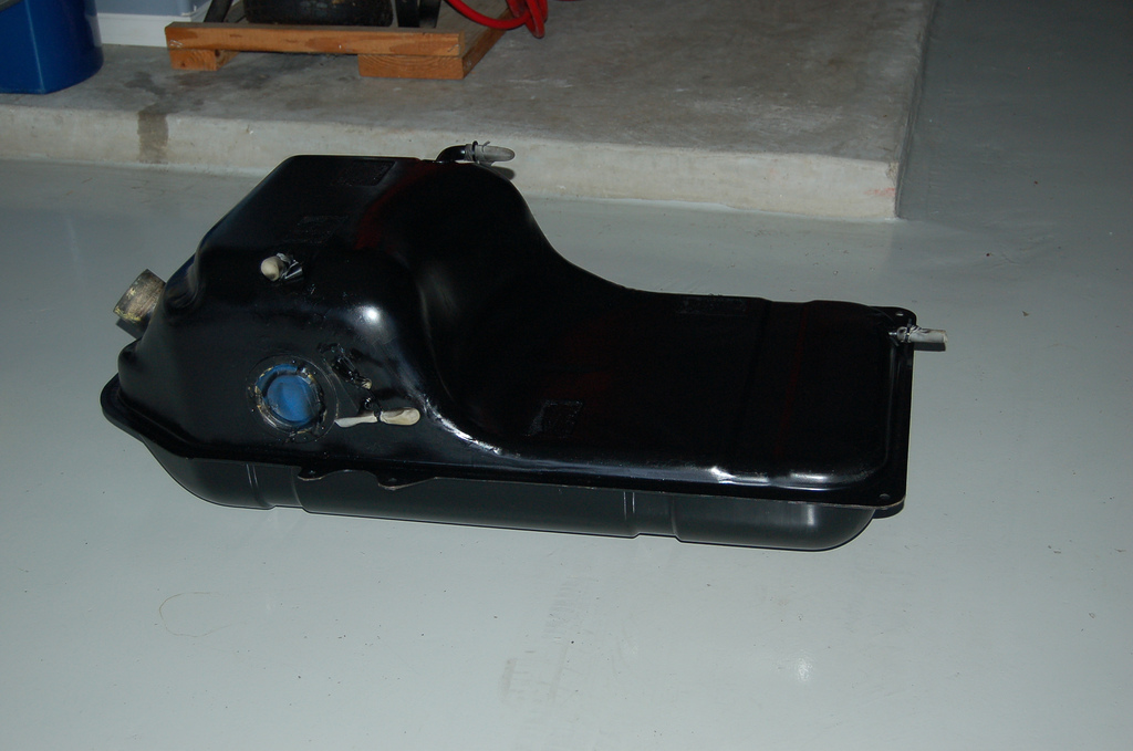

I finished up on the tank yesterday. I decided to go with some chassis black spray paint over the POR. THe original tank only had spray paint on it and it lasted 41 years with little to no rust. I used VHT high temp Chassis black. I have good luck with VHT on things that I want more durable than just plain spray paint.
I found out that latex glove fingers make for great fuel line plugs.
Next step is to find some rubber for my straps. AND some rubber for my tank pads. AND some 3/4" fuel line.
For the rubber, make your own by going to a tire shop and ask for a non-useable truck tire inner tube, you cut to fit, straps & pads, glue down with weatherstrip adhesive. I've made lots of things out of that free tube. I also found the 3/4 & 5/8 fuel line at my local John Deere dealership.

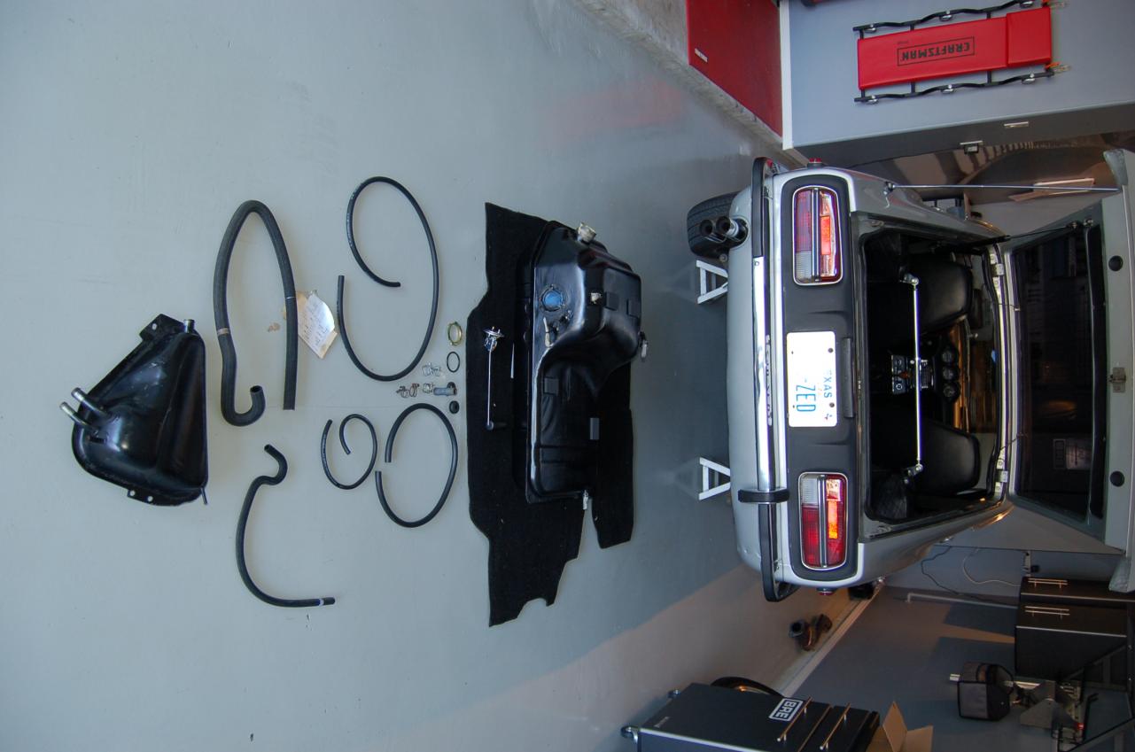

Well this is where we are at. What you do not see are the straps that have been sanded smooth and repainted black. Also missing is some 1/4" fuel line which I totally forfot to pick up. That is on the agenda for tomorrow. Also had to source some bolts for the evap tank. M5-.8 I think is what I got. They fit wonderfully. Since it was a welded in place nutplate in the wheel well, no need for any nuts.
Hoping this will all go together okay. I will spend some cleaning up the OEM hose clamps as best I can. They tend to be much happier after a spray with some WD-40.
More to come as I get this thing assembled. I am thinking I may put in my RT diff mount while I am here though. I just PORed that and bought a bump stop for the install.

Okay, what the hell was Datsun thinking making me try to track down EVERY single size fuel line in existence!!! GEEEZE!
Trying to find a 3/4" fuel line is darn near impossible. I finally found some at an ACE hardware supply store, it was fuel transfer hose
and I had to buy 10 FEET of the stuff, so if anybody wants some let me know!
Also, fitting the grommets in firewall trunk wall is a pain in arse! HA HA, but it is finally sealed up tight. The things we do for orignality!
