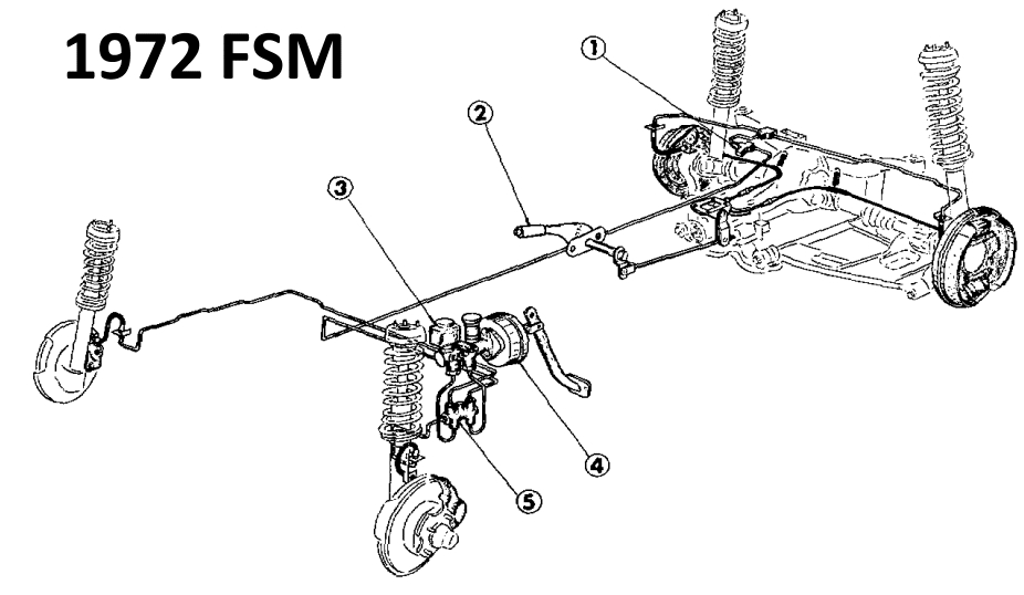

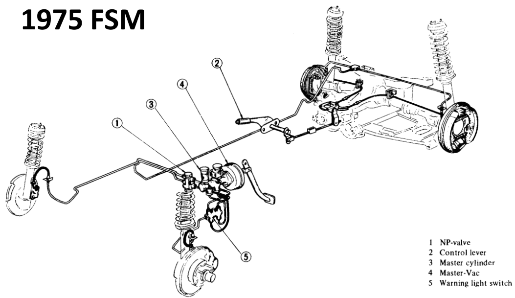

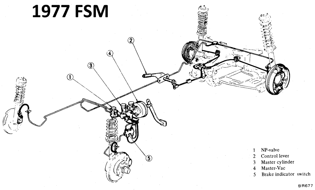

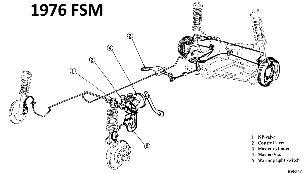

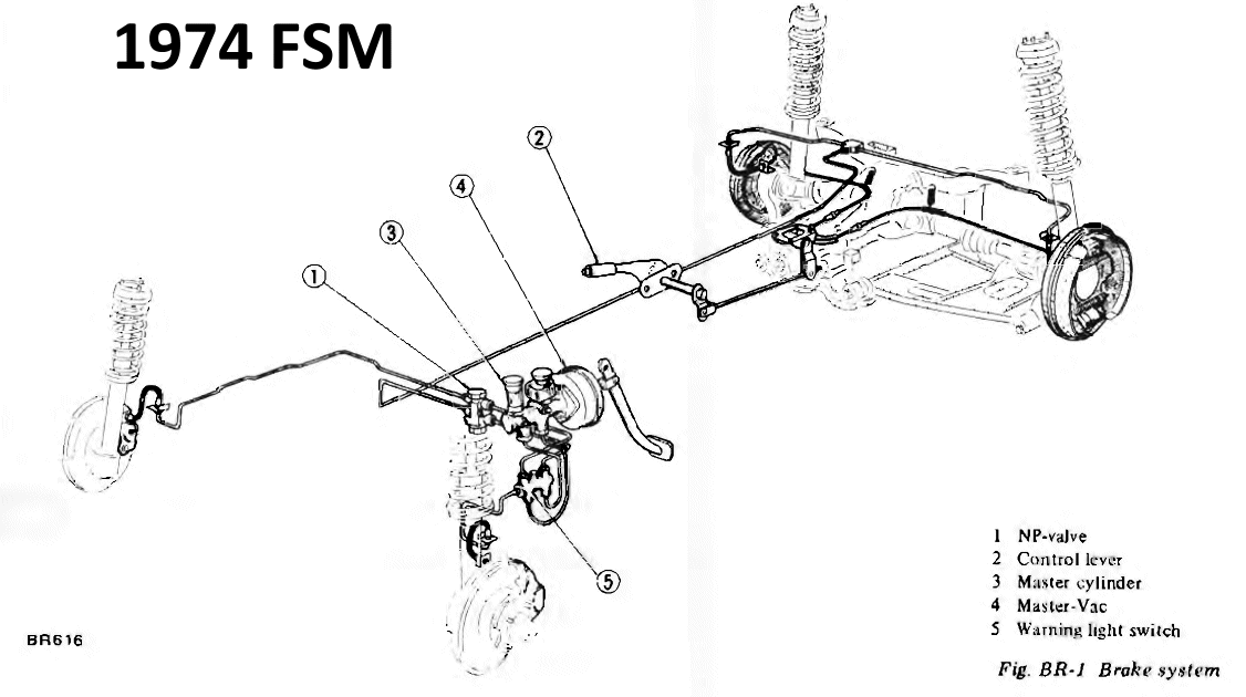

No, unfortunately they are not.
Early Z's have proportioning valve in back integrated into a T junction, later have it in front as a separate device on the fire wall. The distances to the differential pressure switch may have also switched with brake master and booster changes over the years.
