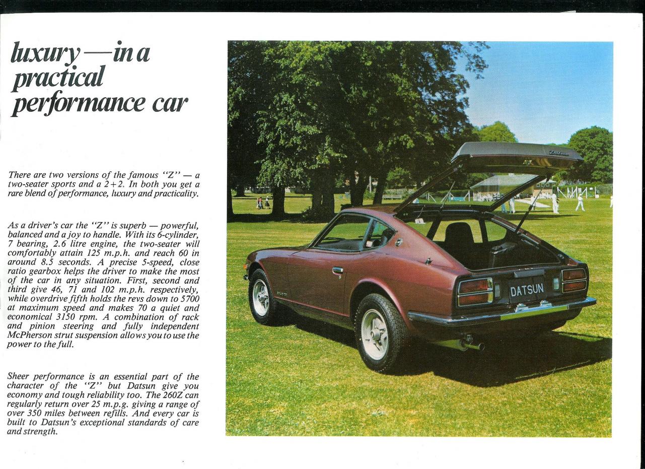

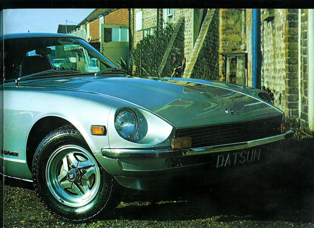

My car, a UK model (late 1977 260Z as in the brochure images), has rubber plugs fitted to the front overrider holes (Nissan P/N 62689-21000 will fit). At the rear, the wrap-around bumper rubbers simply extend over the overrider holes (see images from a couple of UK brochures).
Why couldn't they put the blinkers under the bumper like we have them in the US. It just looks weird with the cutout for the blinkers and nothing there.
In euro models those little marker lights were blinkers. We were (i think it's general rule in europe) not allowed to have amber lights illuminating all the time on the side of the car. That's why we dont have the rear (red) marker light either.
