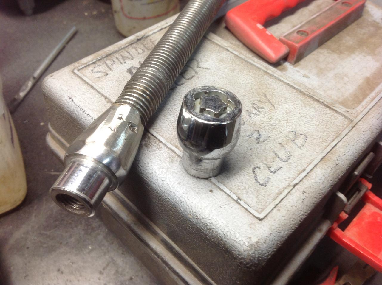

Like many of you, each time this thread or similar comes up, I start dreaming of better ways of designing this tool.
One of the challenges of building them is getting the 12x1.25 threads "created" in the end of threaded rod. Certainly in my experience, the strength of these threads is critical as I have pulled a few threaded inserts out and stripped some threads that where directly cut into the end of the rod. Getting machinest's involved is often costly.
So I started thinking about alternative sources of pre-existing hardened good quality female threads of this dimension. One that come to mind is our wheel nuts. There are certainly lots of wheel nuts out there, but which ones might have the properties we desire? Hard, lots of thread depth at least.
So looked through my predictable assortment of wheel nuts and found a set of old wheel locks. No idea which brand, but I think that due to the security aspect, these are likely pretty hard.
Now the hard part of this approach for the average home mechanic is attaching a wheel nut to the end of the threaded rod. Welding is the most obvious approach.
Lucky me, the old miller MIG in the corner is called to service, and voila I have new hard long threads to use on the next pin I have to pull. I'll report back on the success likely sooner than later. And I have three more to use if this breaks or to make 3 more!
Not sure if the cost of set of good quality locks plus the cost of a welder to do this if you don't have access is actually any cheaper or better than the internal threading/machinist approach, but this is just another alternative to this never ending challenge.
