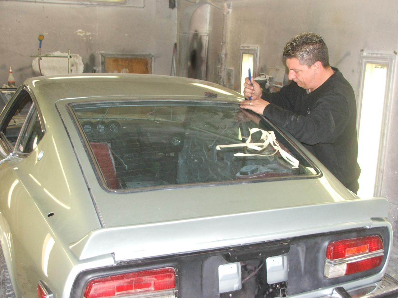

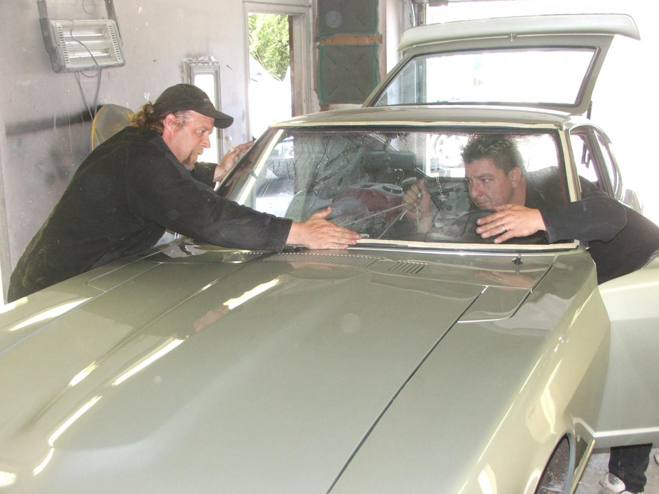

September 25, 201113 yr comment_367316 Blue - I recently had my original windshield and hatch glass re-installed by a pro who was well familiar with Z cars. Up front, he said he planned to use no sealants, only a generous use of soapy water to lube the gaskets into place. The gaskets I supplied were the PRP items sold by Black Dragon and others.FWIW.Jim Link to comment https://www.classiczcars.com/forums/topic/40882-sealant-for-weather-stripping-around-windows-where-does-it-go/#findComment-367316 Share on other sites More sharing options...
September 25, 201113 yr comment_367336 Ditto installed windshield and rear deck glass.No sealant and no leaks.Black Dragon seal kit.The front windshield was sealed in place from the factory and was a b+<%h to get the windshield out with out breaking it.Rear deck had no sealer and just pushed out. Casey Edited September 25, 201113 yr by Casey_z Link to comment https://www.classiczcars.com/forums/topic/40882-sealant-for-weather-stripping-around-windows-where-does-it-go/#findComment-367336 Share on other sites More sharing options...
