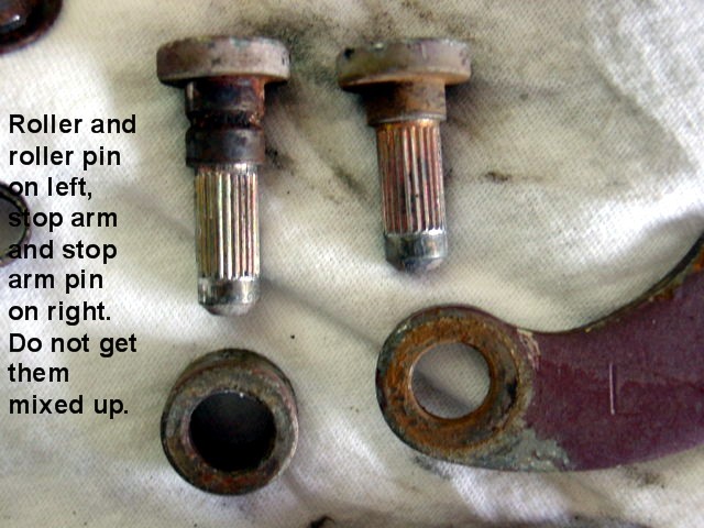

I got the flanged bushings at the local hardware store. I measured the roller pin on the hinge for the I.D. of the bushing, then got two so they nested together to make a big roller, which wasn't the correct diameter, but it works. I glued them together and greased the roller pin and got the improvised roller on. Don't make it a tight fit that you need to use a hammer to get it on. It's supposed to roll!
To install the roller, I used a big regular screwdriver (or a long pry bar) to push on the detent arm/spring so you can just put the roller on the pin.
I used the flanged bushing so it wouldn't pop off like the original one did.

That I'm not sure about, my car is completely apart so i had the hinges on a work bench and with a vise replaced all the bushings and the main pin. the oe roller pin I reused as it was not worn. You may be able to tap it out if you can get a good solid hit with a drift and a hammer. If not Id recommend supporting the door really well and repair each hinge one at a time . I remember that they were in there pretty snug.
These are parts for rebuilding the door hinge. This Pin will not work with the roller. Try to reuse the Roller Pin that is on the car.
Nissan Pin Bushings part# 80410-01G00
Nissan Pins part# 80406-V5002
Or
Advanced Auto, the bushing and pin is Dorman part # 38397
www.mcmaster.com Part# 8491A202 - the roller
Image of Roller Pin and Stop Arm Pin:
