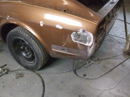

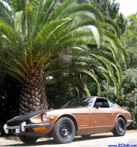

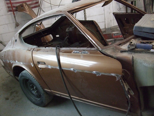

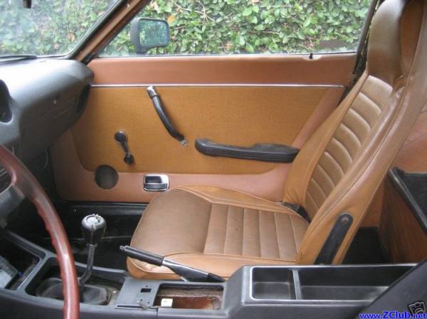

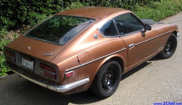

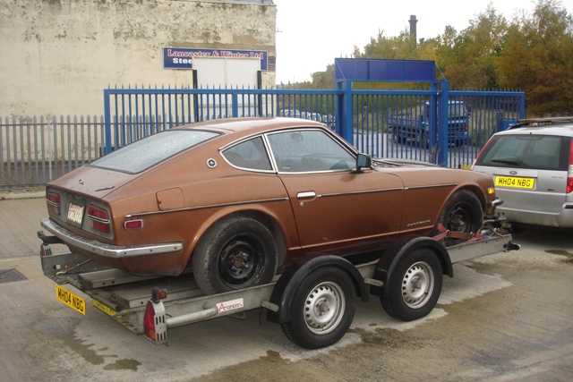

Posted October 6, 201113 yr comment_368335 hello everyone, all being well my 'fairlady' project should be ready early next year,so i thought i'd share my progress with some pictures and comments. i hope its of interest. It all started with the dreaded e bay (addictive to say the least). Quite a rare occurance when a californian 73 240z is listed on uk e bay site, when the car was still state side. What attracted me the most was the seller was a trader who's shipping costs quoted was 'very' reasonable, especially at that time the exchange rate was two dollars to a pound. I requested the usual extra pics of rust prone areas, which were provided in abudance. It still was a massive gamble to bid,but bid i did and i was the only one who did. 10 weeks later the car landed at the docks in the u.k. Luckily it was a gem, as was the seller (Mark Mitchell aka Motorama). A true gent. No rust, never been welded/repaired and complete. As described a genuine dry state car. By the way the pics are from the e bay ad, palm trees like that in the u.k, don't think so!! I have tons more pics/progress and lots to tell, but work beckons so i'll post more later. Edited October 6, 201113 yr by rahail240 pics Link to comment https://www.classiczcars.com/forums/topic/40986-the-journey-of-my-fairlady/ Share on other sites More sharing options...

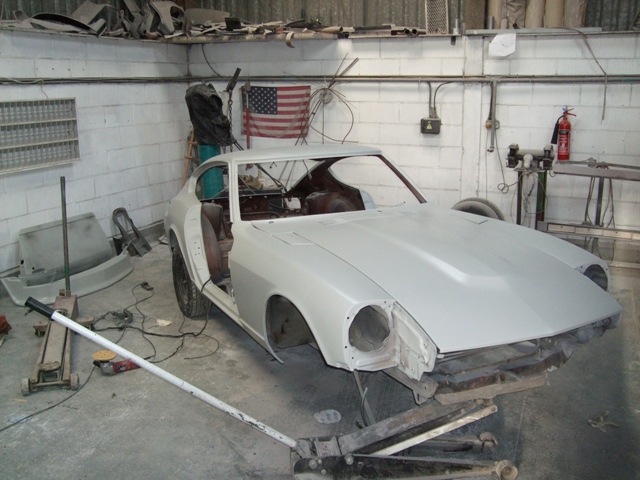

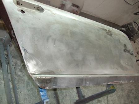

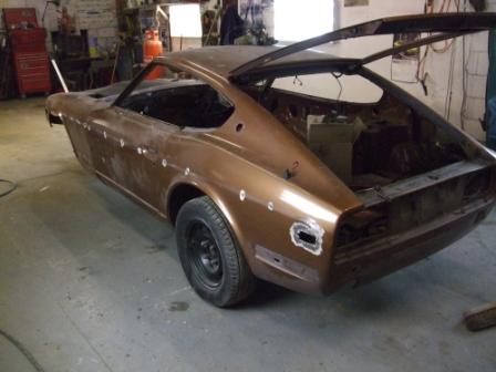

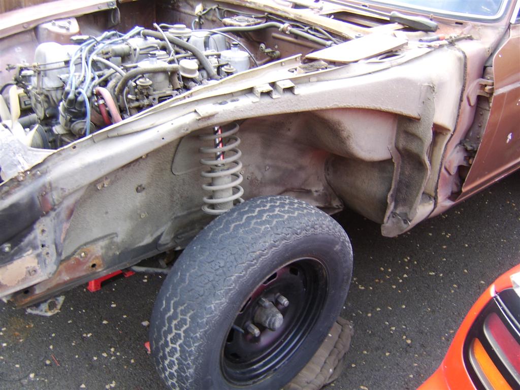

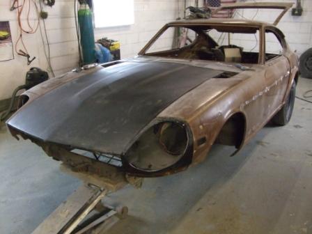

October 6, 201113 yr Author comment_368386 a few months later and a plan in hand she's of to be stripped ready for the next outing. the body shop. Link to comment https://www.classiczcars.com/forums/topic/40986-the-journey-of-my-fairlady/#findComment-368386 Share on other sites More sharing options...

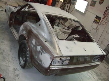

October 6, 201113 yr Author comment_368395 ok, after an age i finally decided on the colour. a slightly lighter shade of old english white. It would have been nice to choose the o.e 904 white, but frankly it's a bit washing machine white for my liking. Don't be fooled by the flag on the wall, we are still in the u.k. Gary, the painter, is well into his u.s trucks and muscle cars. Link to comment https://www.classiczcars.com/forums/topic/40986-the-journey-of-my-fairlady/#findComment-368395 Share on other sites More sharing options...

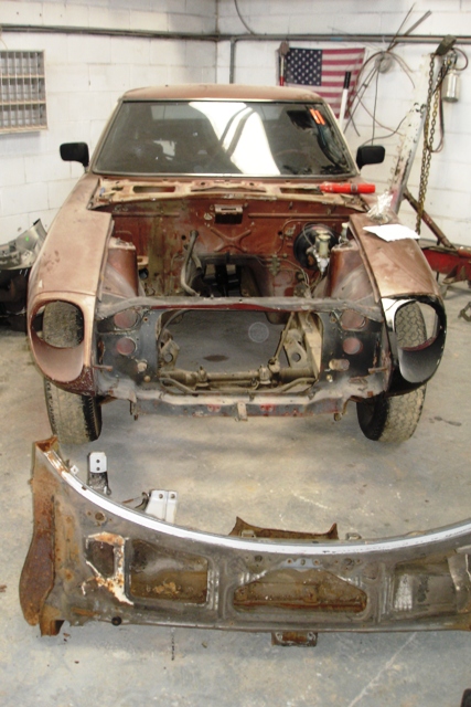

October 6, 201113 yr Author comment_368404 no front valance as i was going to fit a spoiler/airdam.but it's now decided to be fitted back with o.e factory front end. Link to comment https://www.classiczcars.com/forums/topic/40986-the-journey-of-my-fairlady/#findComment-368404 Share on other sites More sharing options...
