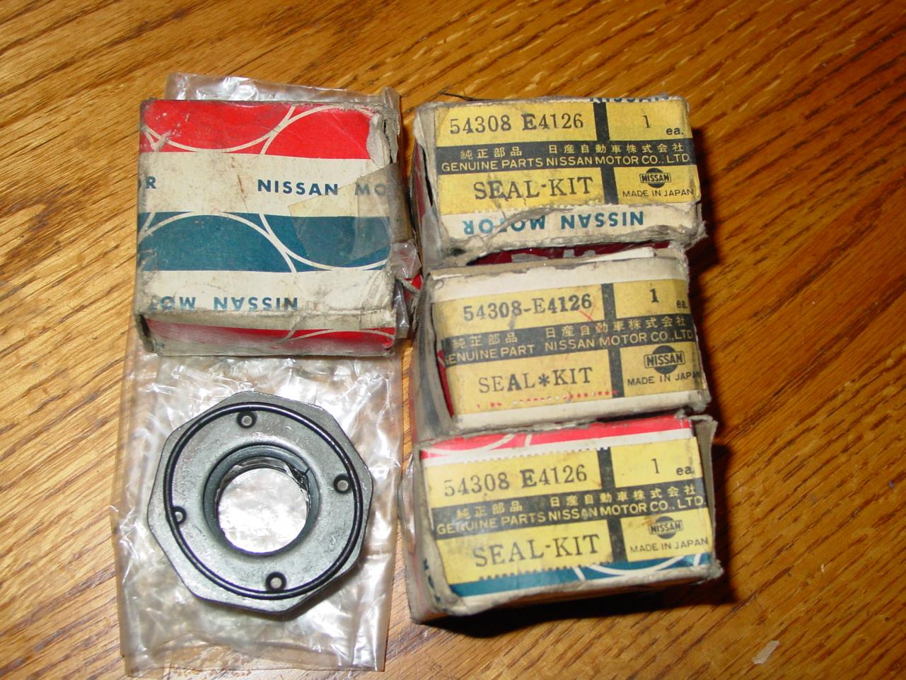

November 25, 201212 yr comment_407594 Hi Dan, I wish I had seen your post earlier. I've had an NOS set of 4 seals for a few years now that I've never used (see pic below). However, after reading through this thread, I might just hold on to them in case I need to replace my inserts someday. Hearing that the stock inserts are not too soft and not too stiff, if I can find a complete set of 4 NOS stock inserts (and dust covers) for my '71, I may just have them installed along with my 4 seal kits when the time comes. As difficult as it is to find the NOS inserts, I guess I better start looking pretty soon. Link to comment https://www.classiczcars.com/forums/topic/40995-looking-for-original-240z-strut-seal-kits-nuts/?&page=2#findComment-407594 Share on other sites More sharing options...
